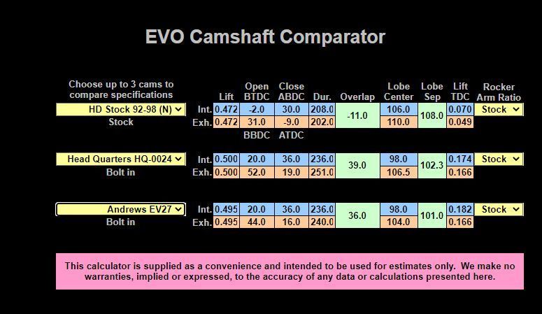

I have my 97 Ultra in the shop getting a new cam. We were planning on an EV27 but when he opened it up there is a Head Quarters HQ-0024 rumble stick already in it. Will I notice a difference putting in the EV27 or should I leave the HQ-0024 in it? I was planning on a cam because the bike seems kinda doggish even with air cleaner/pipes. My 89 Softail has an EV46 and would run right over this bike. I know there's a big weight difference and I'm not expecting the Ultra to compete, just looking to wake it up. Thoughts?

Looking at the numbers the HQ and EV27 have the same intake valve closing which controls cylinder pressure so no help there, your only going to a get slight slight performance gain from the EV27 exhaust valve closing earlier creating a little bit more cylinder fill from the exhaust valve closing earlier. With stock compression the engine will still be sluggish 2000-2500 and hit around 3500, if you jump the compression up both those cams come to life. EV13 works better with stock compression due to earlier intake valve timing (more cylinder pressure) and less duration but will fall off @ 5000 or less
