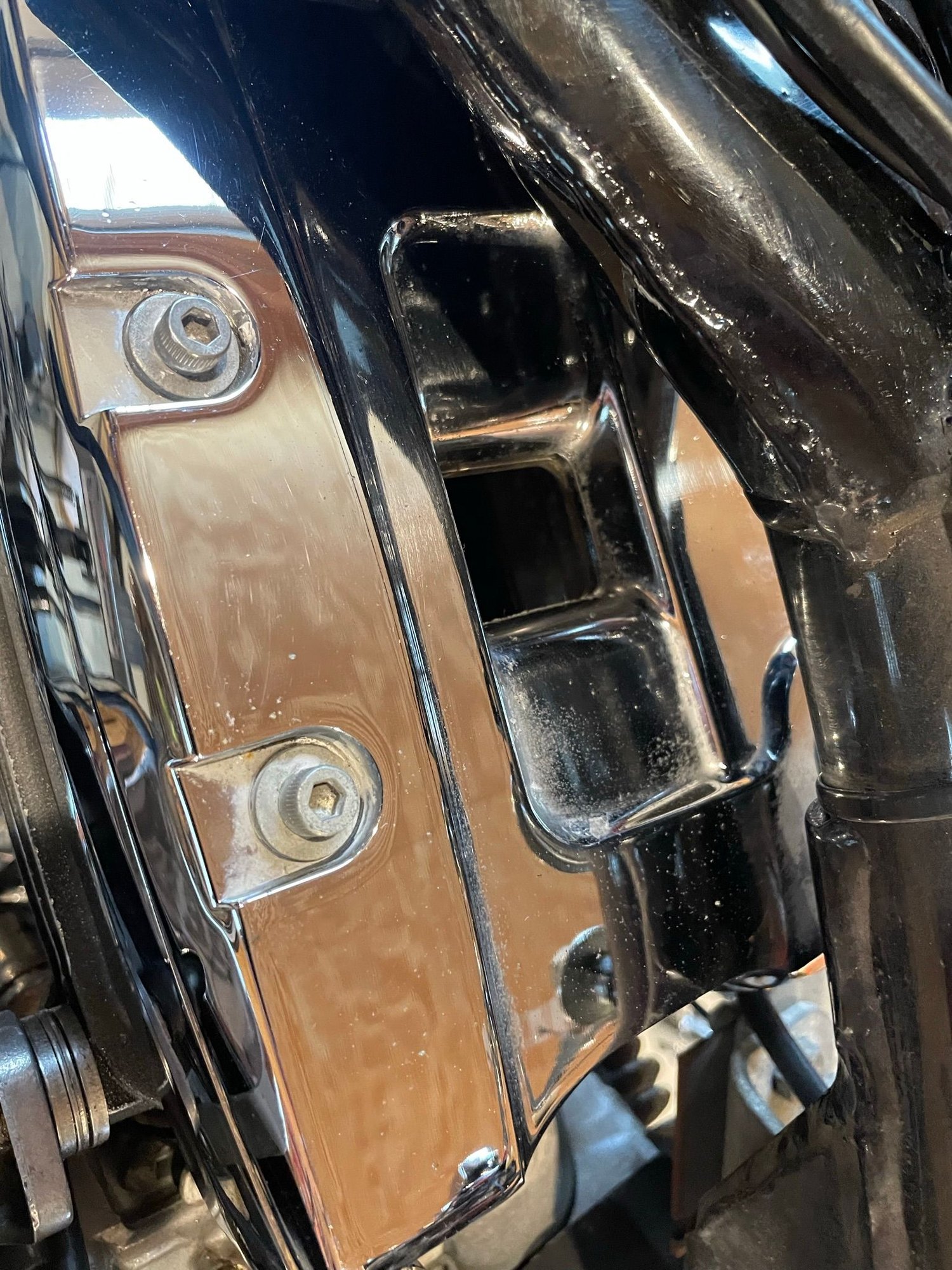

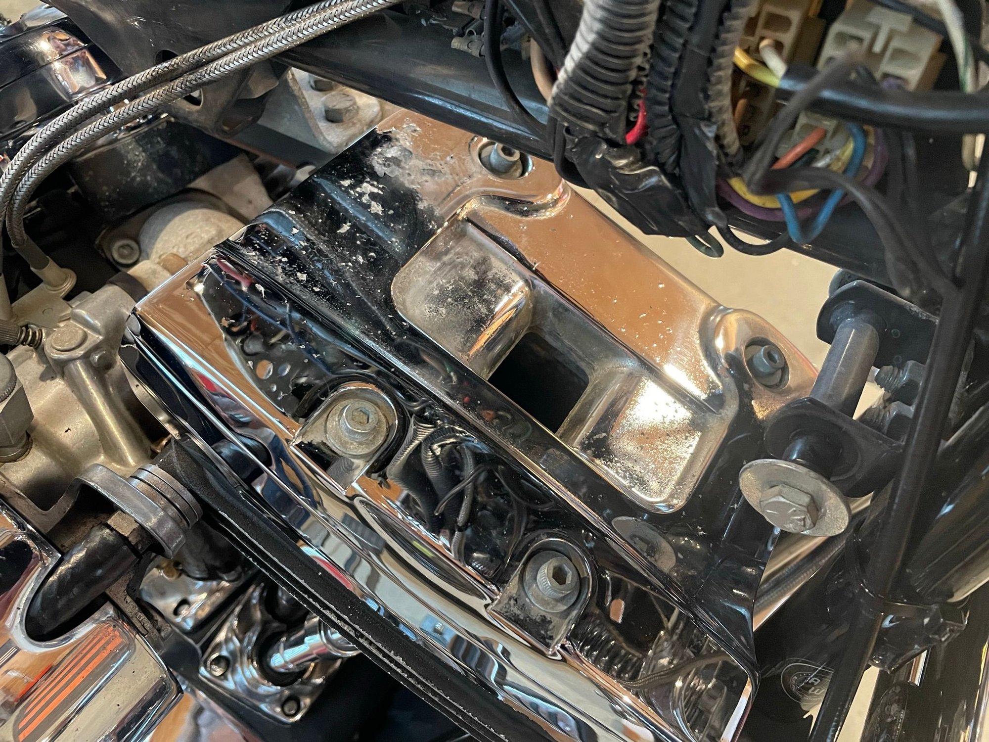

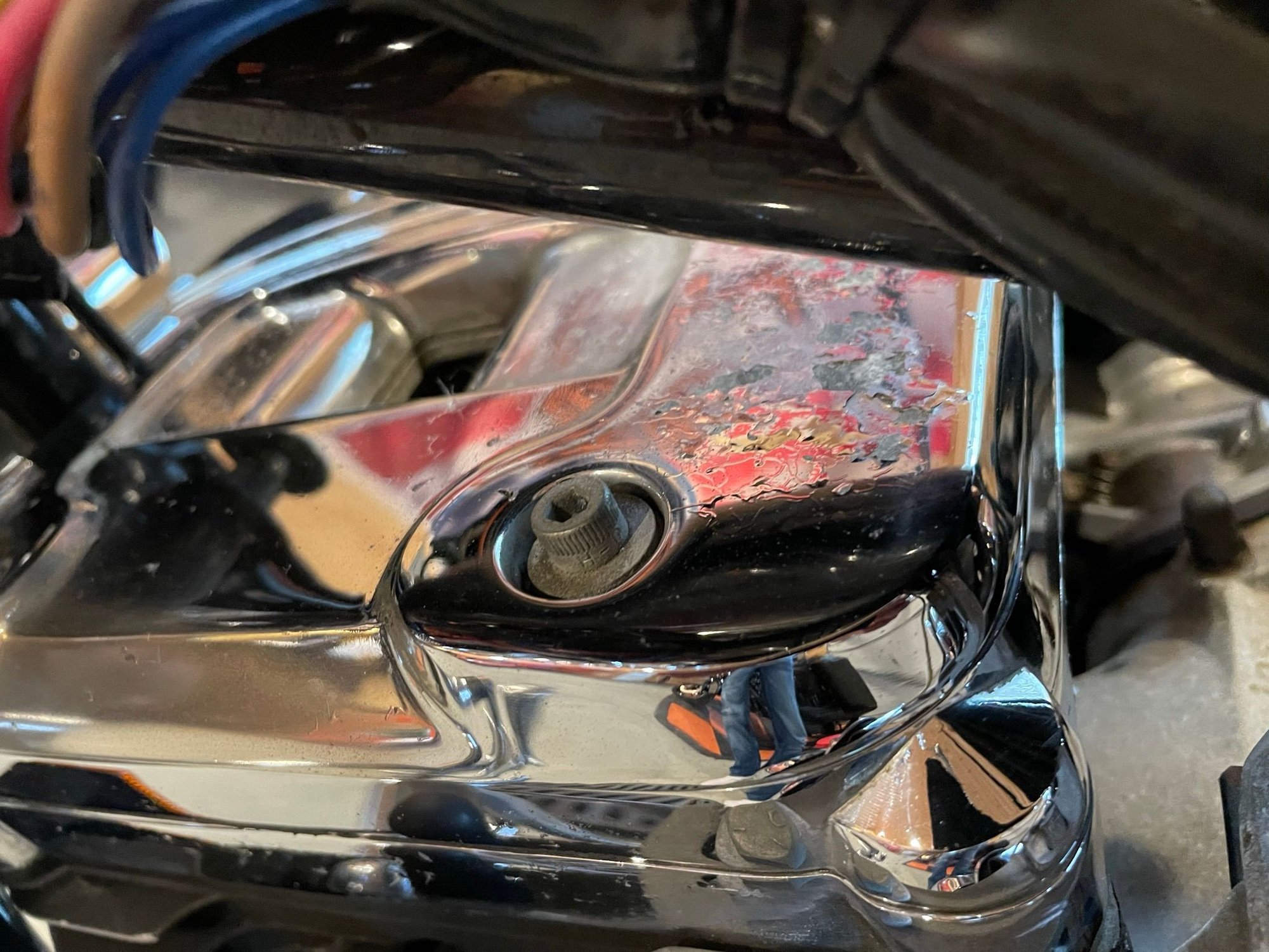

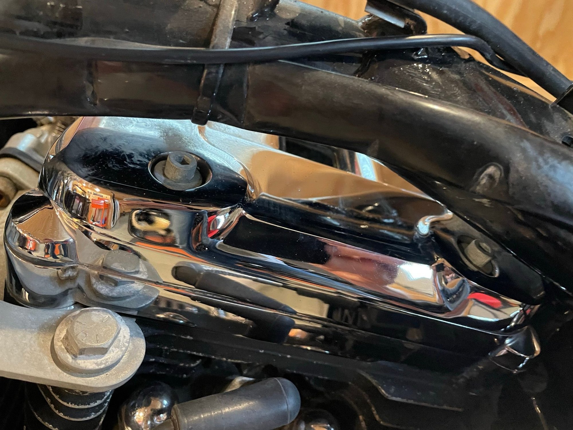

Hey Guys,
I’m looking to replace my pitted/corroded rocker covers. I assume I would need to replace the gasket underneath as well? What about the lower rocker gasket? Can I reuse the hardware? There are no oil leaks. Strictly cosmetic. Looks like there are a few oem covers on eBay. I’m not looking to go with aftermarket ones. Let me know your thoughts. Here are some pics:

You only need the one gasket for each side.
yes, you can reuse the fasteners… but maybe some polished SS or chrome fasteners would be nice.

You should put new fiber or copper crush washers under the 1/4-20 screws!

get a good rocker box gasket set and change the umbrella valves while you are in there .. once you remove the top cover the middle section will be loose also ... the bottom section is attached to the head ... you don't need to remove them unless you want to replace the gaskets under them ... OEM or James gaskets are good sets
