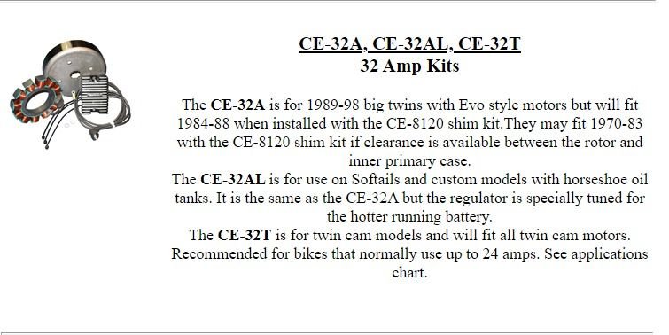

As title states, I'm looking for an Alternator Kit for my 1999 FXSTS.
Cycle Electric in specific.
They list 2 kits for my bike :
CE-32A & CE-32AL
They seem to be the same kit EXCEPT the CE-32AL has a different regulator & is specially tuned for the hotter running battery inside the horseshoe oil tank.
Any of you good folks buy one of these & which kit did you purchase & why.
Thanks for any help.

I haven't but a local indy I know well has done a couple of softtails friends have.
Both times he used the CE-32AL.
For him the warranty from CE was a reason for using what they recommended
WP

Everything I can find on it points to that particular unit for a Softail
but thought I would ask here. Never knew there was a problem with the battery getting too hot
from being surrounded by hot oil, but makes sense.
I’ll go with that unit.
