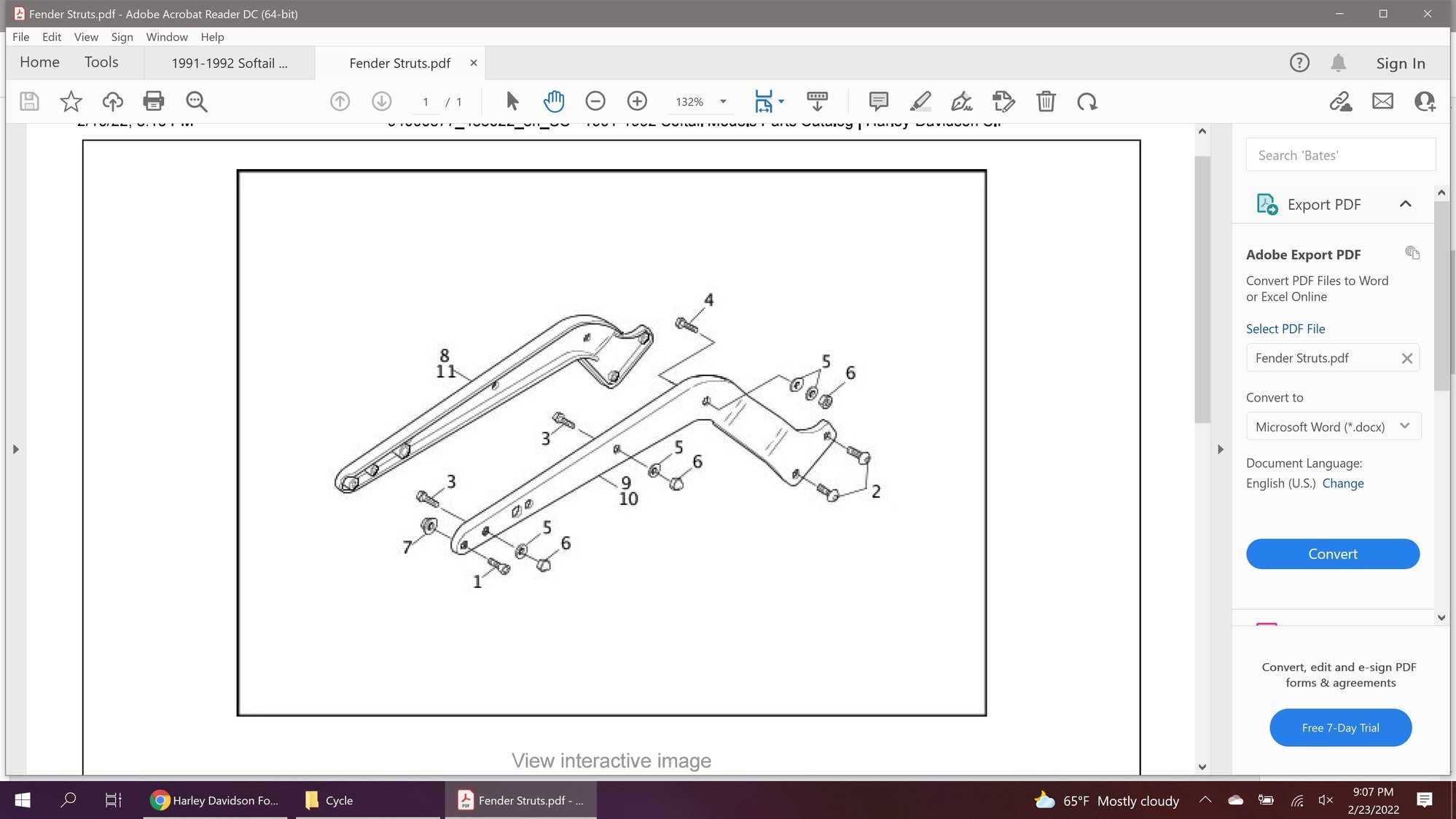

These the fender struts you're looking for? Do a Google search for hd 59954-86a & 59955-86a
That is what I think of when I hear fender struts.
Those are just covers. If the frame was cut you're going to have to weld.
Or get a strutless fender that bolts or welds to the frame behind the battery box.
