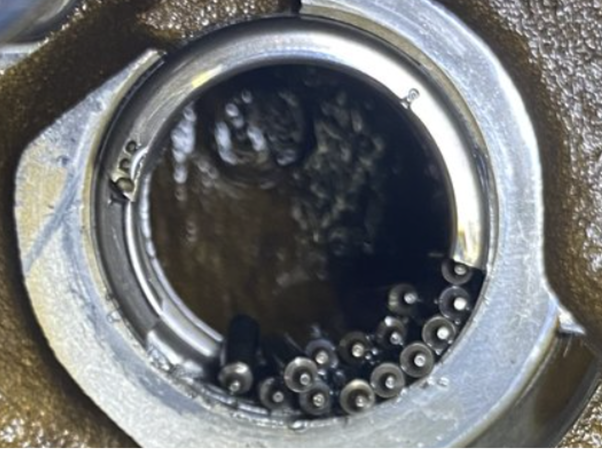

Could damage like that be caused from pulling the cam cover without unloading the pushrods?

I don't think so. No bearing should let loose like that. That thing let loose in a bad way. You can put it back together with a new pump and hope for the best or break it down and clean the whole thing out.

Forget about counting the rollers in that bearing. You need to split the cases and check for internal damage. The bearing pieces may have damaged the crank bearings.

Looks cracked, for whatever reason, possibly on install. The rollers don't look like they were sliding.

Am I seeing the word "Torr" at about 9:00 on the bearing face? I see no signs of the plastic cage that holds the rollers for the INA bearing.
Also see some similar markings on that bearing that match the markings of the 'torr" bearing the link below. Regardless, it looks like you still have some missing rollers. Sorry man.
https://www.hdforums.com/forum/exhau...is-normal.html

I think you are right about it saying torr. The shop seems pretty solid. I would be very surprised if they didn’t know the difference in the bearings. In order to lock up the oil pump the roller had to fall into the crankcase correct? If I can flush with kerosene and six more come through the same way then I’m good. I don’t want to split this thing open and put it back together without rebuilding it. This bike is in exceptional condition so it’s worth saving but IDK how much is too much when it’s an extra bike. The shop suggested finding a used engine.

What are you going to do if you recover the rest of the bearings? Put them back? After a catastrophic failure as that. It seized the oil pump. As hard as it is to come to grips with.. You really need to take it all the way down. If you want to keep it. Do it now. Or. Do it later. Or button it up up and sell it to some schmuck. The shop is full of ****. Why find a used engine? And. Have to deal with title issues. You don't know what condition it is in. Could be worse than yours. You know what you got. Your call. Too bad for what happened to your ride. **** is going to break. Happens to me all the time. Gotta deal with it and move on. If I sound harsh. I am just old and cranky.

If you knew exactly how many rollers are missing you could pull a cylinder and "go fish" with a borescope and magnet. But without a full count you'd be gambling.

Thats good. But. He still would not know how much ground up **** is floating around in the engine. Crankpins are kinda of pisse about that ****.

Washing it down with kerosene or whatever is not going to help you clean out the case the whole deal is there's a scraper back there about the 2:00 position that the flywheels carry the oil to.. It has minimal clearance and that scraper is what feeds the oil pump. There's no way you're going to wash out and try to get any left over pins out. You're going to have to split the cases and it's not that big of a deal.. It's not like you're going to be resetting the clearances on the timken bearings to make sure the wheels are centered.. You're just disassembling and putting back together.. while you're disassembling a good look at the pinion side bearing and the sprocket shaft side bearings the timkins, and if you see any funny wear on them due to metal traveling through the motor then it's possible that the crank pin has damage because the crank pain gets oil before the timken bearings do.. Get yourself a service manual and do it by the book.. It's a lot simpler than you think. I would definitely start by checking excessive play in the rod bearings on the crank pin that would be your starting point... You would be stupid to assume that you can just try to clean it out and throw it back together. Ain't going to happen.. listen to these guys.. They have a lot of knowledge...
And yes that looks like a Torrington bearing.. The best thing right now is to disassemble the oil pump and post up some pictures...
