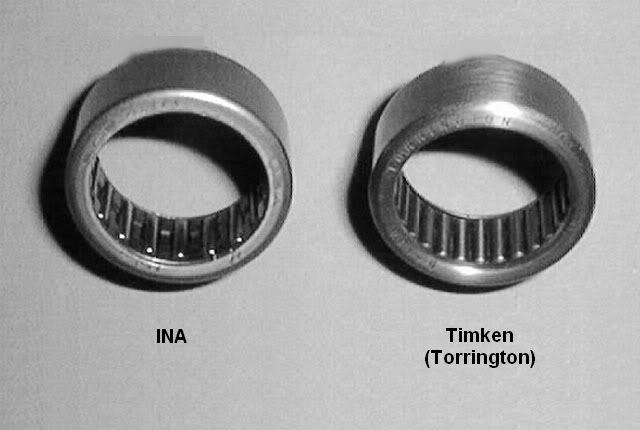

93' ultra classic lost oil pressure. the shop said it was the cam bearing that failed and the needles siezed the oil pump. they said that they could only find 23 of the 29 needles. my question is how possible is it to recover the rest of the bearings. I'm assuming they must be in the crank case.
I believe the stock only had 23 needles if they're all accounted for don't split the case but replace the oil pump .

No, no. The evidence points to it being a Torrington full compliment cam bearing with 29 rollers. Until someone has an Evo INA bearing in hand and does the count like I did, I would not trust it. Bearing has to be for an Evo engine, because the cam bearings for T/Cs are different. They have slight higher roller count.
At this point, do what rigidthumper, myslef, and other folks are advising; split the cases and triage it from there. Take your time, since it's your second bike.

I have an oem caged bearing at home, i will report back this eve. Came from my '98 RK, looked fine but i swapped it with a cam install.

That bearing on the left is never going to get to 23 rollers
