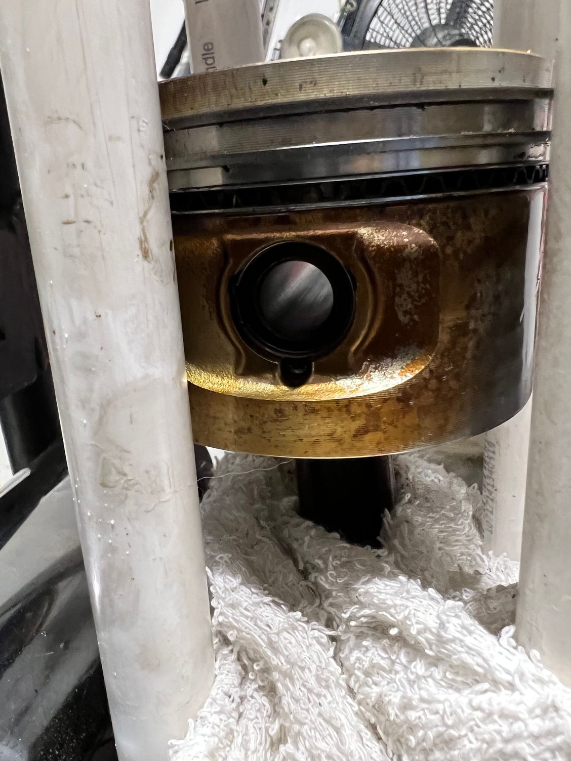

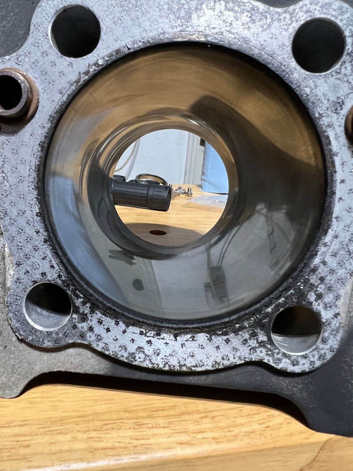

Cylinder looks good to my untrained, naked eye. Sure looks fit enough to use with new pistons after honing and truing the bases.
I guess these pistons look ok and based on the CCP and LD tests, I could probably just put new rings in and call it a day. But what fun would that be?
These look pretty good actually.
