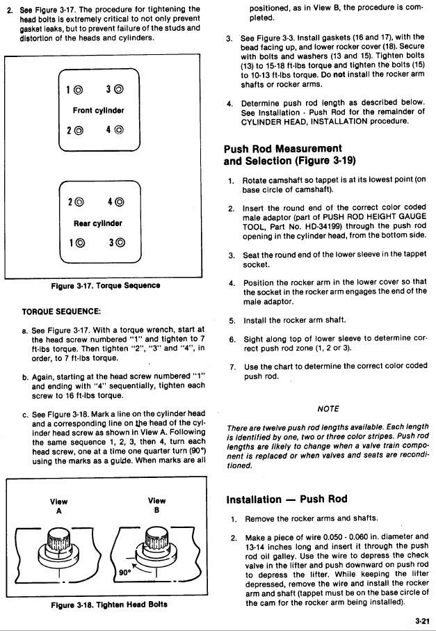

From the shop manual:

I saw that in the manual, too but I used James gaskets so just went with their torque sequence. Are you saying you still turn the bolt another 90% after torquing to 42ftlbs? I torqued the one bolt down to 42ftlbs and marked it like someone suggested. Then went for a good hour long ride. No more wet mark and the the mark I made on the bolt didn't move. I'll keep an eye on it and see. Thanks for all your help.
Do not torque the head bolts more than 42 ft. Lbs, or you'll pull the threads out of the crankcases.

Yeah, don't give it 90 after 42 ft lbs or you will be pulling it apart and helicoiling the cases. I just do what the book says, 16 ft lbs (192 INCH pounds) and then 90 degrees.
