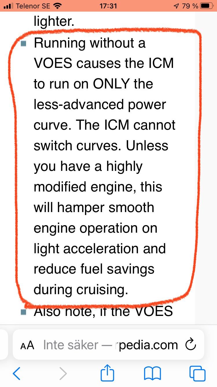

I managed (yes I'm clumpsy sometimes) to diconnect my VOES once.
My bike did not act anything like in the description of your bike.
But that's not to say that it could not be the VOES giving you troubles in your case.
