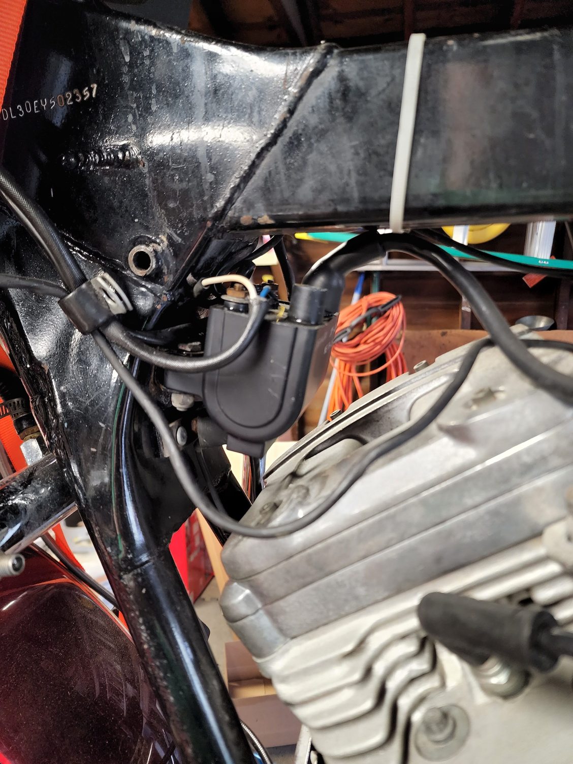

look at this picture. do i have it mounter right as i cant get the wires in it good.

While I don't know the answer, all I can say is that don't look right. I think your missing a bracket or something.

From the VIN, it's definitely '84 FLHT. I've never seen one with the coil mount tabs where those are. All I've ever seen had that bracket welded to the underside of the top rail as marked in the photo.

Hmm, i might have the wrong coil in?

They are all about the same so far as mounting and dimensions.

Hmm well that is different then mine.

I think if you had some 90 degree boots on the coil end, you would be OK. Those boot ends might be replaceable.

He `s got the 90`s on the plugs and the 120`s at the coil , switch the wire end for end

thanks, i will just order some 90 for the coil.
