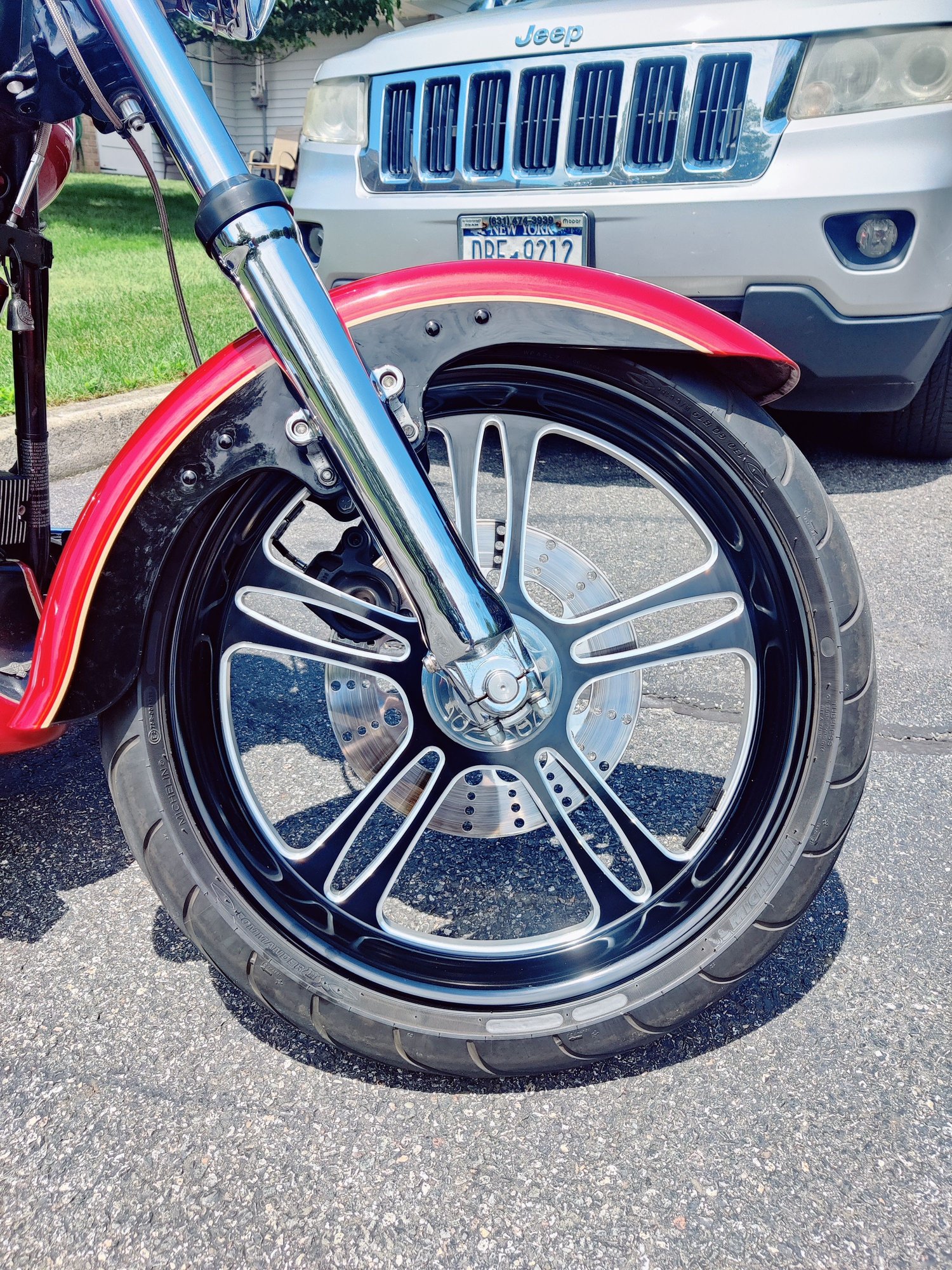

Is that a wide glide front end/triple trees you got on there and if so how did you space the Fatboy fender?
I ask because my dry trees are 10 inch on center where the FLs being a heritage or fat boy or 9 and 1/2-in on center And it looks like you have a fat boy fender there little flare up on the tail, tells the whole tail... lol...

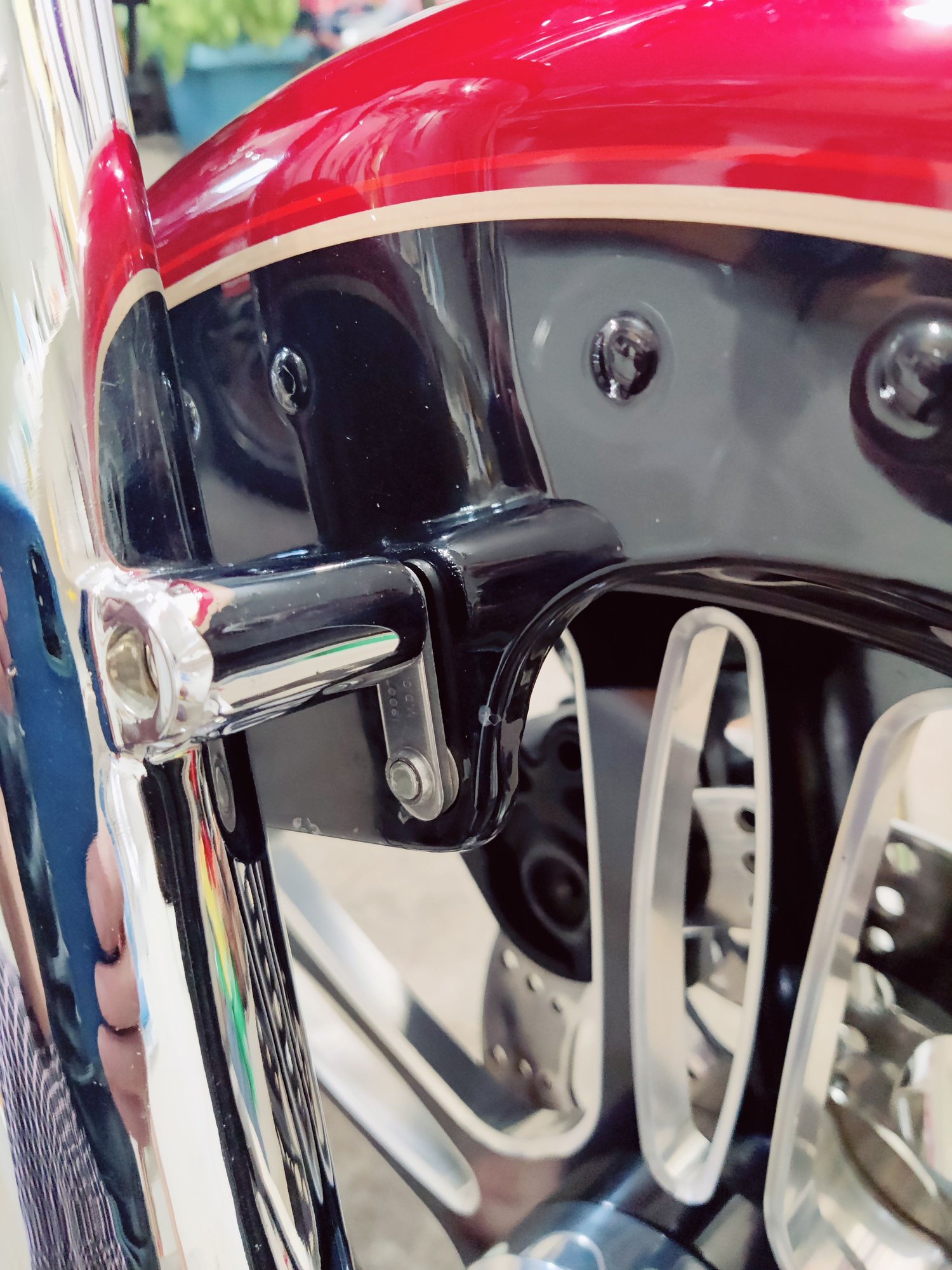

There's 1/16 washers on the throttle side, they fit right into the recesses on the fender quite nicely. The brake side are 1/4 inch spacers from a pile of sporty leftovers, they also fit cleanly in the recess on the fender. Center lines it on the 19 perfectly, for the time being.

@98hotrodfatboy it all looks like this currently. Trees are 10'' on center.

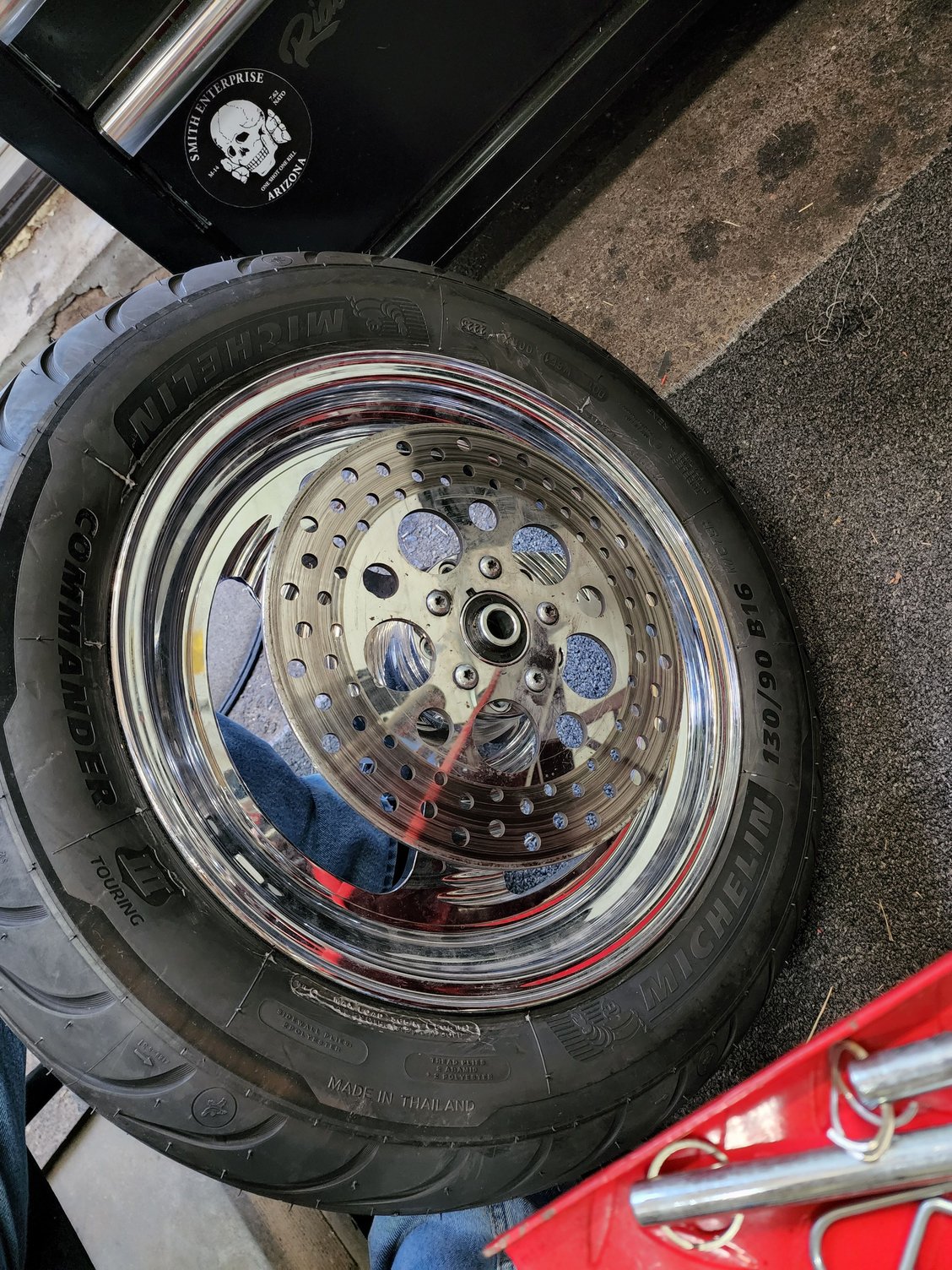

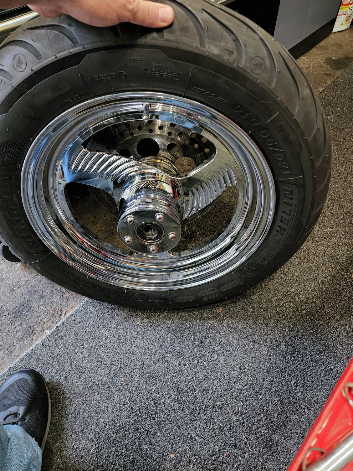

Found a nos 16 rim for the bike. Was looking at a set of used polished rims, but there were issues. So I'll run with this. The rotor will bolt right up , as will a trim piece that covers the 2nd rotor position I'm not using. Might get it all together this weekend.

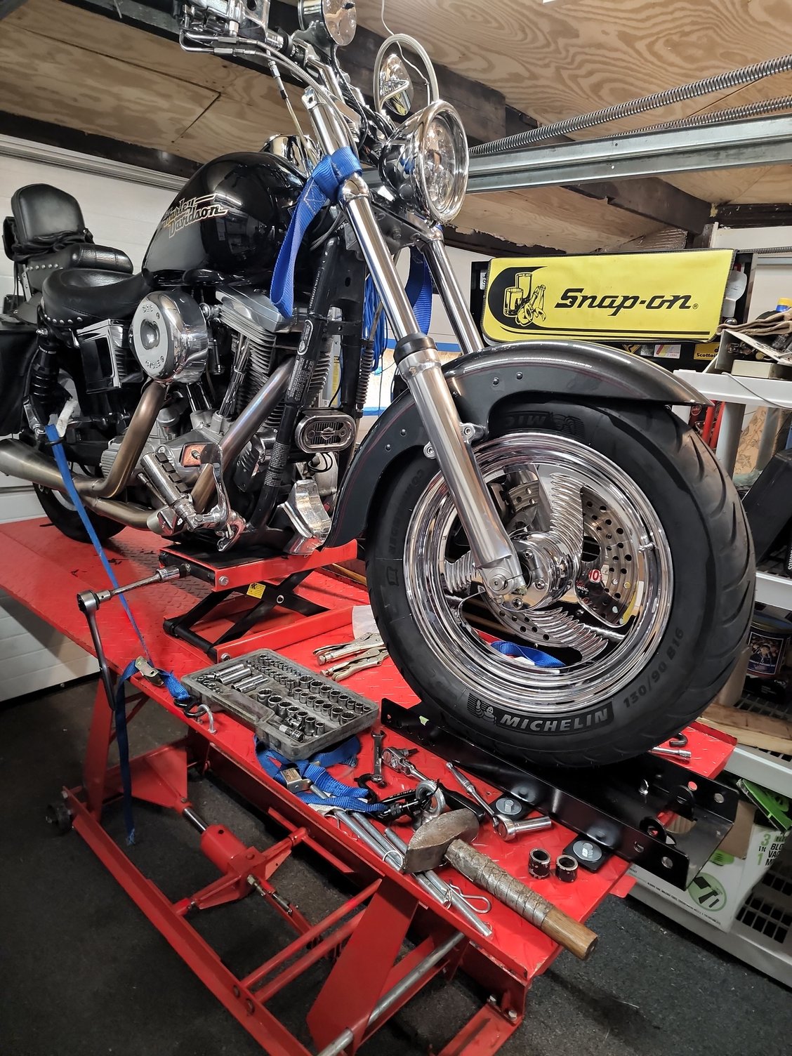

The old 19'' and the 'new' 16'' are both CCI for the trim piece and rotor crossed right over, easy peasy. I shimmed the wheel to the brake rotor being centered, had to fab a couple parts. Used a belt sander, file and a couple drill bits. Came out respectable, not show quality, but go quality.
One thing I need to figure out is why with the 19 the bike tracked perfect with hands off, and with the 16 if falls left pretty quick. Could be the tire profile (commander iii) being new, guess ill wait and see if it settles.
Had to recenter the fender with 1/8 inch washers at all four points, and shorten the mounting bolts.
Went for a quick ride before the rain came in....i like it!

You can get these
https://www.lesker.com/newweb/flange...gid=platenuts1
In a 5/16-24 thread to lower the fender down into the tire and won't need the spacers.. The thickness of the stainless plate is a perfect fit.. It's what I did..

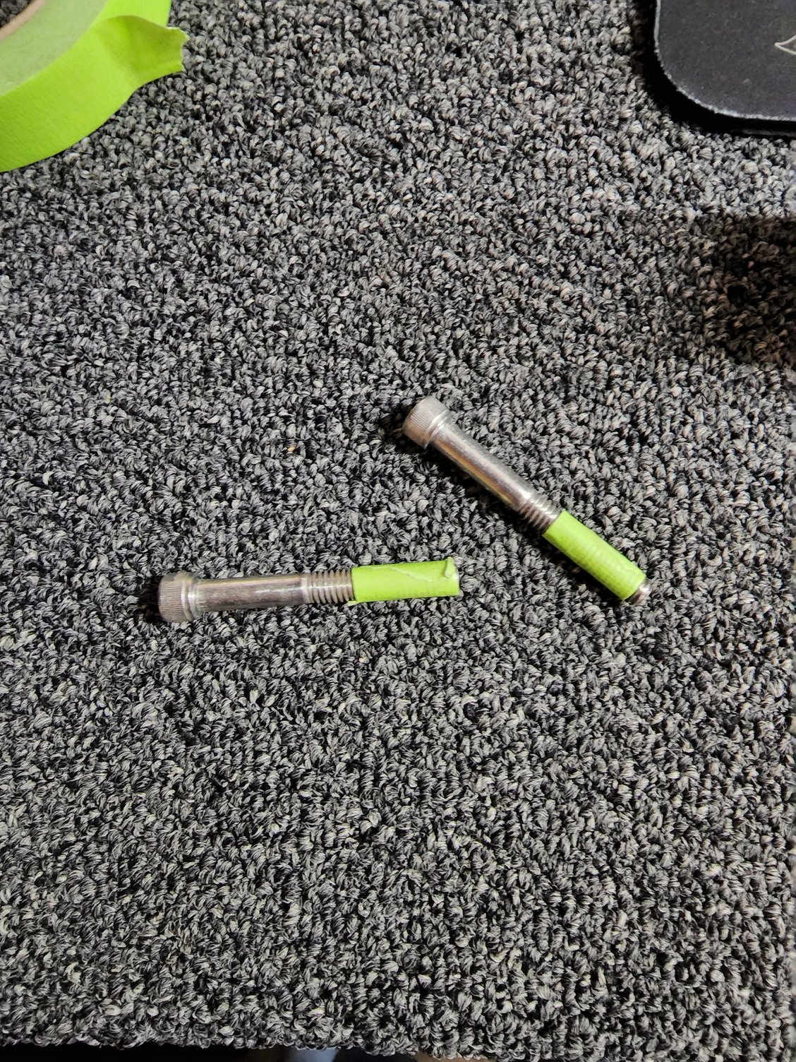

The nice thing is that the perforated threaded area fit perfectly into the slider lowers therefore getting the right size socket cap screw length could be used without protruding from the edge of the CF nut..
I also cut down 5/16x24 stainless bolts and slipped a stainless washer between the fender and the CF nut because the OEM Fatboy fenders have a recessed area there and then assembled it all perfectly and used loctite on the bolts..
I thought they came out really nice without being gaudy..
I believe the socket cap screws were 5/16x24 by 1.75" but measure to make sure.. You don't want that bolt going into your fender..
