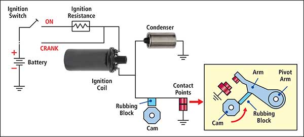

That's part of it.
What hooks up to where?
Do I need a different coil?
I'm getting old and have forgotten a lot of **** over the years.

You don't need a new coil. Wiring is simple...

I must Disagree on the original (1979 I believe) ignitions bein Junk... they were universally Mistrusted by the "faithful"... nearly All were removed... Mine is still going strong in my '79...and I picked up an Extra...for Nothing.. just in case the Rumors were true..
Now... on to the Points stuff... I would Not... as the Quality of available components is literally a Crap Shoot... Condensers are generally Crap from the Git..
Mechanical advance Mechanisms...also Iffy. Do Not forget that a Coil for Points is also Critical... 5 ohms if you can Find one.. Do Not use Chiwanese Components ... the points plate especially.. Go to a swap meet and get an O.E. Points Plate..
I have Yet to experience any Problems with the later '80's H-D Ignition... super simple...and last a very long time indeed... I always put a Sportster Module on my Big Twins because the Curve is more aggressive and the Rev Limiter is higher..
If you Must go with those Mostly terrible mechanical advance mechanisms... Inspect and Lube twice a Year... and use the good ole Dyna-S... wires almost the same as the Points, to a 5 ohm coil...
