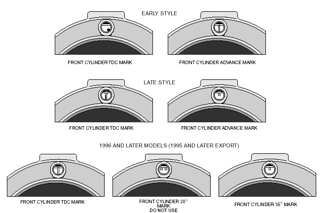

Ordered a points kit from J&P for my 1979 shovel. Put it in only to discover HD changed the timing in 77 so they would not work. I understand there is a special set to use on models later than 1977s but haven't had time to find them yet.
Nahhh
Only the timing "Marks" changed.. Looking...
