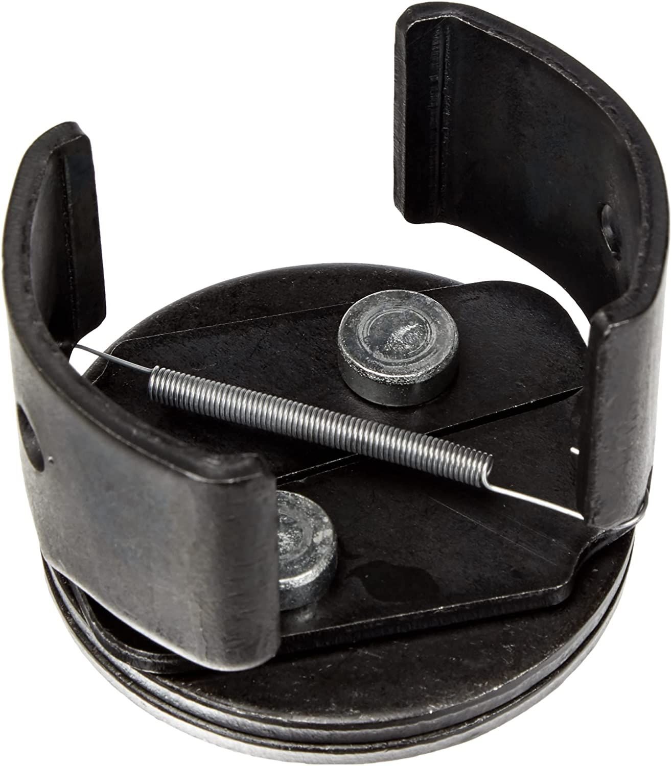

Yes. You can also drill a couple of holes in the face of your HD filter and use a couple of sheet metal screws through the holes to give you more leverage.
Or get you one of these as I have never had a filter I could not get off using these: 2 different sizes 63600 & 63250

I can't tell you what I would have given to have had one of these handy around 7:00 yesterday.

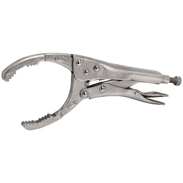

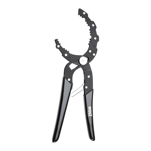

I actually bought two yesterday. I figured that since Harbor Freight was several miles away and I REALLY needed to get this filter off, I may as well since they're fairly cheap.
I got these two:
Only the second one was somewhat useful, because of the limited space. The steel mount for the voltage regulator is in the perfect spot to prevent you from having any leverage. Even the second one did nothing but further wreck the can after beating it with a 4-pound hammer.
