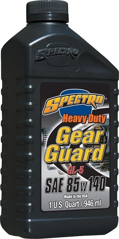

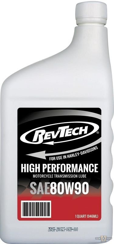

After second removal the transmission and doesn't figure out what the issue should be I installed the Baker Shifter Drum Kit
after reinstall the tranny.
The shifting is smoother but sometimes the gears (dow to 3 up to 5) jump in easy sometimes with a little more pressure.
I use the RevTech Transmission oil 80W90.
Probably I change the oil again and use the spectro gear guard
Other recommendations are welcome

Wasn't there something about Not using GL-5 in Older Harleys???
Tho '95 is really New for Me!!!!
I use GL-3 due to owning Old Iron
Old Aug 8, 2022 | 06:42 AM
blumi's Avatar
blumi
Joined: Mar 2017
Posts: 172
Likes: 44
From: Aarau
Aloha,
the only thing I heard about GL-5 shouldn't be used in older primary cause it should damages the isolation from the alternator.
For the gearbox it shouldn't be an issue.
Old Aug 8, 2022 | 07:24 AM
Racepres's Avatar
Racepres
Posts: 8,590
Likes: 3,362
From: Cental, MI
Originally Posted by blumi
Aloha,
If there are Bronze Bushings... I won't use GL-5... GL-3 Only... Harley, MOPAR, Jeep, Japanese (the very Few that use Bushings), Look into it.
As I remember the disassembly I can't remember to any bronze parts in the Evolution transmission.
Every part is made of steel and the bearing cages are made of steel or plastic.
So I'm not concerned about the mineral oil from Spectro or RevTech.
