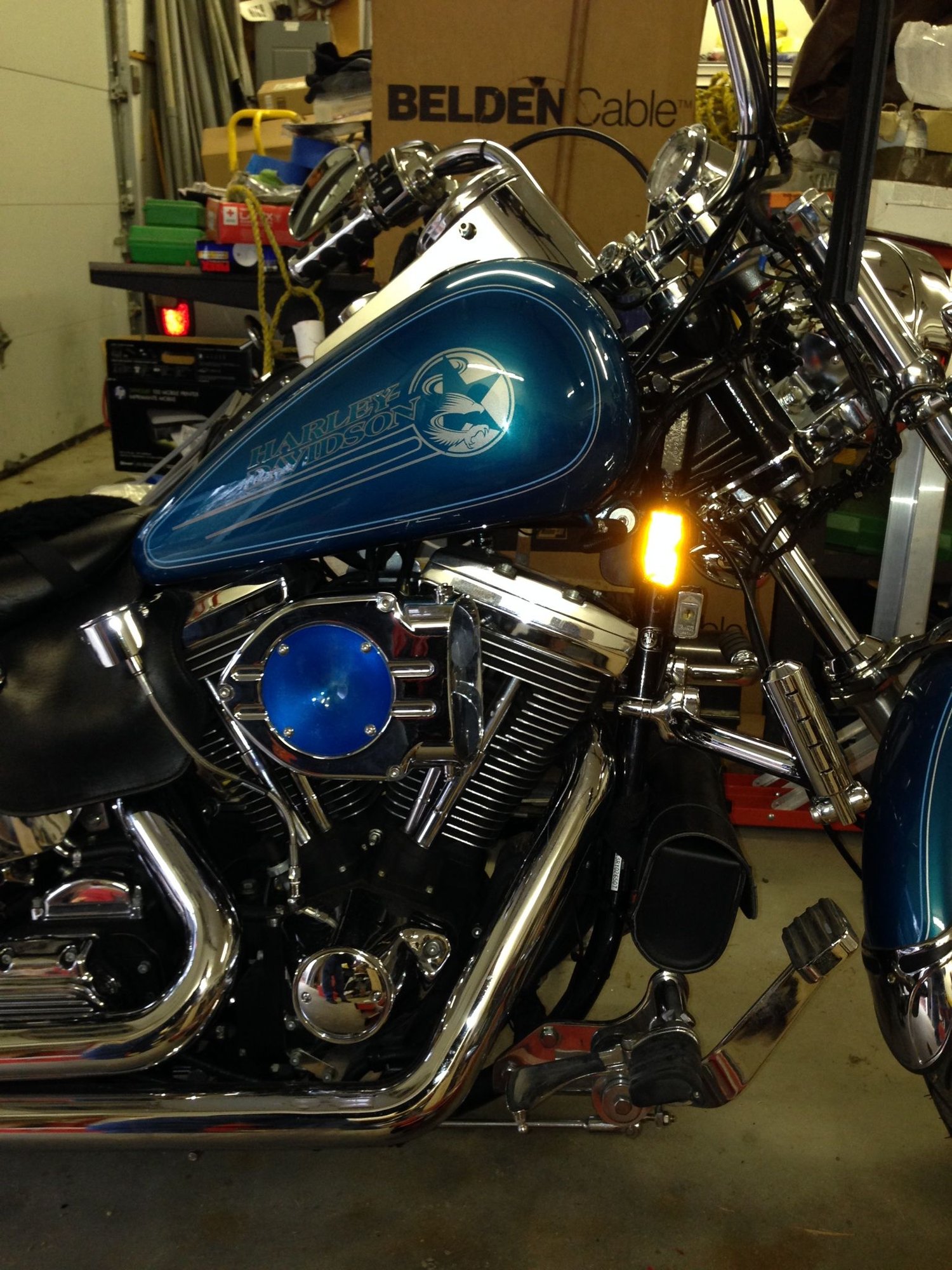

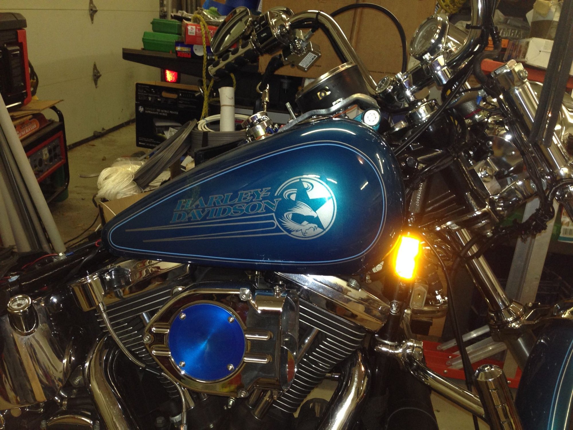

DK Customs had a kit for the split tank in test production but has dropped it do to end user issues.
I had one, it didn't come with the new spacers or longer bolts for the dash panel plate.
I removed it because I lost the use of about a gallon of gas because the angle was to much for gas to flow through the
crossover tube and the petcock being center of the left tank prevented gas from flowing once it settled in the tail piece.
Make sense? It's early and I'm foggy.
Basically I'd wind up with fuel in the right tank below the crossover tube and fuel in the left tank below the usable height to flow through the petcock.
Plus I did notice a weight shift imbalance around corners.

before
after picture a level line horizontal on the bottom of the tank from the crossover to the seat, that's gas you can't use.
Sorry the pictures are so big.
