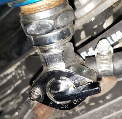

That teflon looking stuff is (was) a thrust washer of sorts. It does no sealing, only acts as a solid lubricant between the outer plate and the lever/valve.
Mine did that 20+ years ago. Pulled most of it out and honestly cannot remember whether I ever removed the plate. Lever got stiff at times but after a few weeks and a few drops of 3-in-1 Oil it's been working fine ever since - smooth to operate and no leaks.
If yours is working, snip off what's showing and run it.

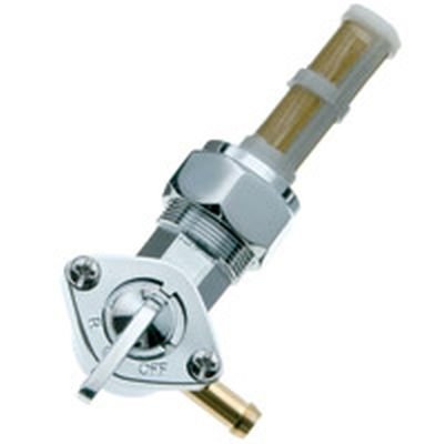

I replaced it with this one from J&P:
I went to my order history to see what it is exactly, but all it says is, "Chrome Petcock W 90 Deg Barb." It was $19.99 and here's their stock photo:
So far it's worked just fine.
