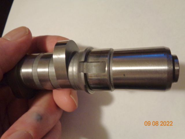

all of my parts showed up, today. I'll start on it in the morning. I have one more question. The new cam came with a gear. I've read many times that I'd be better off reusing the stock gear. How can I index the gear so the timing is still the same on the new cam? The dot on the face appears to be 180* from the keyway on the cam. Does the oem cam have the same keyway?
Old Sep 8, 2022 | 03:43 PM
t150vej's Avatar
t150vej
Joined: Dec 2005
Posts: 5,442
Likes: 2,638
From: NC USA
Correct, the timing dot for the pinion is precisely 180 degrees opposite the notch.

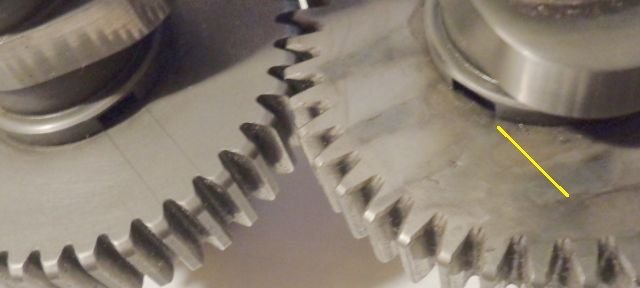

I've been intending for years to make a tutorial but been to lazy... here's a pic of a stock L cam without gear. You see the notch runs almost to the end meaning, you can sorta check the alignment of your marks before you start pressing.
The left gear is scribed precisely with the method I prefer but takes too long to write it up and do photo explanation. The gear mark on the right didn't show up in the photo, but basically use an ultra-fine sharpie or scribe and make a short mark at each corner of the notch on the original gear. Press both gears off and install the old gear on the new cam.
Remember - if you get it started or fully pressed on and see it's off more than say .005 or so, there is no shame in pressing it back off and adjusting so it's close as you can get it.
