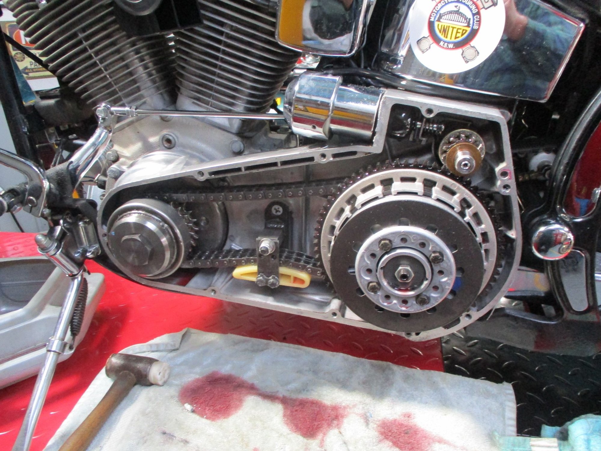

The short trip on the w/end proved to be the death of the mainshaft seal. Left home with a full 1.4Lt in there. Saw the patch of oil every time I stopped. Added 800ml for return trip and dumped what was left at home. 1.4 + 0.8 = 2.2Lt minus the 1.1Lt drained out at home means on a 240Km ride she lost 1.1Lt
So parts are on the way and I've started striping her down. Gawd the hub was tight on the taper, was worried I'd snap a post off. Left it tensioned with the puller all day and gave it one more heave when I got home from work. Two pops with the knockometer and she was free.
Hopefully tonight have the inner off and work on a puller for the inner bearing race.
Cheers

Thought I'd better report. Buttoned her up yesterday and a short 50Km test this morning showed no leaks.
I'm thinking the leak was form the starter jack shaft, it looked a lot worse than the mainshaft seal.
Will be a few weeks before I can put some decent miles on her. Booked in for a hip replacement in 3 days. But it will be a nice birthday present!

I've had the same leak starter jack shaft seal, replaced it still had a leak, took back apart, and the starter jack shaft has a shoulder on it mine was sharp and tore the new seal, took a file and took off the edge of the shoulder new seal reinstalled no more leak

I've been banging my head trying to stop a leak. I thought it was the lowest cover screw that a previous owner had either snapped the screw or stripped the thread and in repairing had drilled the hole at an angle.
After filling the elongated hole with JB Weld and re-threading and using new gaskets 3 times, with and without sealer (#3 Permatex & RTV Silastic) she still marks her spot. Today after a ride I got down low with a torch (flashlight) and noticed it was wet up the inside of the inner primary towards the mainshaft. BUGGA looks like it's the inner primary seal.
Question. Is there anything I have to watch out for or be careful about. Never had one of these apart before.
Cheers.
Musky
I’ve got an ‘88 FLST that had a problem with the jack shaft seal ( I think that’s the name) which would allow a bit of oil to seep through and cause a similar problem. For me I didn’t want to pull inner primary just to fix that but when my stator went I took care of it and no leaks since. The ‘88 flst has old style primary cover, solenoid, and the stator is behind the inner primary…not positive any of those are the same on your fxst though.
