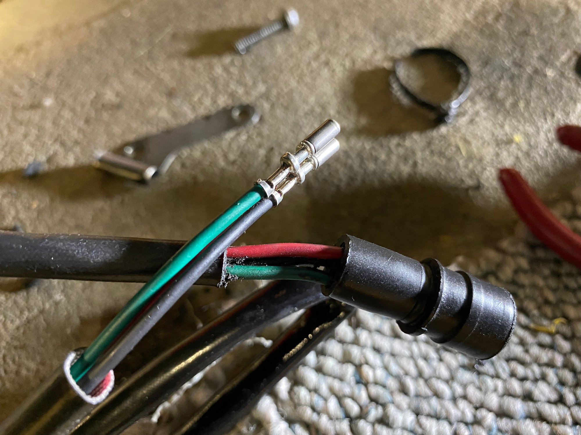

Could someone please direct me to some instructions for unpinning this type of terminal? 1991 FLH Ign sensor.

Yep, thats it ... Just push em out and push the new ones back in again. [I do have those electrical terminal tools-not needed this time]. I used dielectric grease - shoulda used the brakleen I think. Hard push even tho the rubber is still soft - one of the crimped terminals failed during the mayhem - had to solder it back on.
Took all afternoon for a simple job ... must be gettin' old ....but it runs ..... :-) and got rid of the melty old one.
