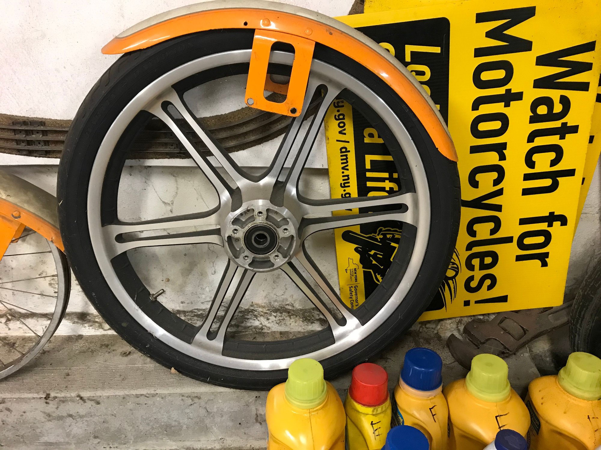

I have a 21" wheel from HD from their Parts Catalog. Cast wheel, tubeless. I had it on my 1997 Wide Glide for years, than went back to spokes. Shipping might be pricey but I would sell it cheap enough to get it out of the basement. it is for a 2000 and up, but I ran it on my 1997 with zero issues. I recall it was a direct fit except you needed a 2000 and up rotor, the older ones do not bolt up.
Here it is sitting in the basement, PM me if you are interested:
