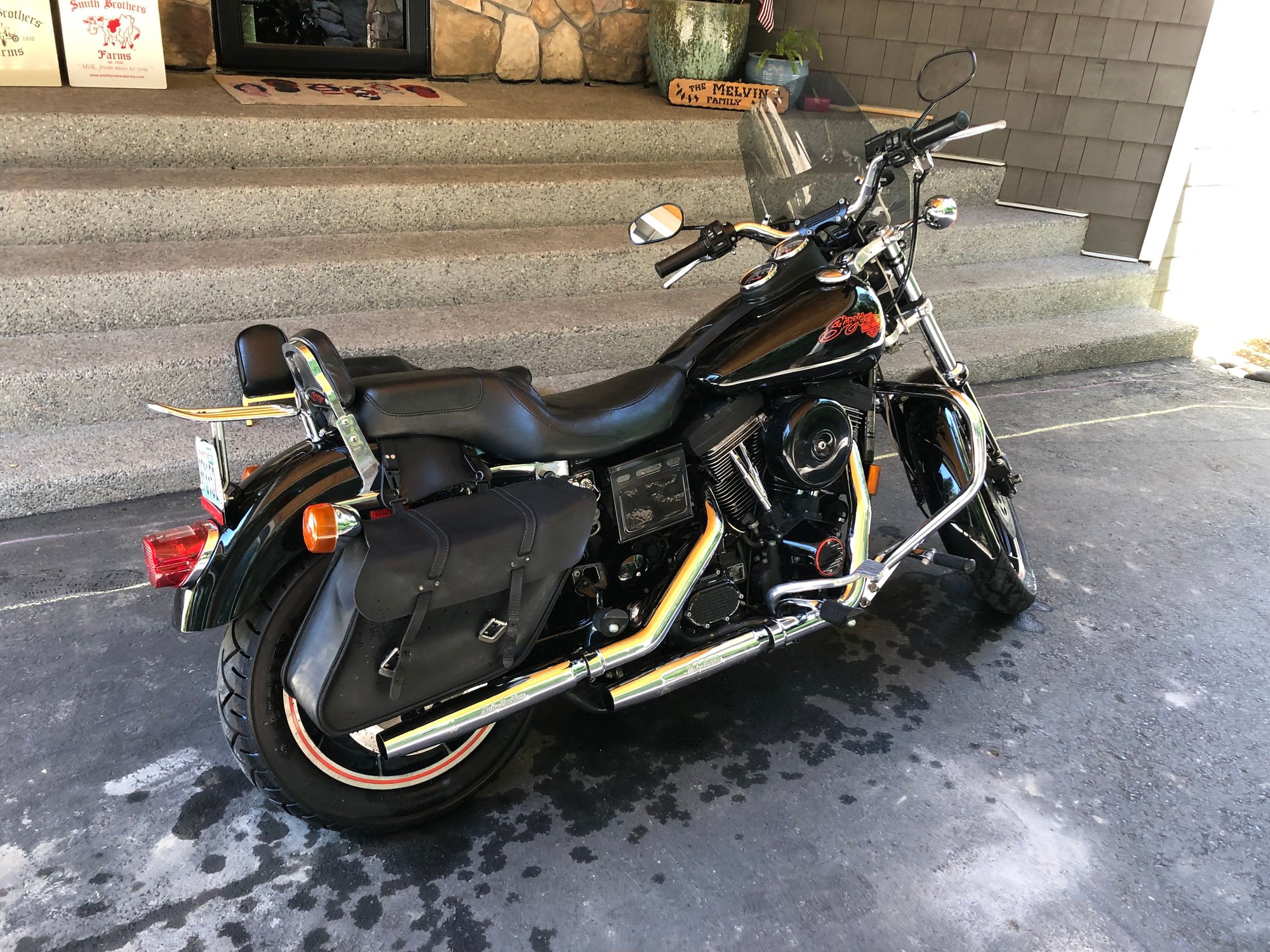

Here's my Dyna (91' Sturgis). I probably baby her more than ride her. Is that wrong?

Sweet looking ride!
As far as babying her more than riding her …. your ride, your choice! Hard to ride a collector’s item, but on the other hand, it was built to ride so I’m on the fence …
