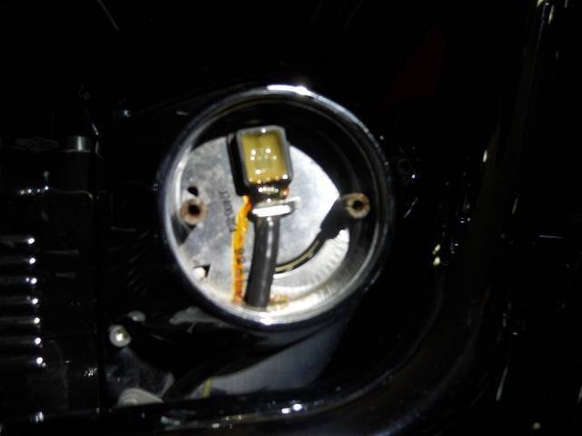

Did you remove the timing cover and check for this? More likely to cause the problem you described than the carb.
Also, not a good idea to be blowing pressurized air into passage ways of the carb unless it is totally stripped down. You can dislodge tiny "O" rings and delicate stuff making your problems worse.

gday heyman.my last resort will be to drill out timing cover rivets and have a look,which is getting pretty close😄i stripped the carby down as far as i could before i blew it out.thanks mate
