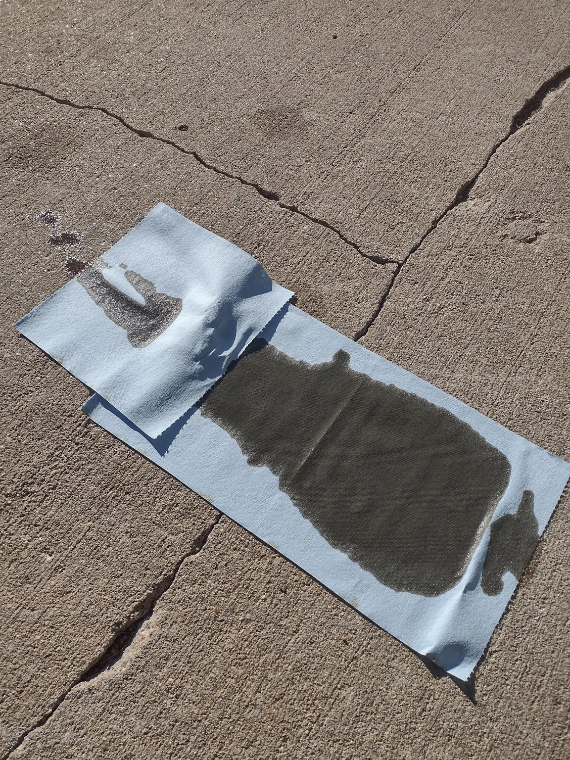

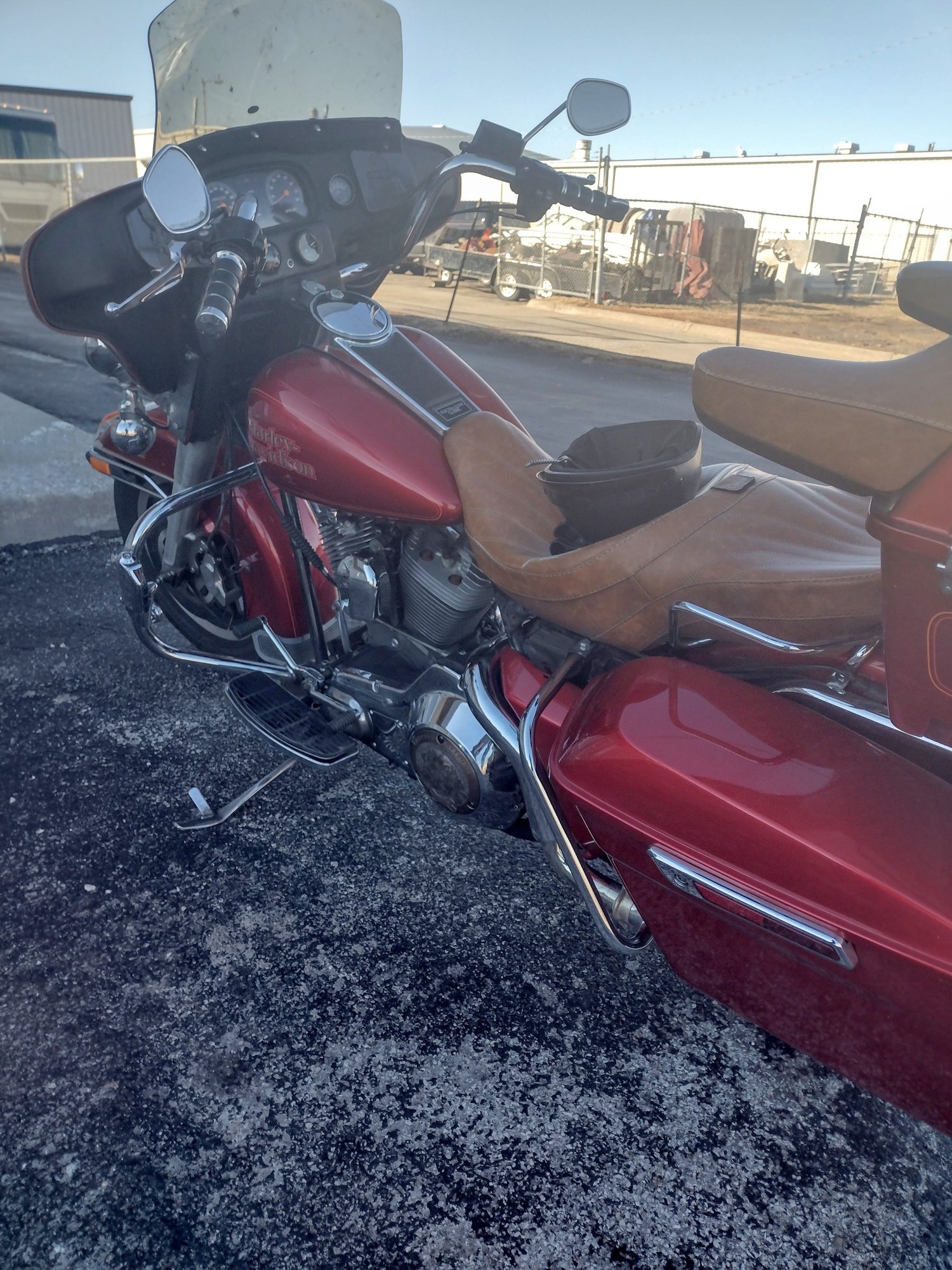

Nice enough (barely) today to ride to the shop for the first time this season. I broke the ice on 2023 a couple of days ago on the bobber (just rode around the neighborhood a little), but today I took the Electra Glide. Ten miles at Interstate speed in 35 degree weather says "take the bike with a windshield!"
First start in maybe three months got me this:
That's the second time she's sumped. First time was last year after an extended period of downtime when I was doing a bunch of work on the inner primary.
My guess is once I start riding her daily, this won't be a problem. We'll see.
Meanwhile, I'm mainly posting because I'm still basking in the glow of my first real ride of the year!

Who are you going to scare with those few drops

When I first saw the pic without reading the context, my first thought was, "Pothole incident." Glad it wasn't.

Oh Boy, glad you explained what those spots were.When I first saw it I thought it was one of those trick Psychological Tests that they give ya, asking you what do these ink spots remind ya of. Good thing I didn't answer the question or I probably would have been bared from the Forum for life.

Evo sumps. Blot it up with paper towels. Have a witch doctor read the signs.

First thing I thought was "****, he forgot the pan"... LOL..

Yeah, pan under my bike when I start it after a long nap. The quart that comes out would be rather a bit much for a few shop towels.

Yep, from now on, she gets the pan.
This latest instance was far less...um...profuse than the one last year. I'm guessing that was because of thick oil over the winter months minimized the leak-by on the check valve.

When HD moved the oil pan to under the trans, from the tank above the oil pump, did solve most of the tank oil getting past the check valve to over sump the engine with oil when the bike sits too long.
Hence motor is always going to have sump oil in it from when you turn the motor off, but did not need the help of gravity to just drain all the upper tank oil into the motor when the check valve is not seating correctly.
So just sounds like it time to check the check valve in the pump with an upper oil tank system, or just play the catch pan game if the bike is going to site for long periods of time,and it only a little extra oil that is going to be forced through the breather tubes during initial start up/before the oil pump can push all that back into the oil tank.
