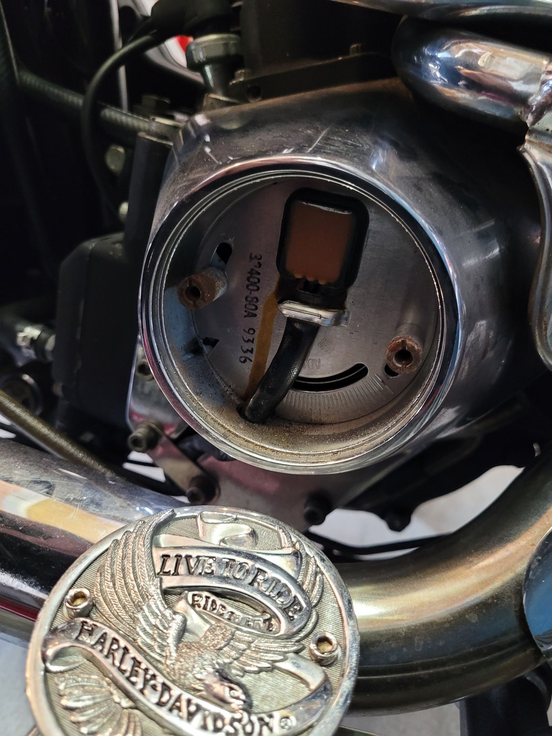

about ignigtions , can someone tell me if this is OEM or aftermarket , EVO Heritage 1994 ?
Thanks

That is the original parts number. Replacement is 32400-80B
Thanks
As mentioned that is OEM sensor and it needs to be replaced.
See the beige potting “goo” melting and running down? That means your iggy is giving up the ghost.
thank you , and what would be the best replacement for this , another oem or aftermarket ?

Opinions vary but I like the Dynatek 2000i
https://www.dynaonline.com/dyna-2000...odels-d2ki-1p/
The lowest priced option is a standard motors product direct replacement of that very same sensor you have now. It will retain the factory set curve. The Dynatek has different selectable curves and is programmable.
Sorry don't have the part number for the standard motors product (I'm at work) but it is like 50 bucks and an amazon item. Others will chime in with the part number for you. If not, I will post it this eve.

As mentioned earlier, using the part number on your existing module (32400-80a) here is the replacement for it:
https://www.denniskirk.com/search/19...tc.mmy/32400.q
