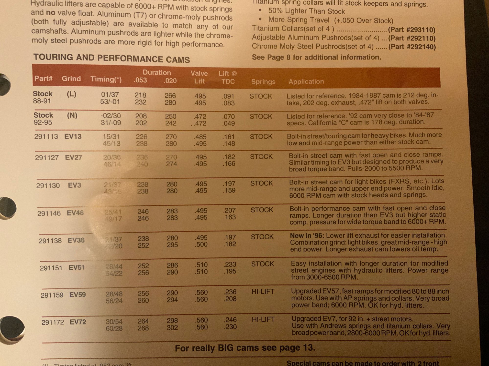

Ok thanks. The EV46 right?

I went ahead and bought a EV46.
Even though the cam works with stock valve springs, would it be a good idea to put in new oem or upgraded aftermarket ones with the new cam install?

Sure good idea

Good move, I was going to suggest the EV46.
I bought a bike that had the 46, it was stock except for a E carb & the cam.
It ran OK, but after I bumped the compression using .010" base, &.030" head gaskets, then decked the heads .060", I came to life, it pulled hard and had a good sounding idle. The valve train made zero noise.
It had 180psi cranking compression after the bump, but it was on the borderline of needing compression releases, it sometimes wanted to buck the starter.
If you want to change the springs, OEM or equivalent would do, no need for anything heavier with that cam.

We use the b hive single valve springs they are the real deal today and i dont cut the heads its a one way street when you do that sounds almost the same with out and no starter issues or detonation with the gas today
