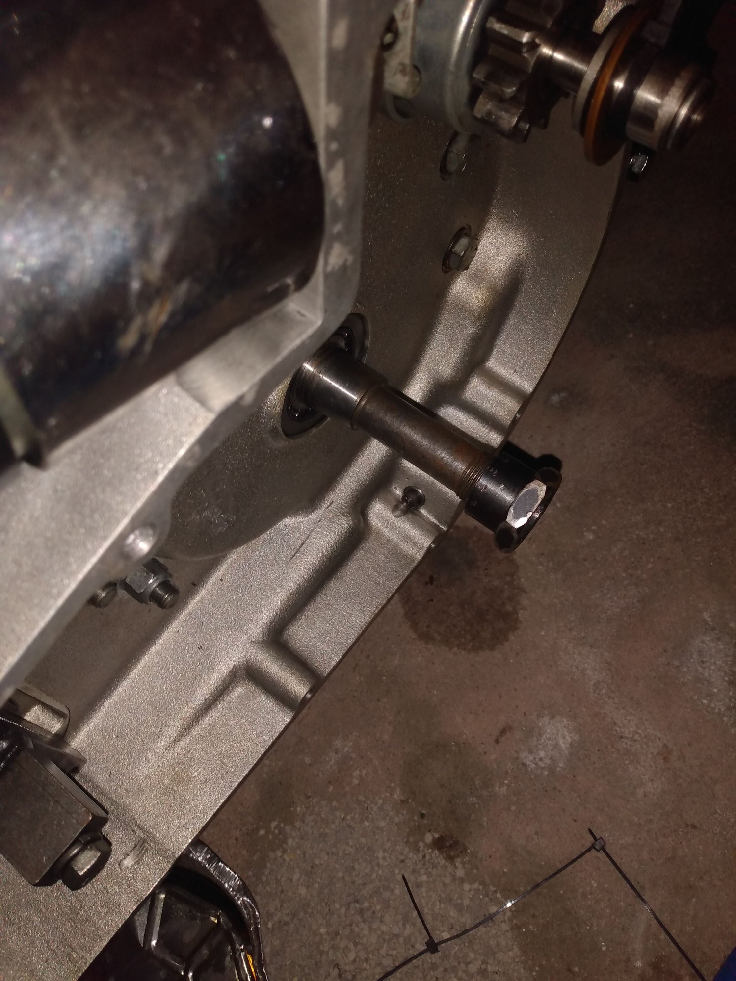

I have an 85 FXE-F Superglide and my tranny mainshaft isn't tapered.Infact it's about 2 inches longer then then other four speeds I have seen......Has a spacer though.
I would like a Picture and perhaps a Description of the Mainshaft/Clutch Hub used... Thanks...
BTW it is Longer because that Bike was Belt Drive final

Nope,Final is chain drive.....The spare tranny I have has a pully.And according to my parts book the clutch is late 84'

^^ Right...Typical Half Assed Taper (decidedly Not a Morse Taper) on the late 84+ clutch hub.. Nasty things...

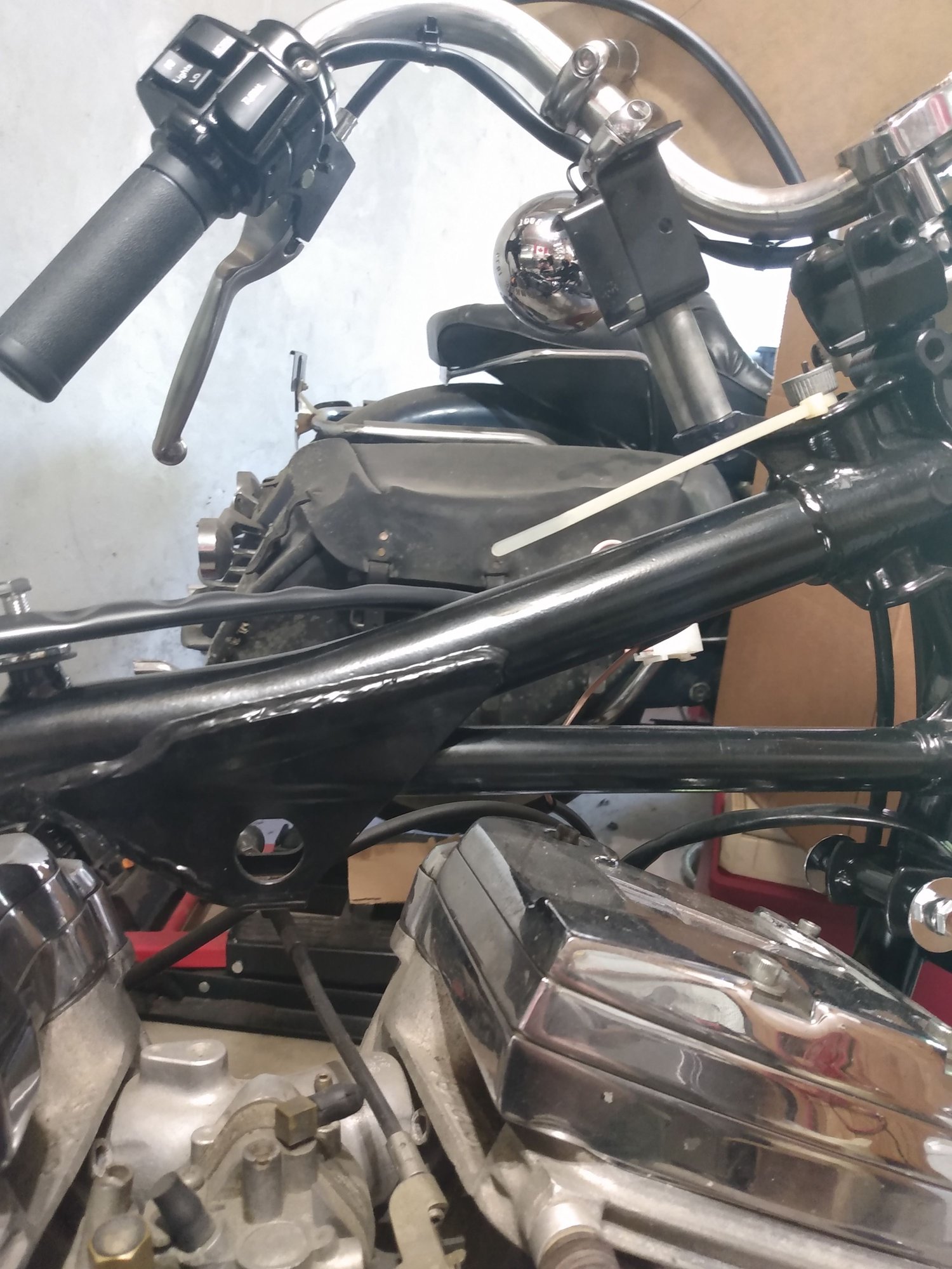

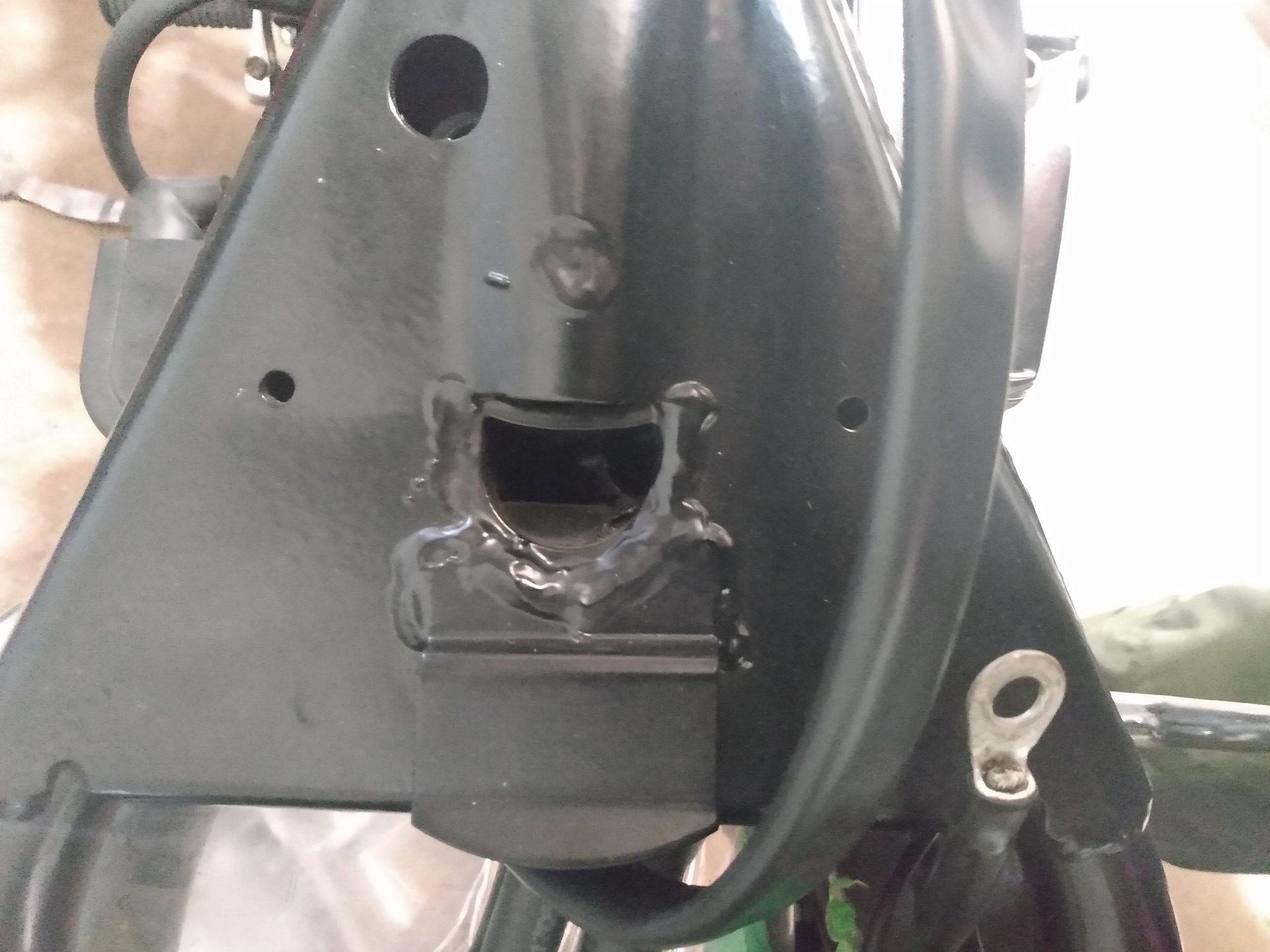

The seat post tube needs to be squished,bent back and dimpled for the rear head and
pipe to clear.And then some bending.Harley added 2 inches to the down tubes.
is it close enough that you would possibly be able to heat and hammer to clear the head and pipe? Not really afraid of cutting and welding, but I think I would like the look better kind of like the old panhead frames that guys smacked the seat tube for better panshovel clearance. And I’m also running sportster rocker boxes, even with only that tiny bit of extra clearance every bit helps.
I have an Evo motor on the bench, I guess I’ll just have to try it if nobody knows. Heat, smack, fit, repeat.
