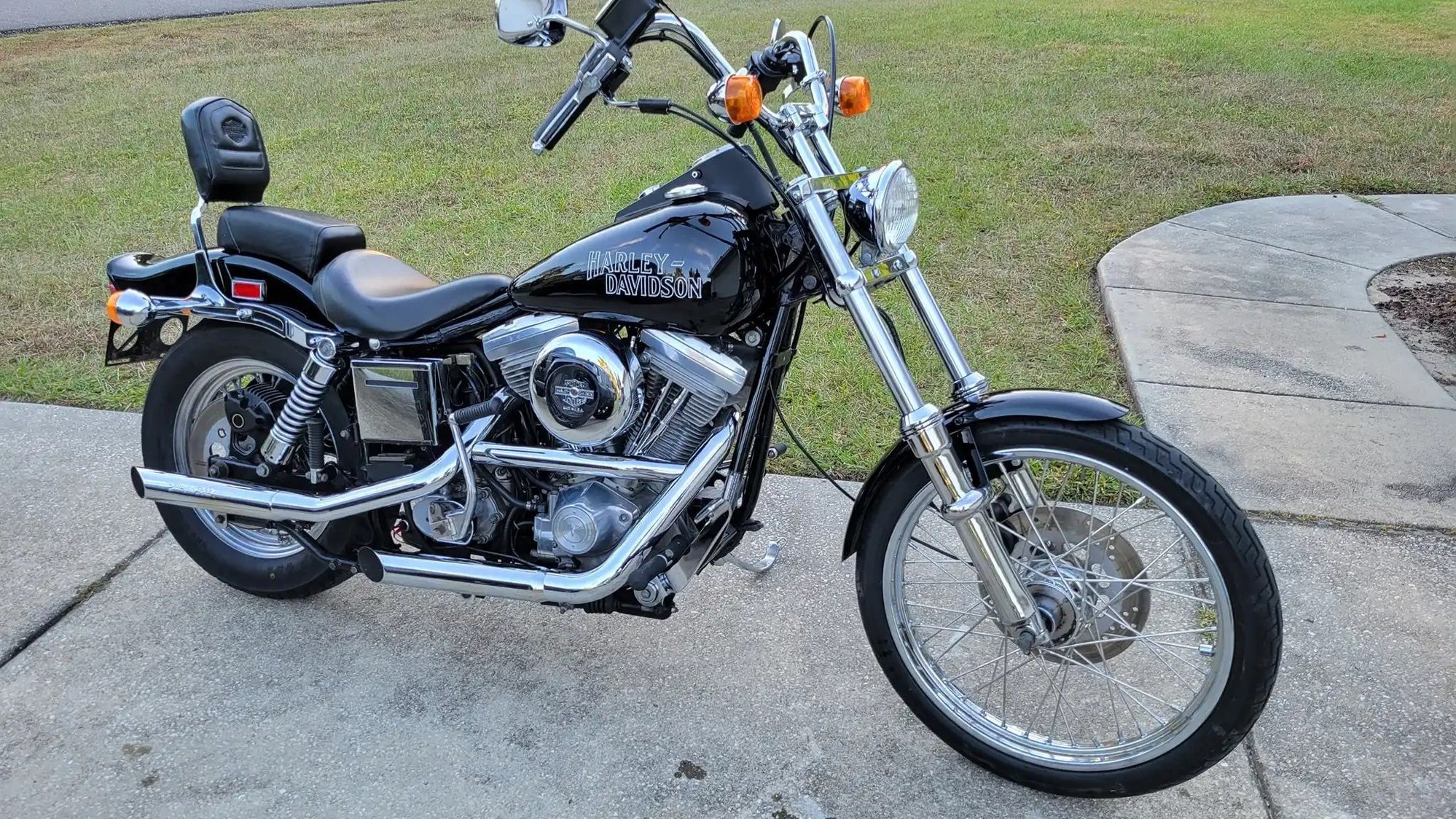

I currently have 3 1985s. 2 FXWGs (one since new), and a FXSB Low Rider.

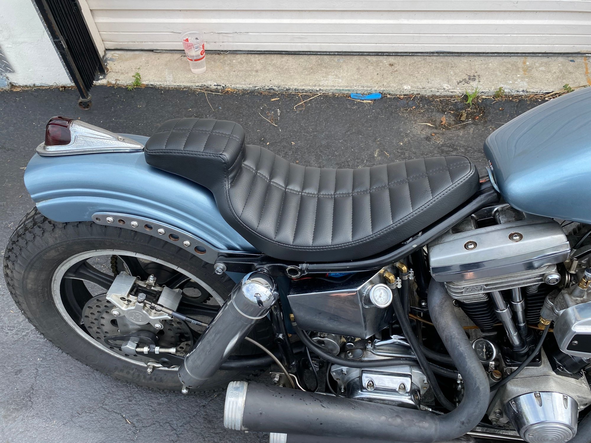

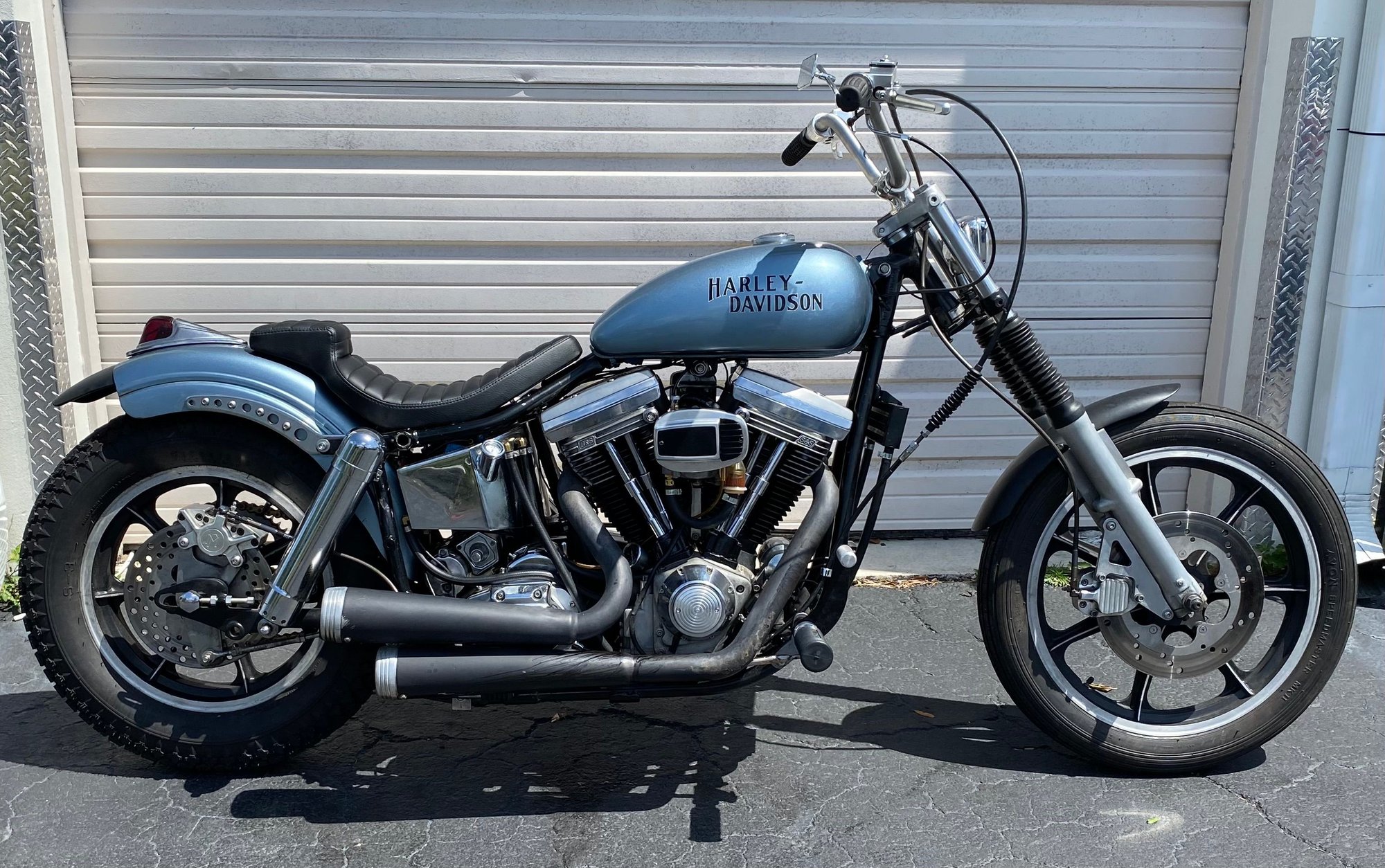

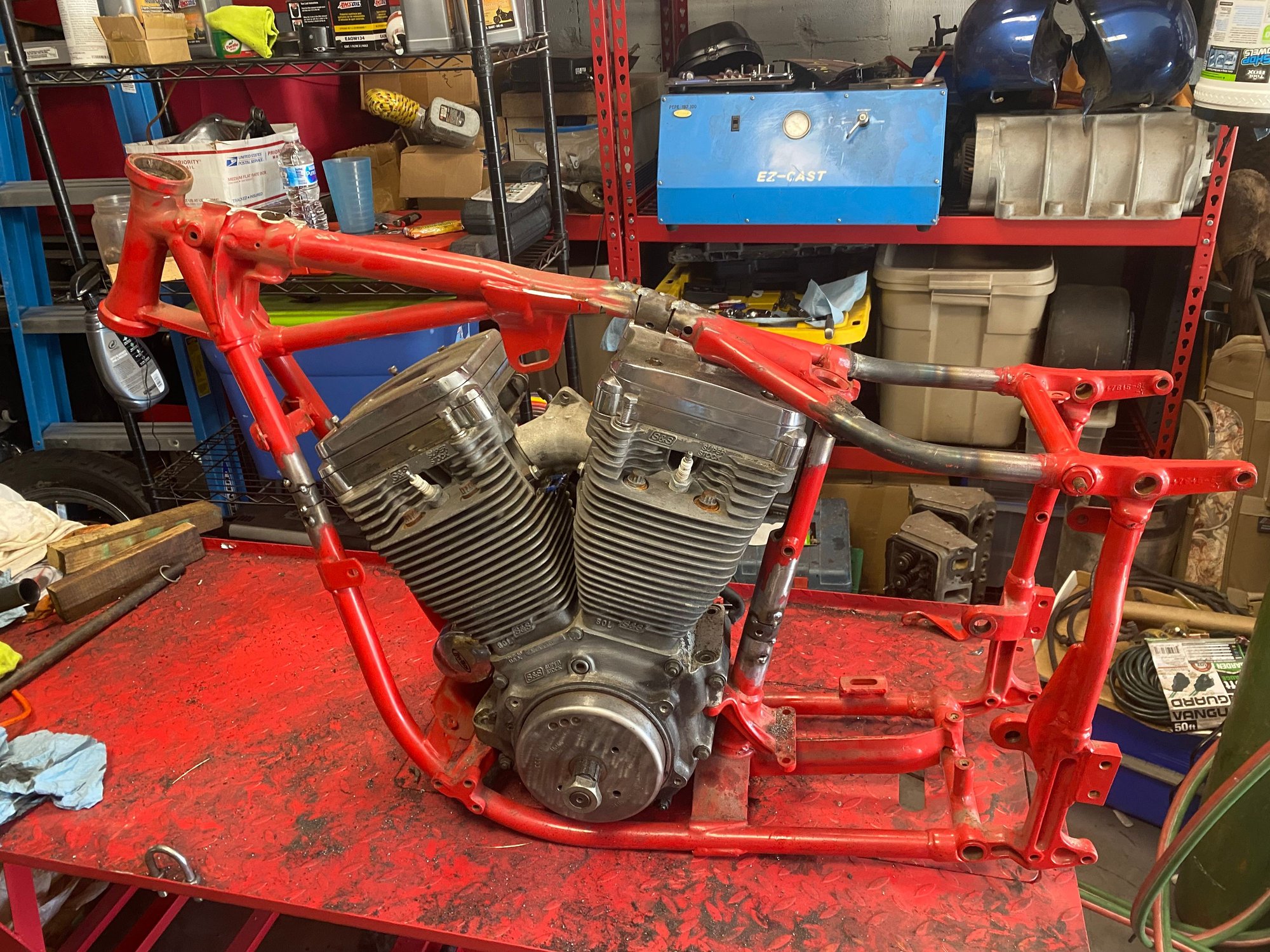

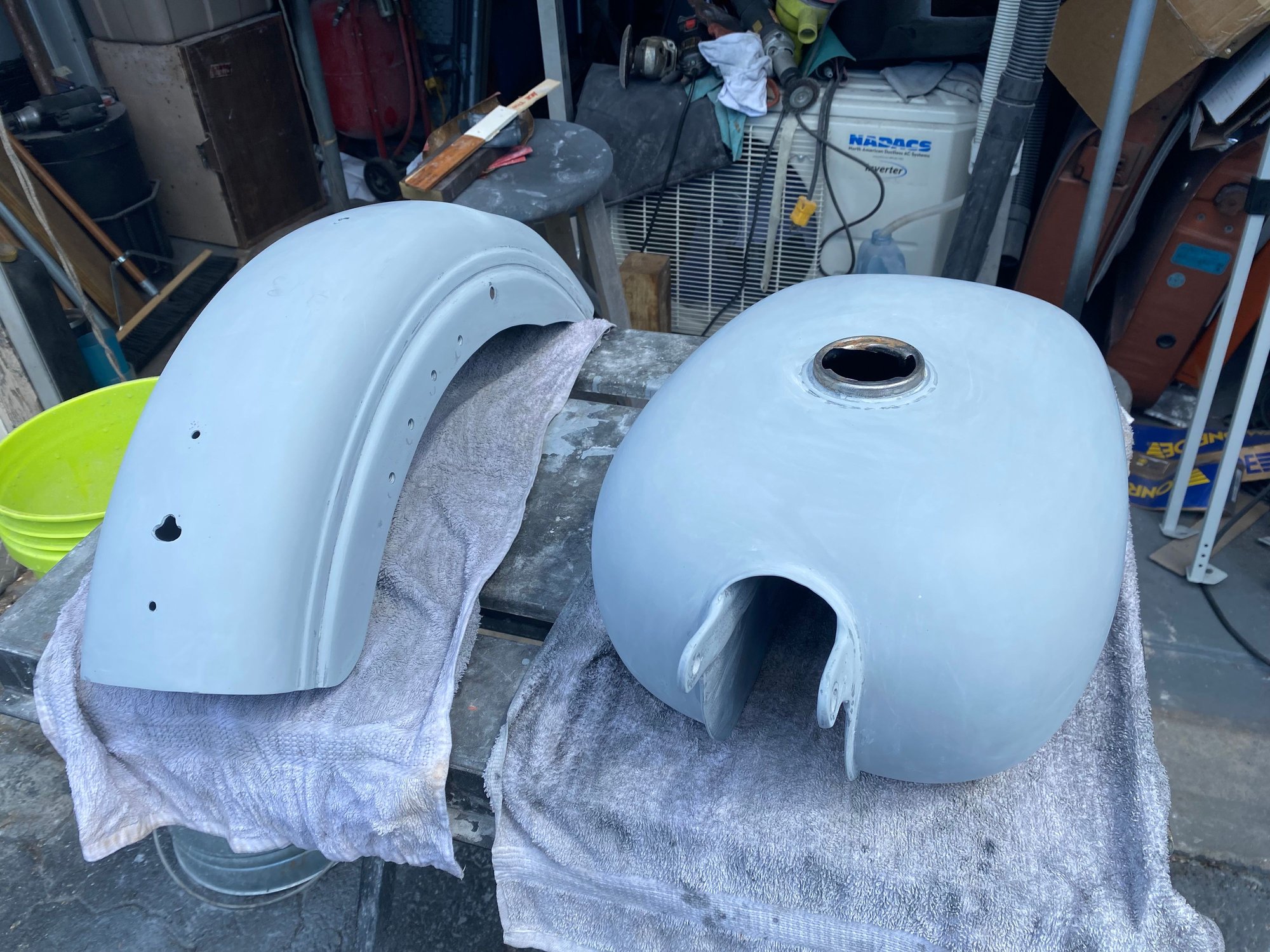

I put 3/4 of an inch up stretch in the down tubes, extended and sectioned the seat post tube and extended the backbone.

That's kind of scary looking.
what did you do for tank mounts?
altered seat fitment, it looks like.

Custom seat, but a lepera bare bones fits also. Cut off the old tank mounts and welded new ones onto a super glide tank so I could mount it a little lower on the backbone.

Looks good.. What year frame?
Thanks, it’s an ‘81. Motor is a 96” S&S, 6 spd OD transmission.

Again very nice.. Last year of the FXE platform.. Did you have to modify the trans mount for the 5 speed.
Yessir, had to cut/ grind a radius to clear the swingarm. Also used a Vulcanworks 5 in a 4 mount.

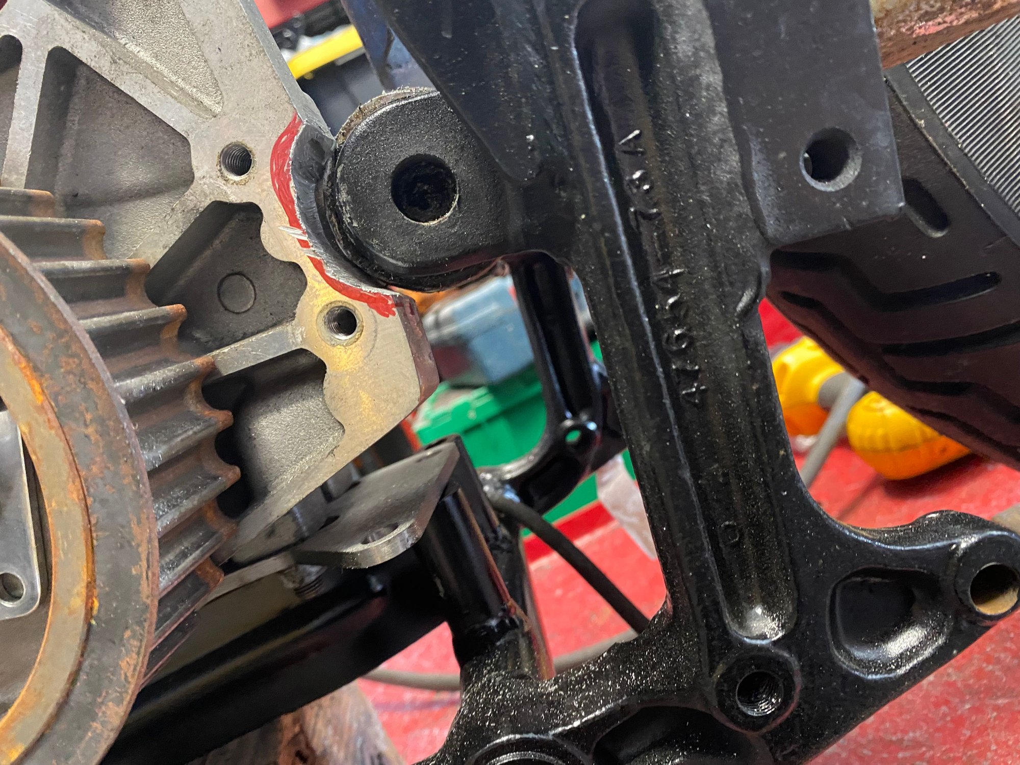

Old Apr 16, 2024 | 04:14 PM
  #39
Krushworks's Avatar
Krushworks
3rd Gear
Joined: Apr 2024
Posts: 7
Likes: 7
From: FL

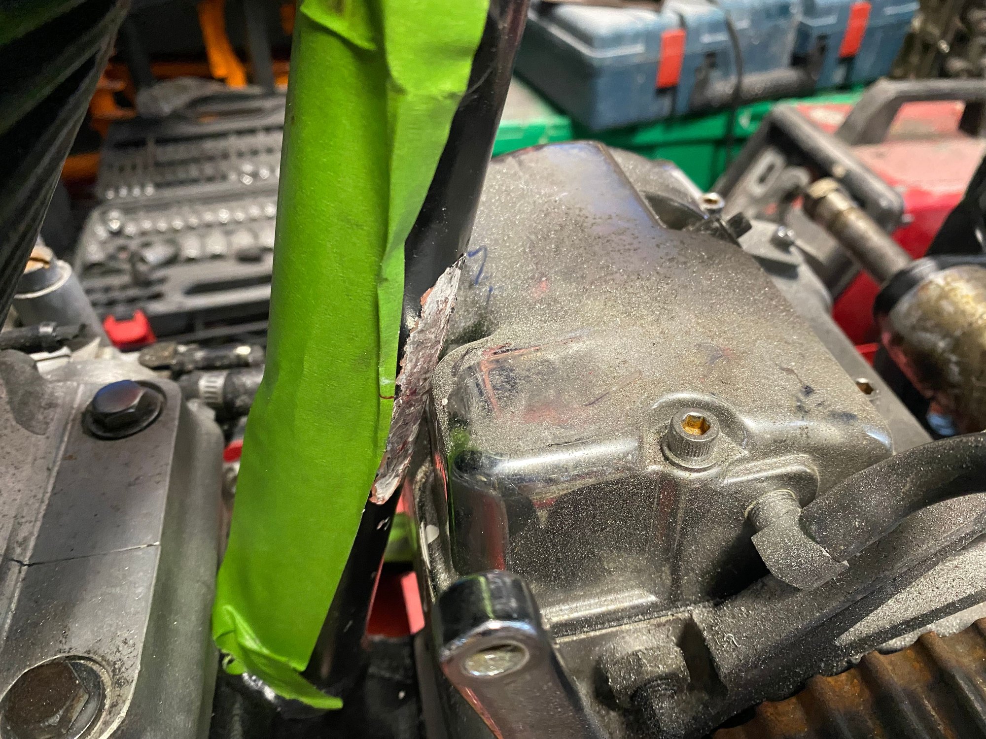

Also had to clearance the seat post tube after I painted the frame:
