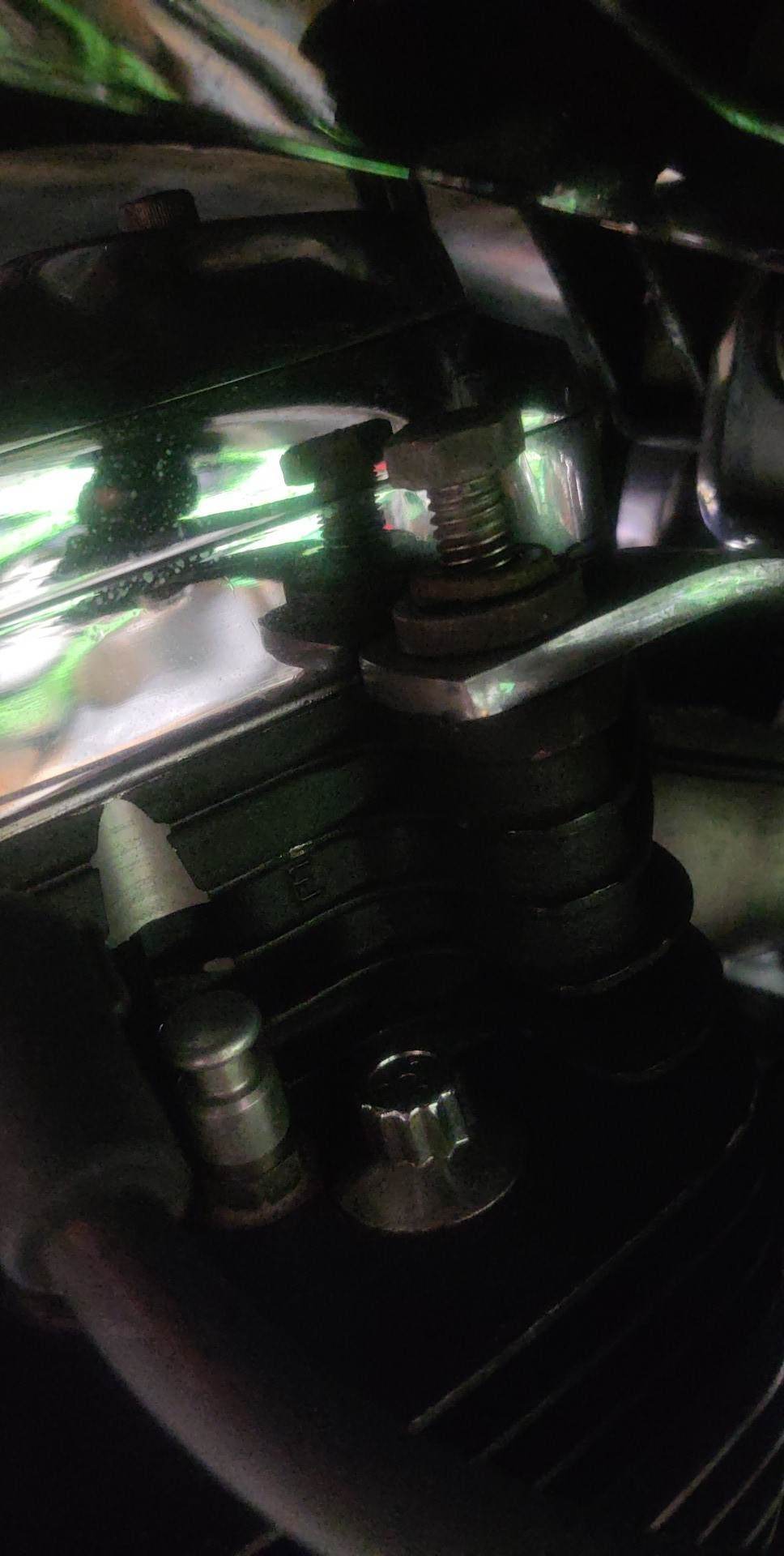

Hey guys , so I got a rebuilt 89" ran all last summer great. Changed oil recently along with rebuilding my mikuni, and ironically I'm getting super crazy vibration at higher rpms now . Was wondering if anyone had any direction on where to look . Thank you.
edit: I did change my oil by using a purging puck to purge out all the old oil. First time using the puck , have done the purging before by taking off the oil line that feeds the oil tank and never had an issue .

Check for cracked or loose motor mounts, especially the top mount. Check for broken or loose exhaust and muffler brackets, too.

Yeap... Not sure how I over looked the upper motor mount but it was loose as can be ! You're the best brother , thank you tommy c
