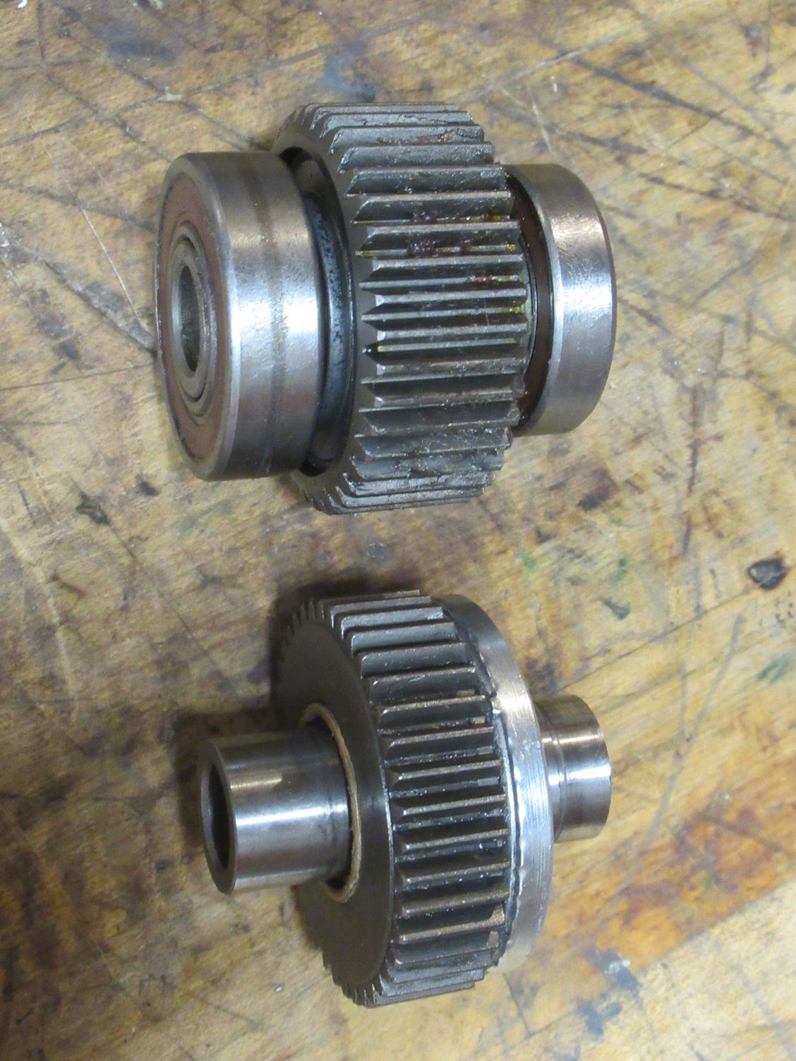

He got me a new drive, and it came without bearings. It wasn't hard to pull them off my old unit and install on the new. There was a spacer ring between the gear and one bearing so I re-used that. Maybe that's my mistake? New unit on top, has full width gear, old one has a tin spacer built onto the gear.
Gears went in OK, and big gear looks flush with the intermediate gear.

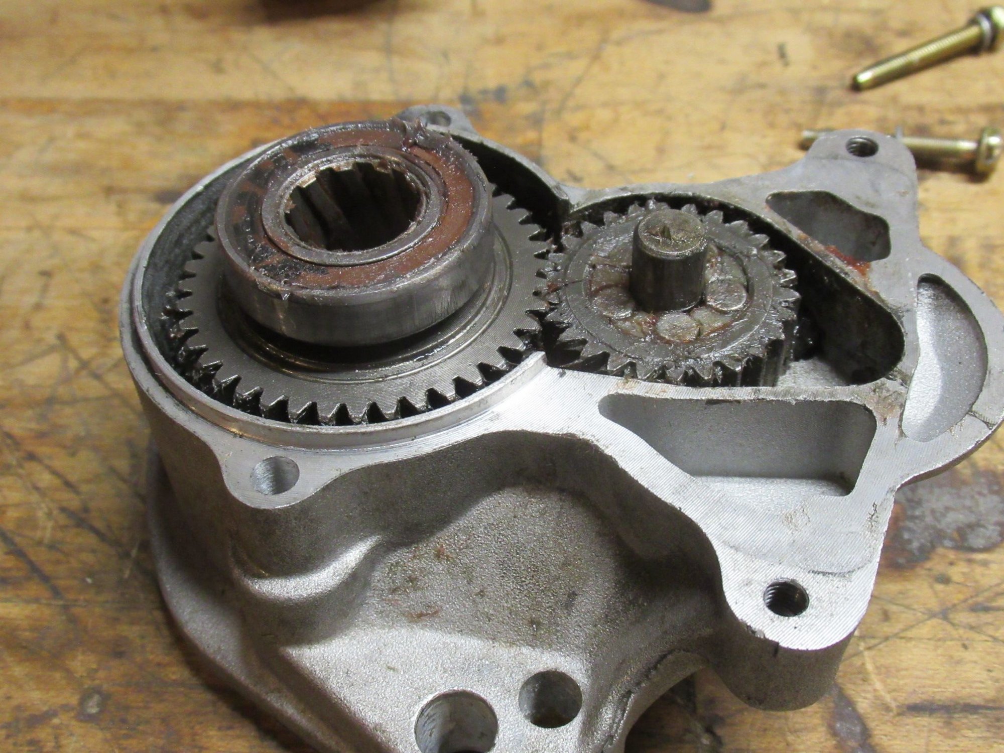

This starter is driving me crazy! I figured out the case problem, the replacement drive was a little longer so I drove one bearing further on the shaft. Got it assembled and bench tested it unsuccessfully. This was a perfectly good starter when I removed it, except for the drive slipping.
Here's what I did: Spare battery neg to case, pos to big post. Jumper from pos to little connector. Kicked once, now won't go. Draws a lot of current though, had a charger on the battery and it pegged the charge ammeter. Disconnected wire from solenoid to starter, hooked battery positive to starter, it barely turns over. Tried solenoid without starter and it didn't pull in. Took off end cover and with solenoid energized pressed plunger and needed to go half way in for coil to pull in the rest of the way. I must be doing something wrong because both solenoids do the same thing.

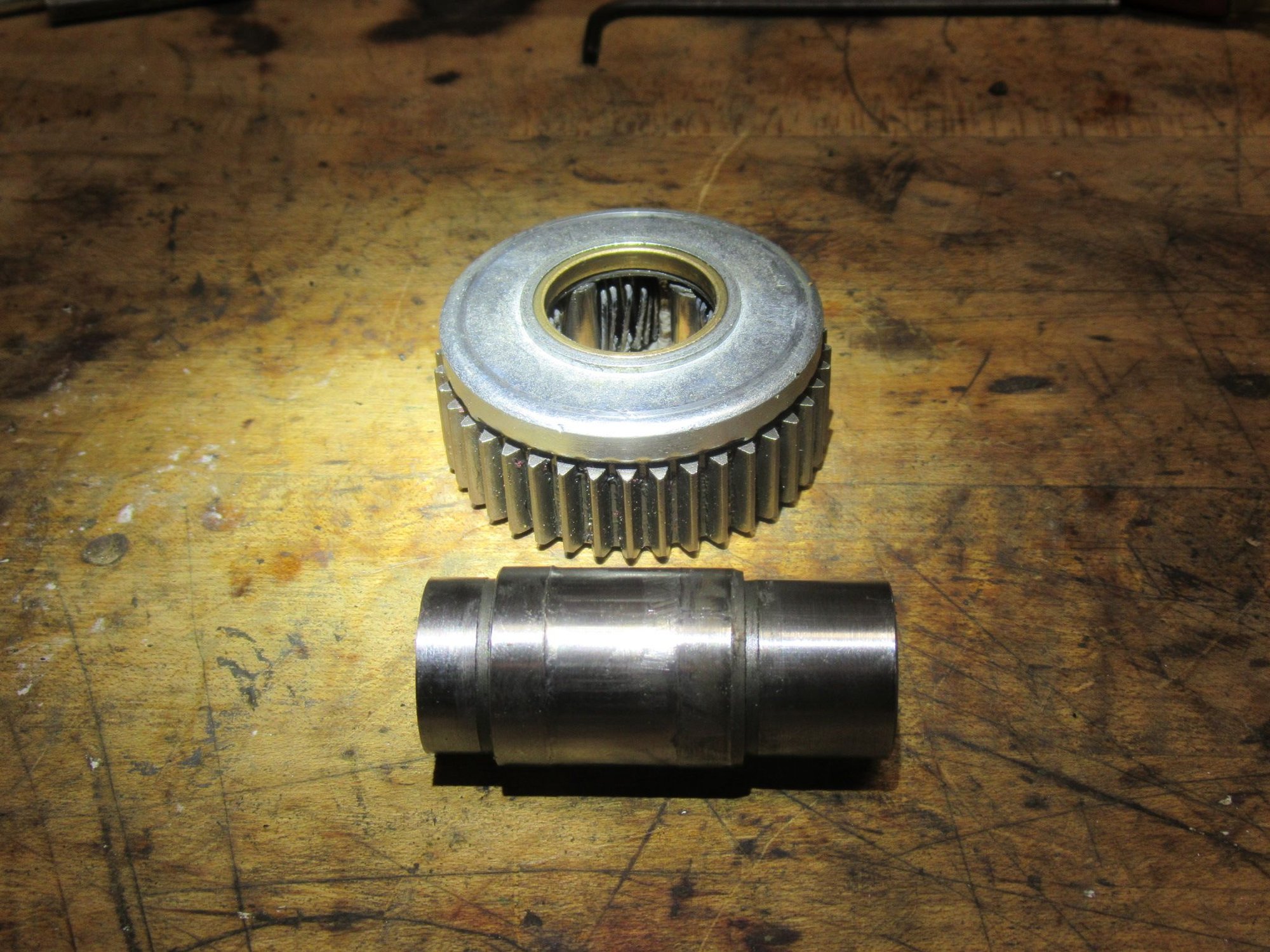

If anyone is interested in what a bad starter drive looks like:

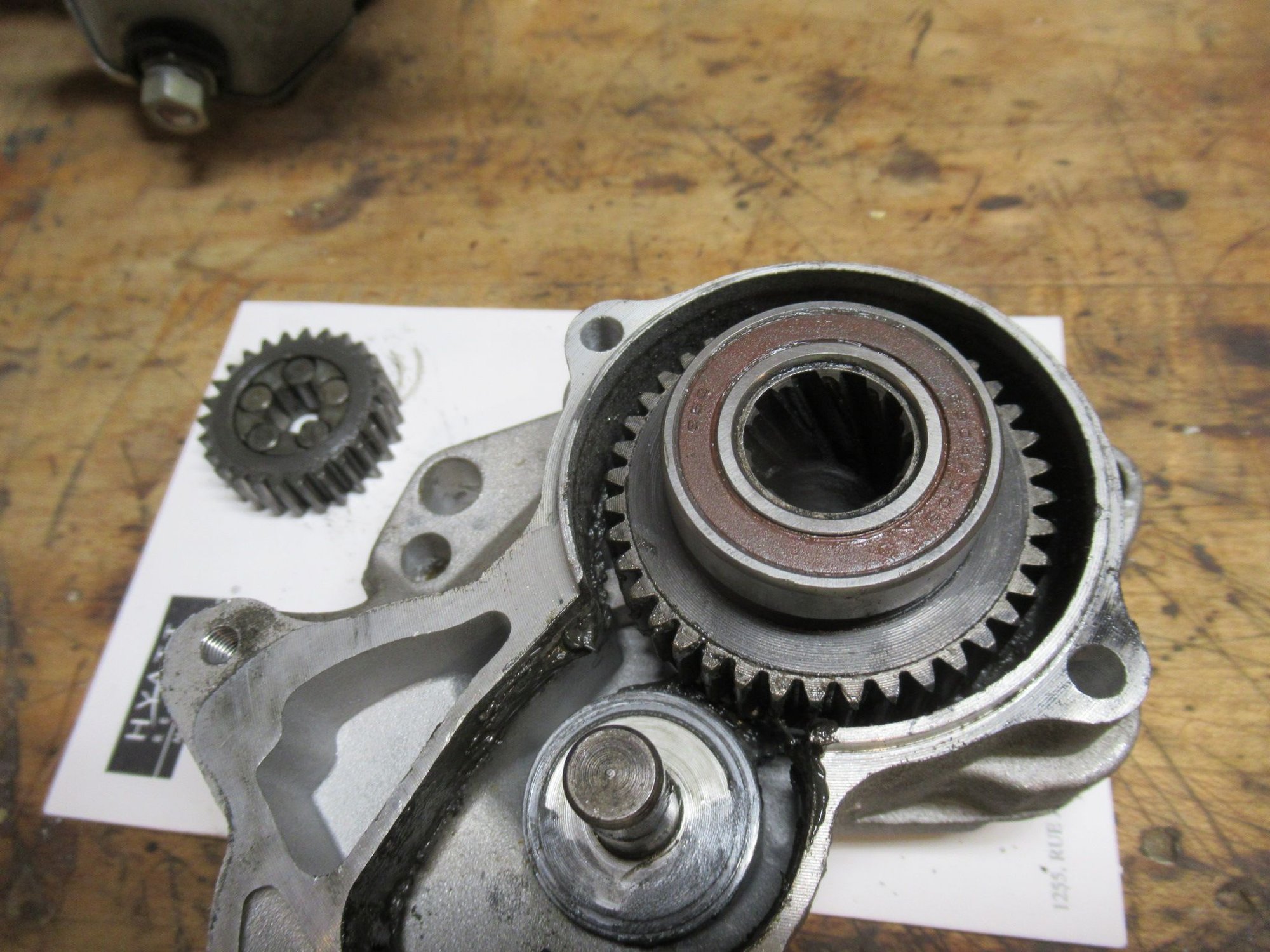

OK, the starter guy said there was nothing wrong, put it in the bike. Maybe my power source wasn't power enough.
After installing it twice (coupling goes in with starter dummy) nothing changed. Still get the grinding noise!
@johnjzjz thought the jackshaft gear wasn't protruding enough, but it seems better now (new starter drive extended out of starter 1/8")
Now I suspect the jackshaft gear isn't engaging the clutch gear. What would cause this, and how to fix?
