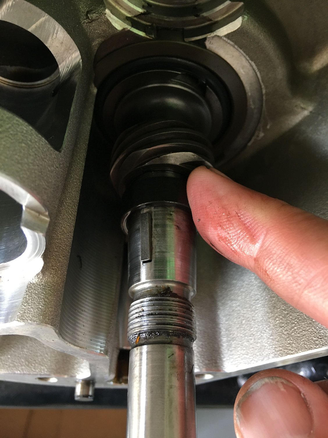

I’m baffled and need help. I’m disassembling a lower end to sell practically new parts; oil pump and flywheel set.
Pinion gear nut came off no sweat but the pinion gear won’t slide off! I’m worried the key has jammed itself somehow.
Anyone have a solution? The new flywheel set was installed by very reputable machine shop (S&S crankcase) just a year ago.

This tool will help as I've bought and used it. You could probably use an auto puller but I was afraid of damaging/breaking the gears. Also, sounds as if you have a solid bottom end, why the breakdown and sell off?

Isn't the pinion gear on a tapered shaft and you need a puller?

yes, S&S has a tapered shaft, but there’s also a key
Pics are of me disassembling gearbox before I bought new flywheel assembly. Can clearly see the woodruff key for pinion gear.

The tool makes it easy, you can poorboy it with a small 2 jaw puller most times if you don't want to buy one. Get a little pressure and tap the end with a hammer a few times they usually pop off. If not a little heat with under pressure will.
