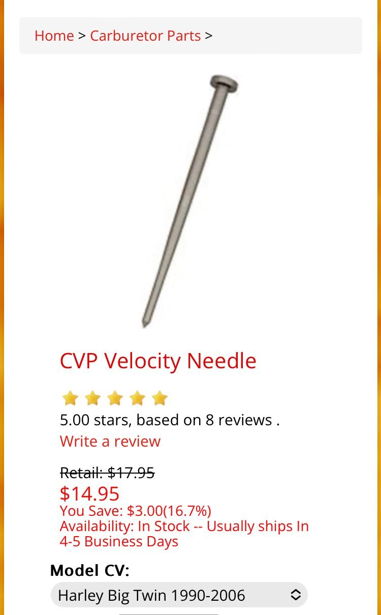

Watching a CV accelerator pump hit with a Wego 3 it puts some fuel in but no changes to the needle have been made for a modified engine, it's running lean in the cruise area, a CV accel pump doesn't bog a stock engine, it won't bog this one. A 50 low jet is enough to run a 90hp engine, the 50 is carrying over into the needle crossover area trying to mask the lean area, after clean up from the 50, accel pump hit, the engine is lean from a stock needle still being present, put a Sportster or CV performance needle in it's a go if no mechanical issues are present.

Is this what your talking about?

Sure is, understand they just market a needle based off a Sportster needle, a CV on a Sportster has no accell pump and the needle is richer to cover it,
