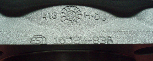

If it's supposedly 95" it would be fitted with oversize cylinders and have had the crank cases bored out also. If you look at the left side case under the cylinders for the serial number, that would tell you if it's an aftermarket case and just above those numbers, look at the cylinders for casting numbers. If the cylinders are stock, it cannot be a 95 inch engine.
Here's what a factory cylinder looks like on the bottom left where it meets the cases.
