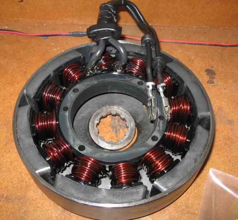

I had a similar issue with my FXDX. In this case, cut down the crank spacer and added a big flat washer on the new rotor.
