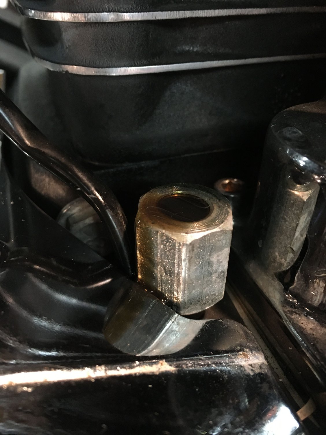

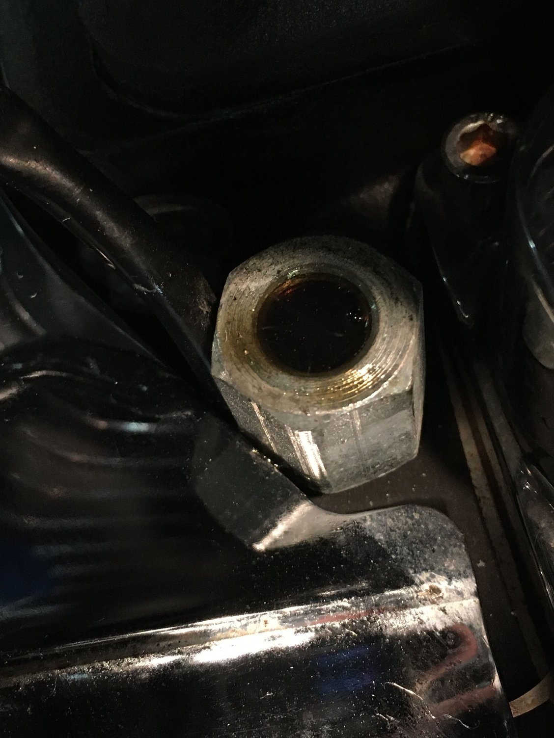

The screen was pretty dirty.. I cleaned it with brake cleaner.. I restarted the bike and the red light stayed off for about 2 seconds.. I pulled the dip stick and then the red light came on.. I didn't see any bubbles in the oil inside the tank..

While it's idling back out the oil light sending unit, see if it has pressure there, they do go bad.

I pulled the oil sending unit to test it.. It has continunity and about 10.2 ohms of resistance. I ran the bike without it inserted for a few seconds and the oil dribbled out.. I thought it would have more pressure.. Maybe the oil pump is not working correctly?
