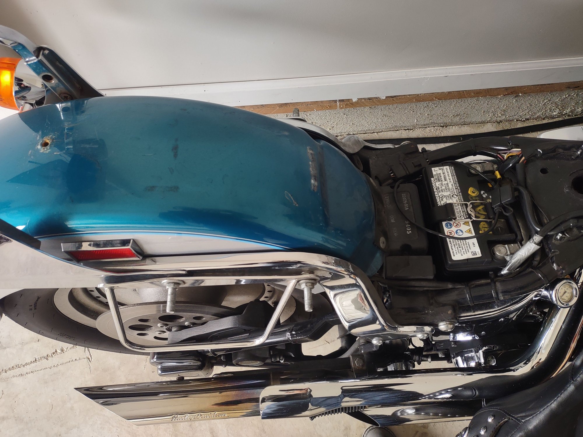

Huh. Mines held on with a regular bolt, and the previous person to mess with it scratched the **** out of the fender.

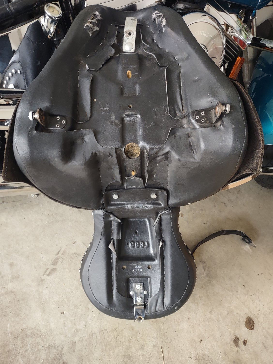

Ok finally got some time to take the seat off and snap some pics. Not sure if this is the actual proper seat for this bike, and the rear is bolted to the front. The front has thumb screws on the sides to secure it, but there is no place on the frame in which to screw them.

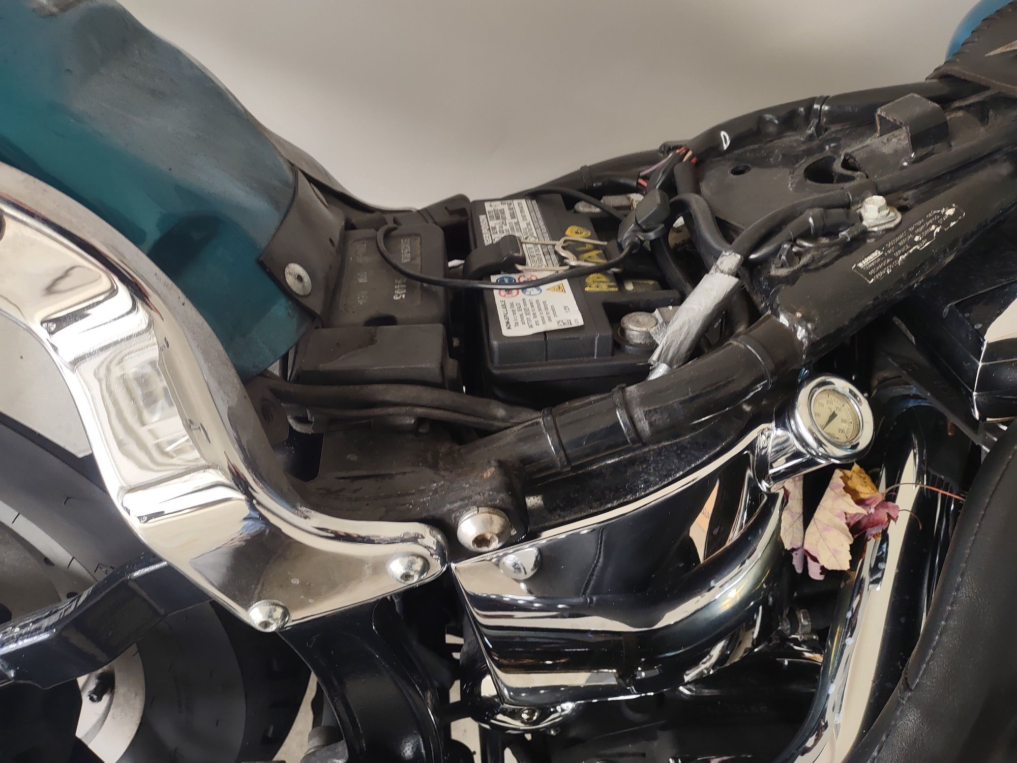

Remove this on both sides, then see if your thumbscrews line up with the holes.

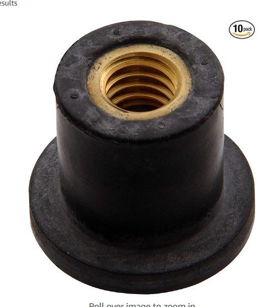

Welp. The thumbscrews deo line up, but the hole diameter is way way too big for the thumbscrews. We're talking 1/4" screws and a 1/2" hole. Leads me to believe this seat is made for a completely different model and PO just forced this seat to work. The search continues!
You probably need a couple of these:
