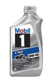

Mobil 1 V Twin 20/50 synthetic is good for all three...but it is pricey.
