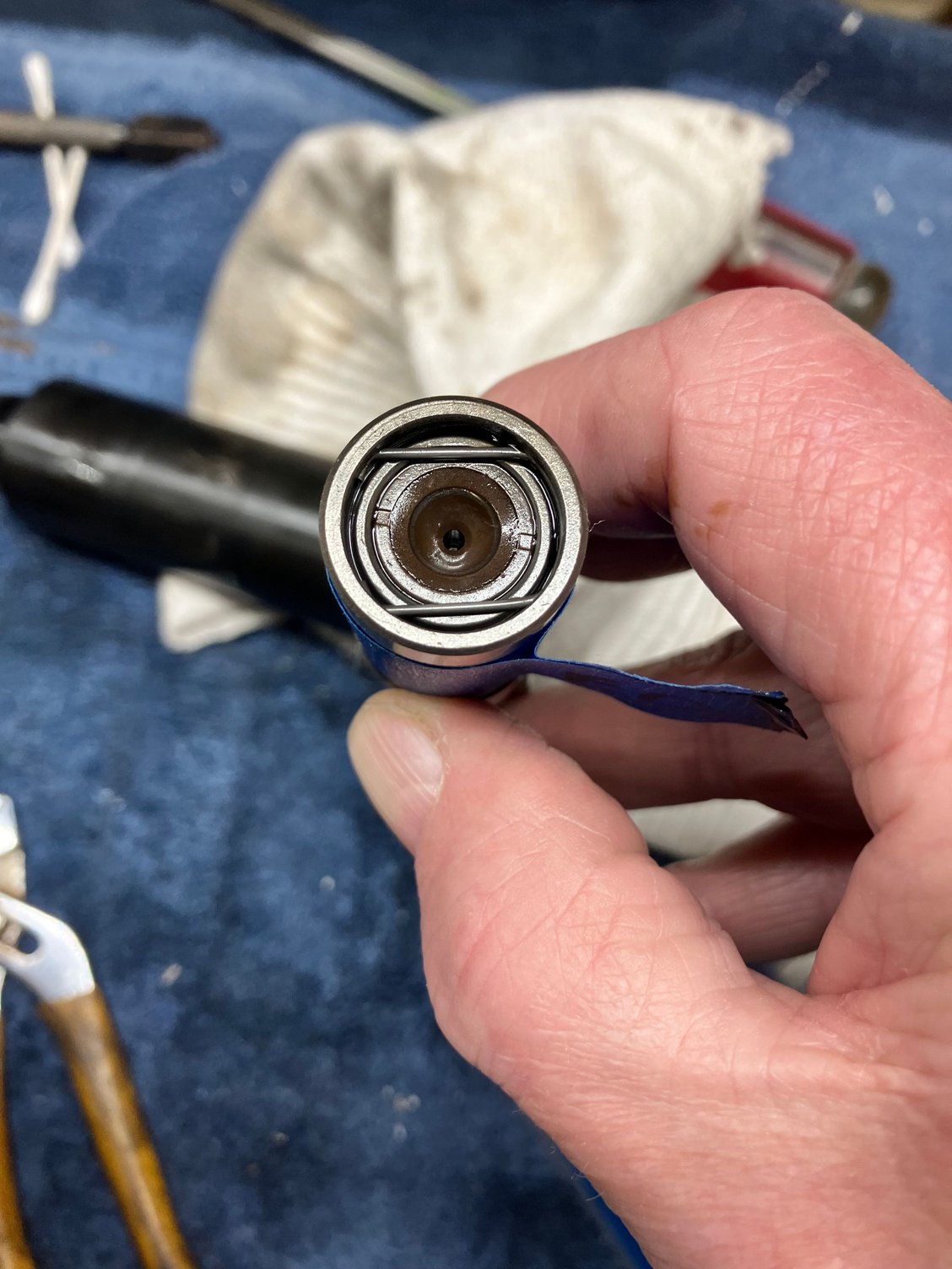

This is what was in it.
Figured is would be A's, while one of the other lads here stated that HD was using the B's on the factory built motors around the 96 and later time frame instead

Yes on the A;s, since it was a problem with how rough HD left the piston sealing surface, that marred the hell out of the sealing valve plate, would cause problems with the lifters not staying pumped up, and this would cause the needle bearing to start to get hammered. So HD advice was to replace the A's about the 20-25K mark like clock work, before the lack of pump up would case damage to not only the roller bearings, but the hardned surface finish on the cams.
Here is an A lifter that was having problems staying pumped up, due to the rough surface on the piston seal surface (caught before the lifter did start pounding to take out needle bearing and cam lob surfaces).
Look left of the piston, to see the smaller valve sealing plate and the marring on it where it seats against the piston seal.
While quick clean up on the piston surface, and flipping the sealing plates to clean side against piston seal surface, had them right as rain for back ups if needed in a pinch.
On the B's, cleaner (debured) piston sealing surface, better needle bearing/better over all design, has them lasting to around the 35K mark where HD suggest they be replaced each time instead.
And as stated, have yet to see an Evo factory built motor that got the B's from the start, and was more of just using the B's when it was time to replace the A's at the 20K mark isntead. So long as the dealer had B's, and was not trying to burn up their old stock of A's instead. I bring this up,since even if factory installed A where replace around the 2000 mark by the dealer, could still be A's.
