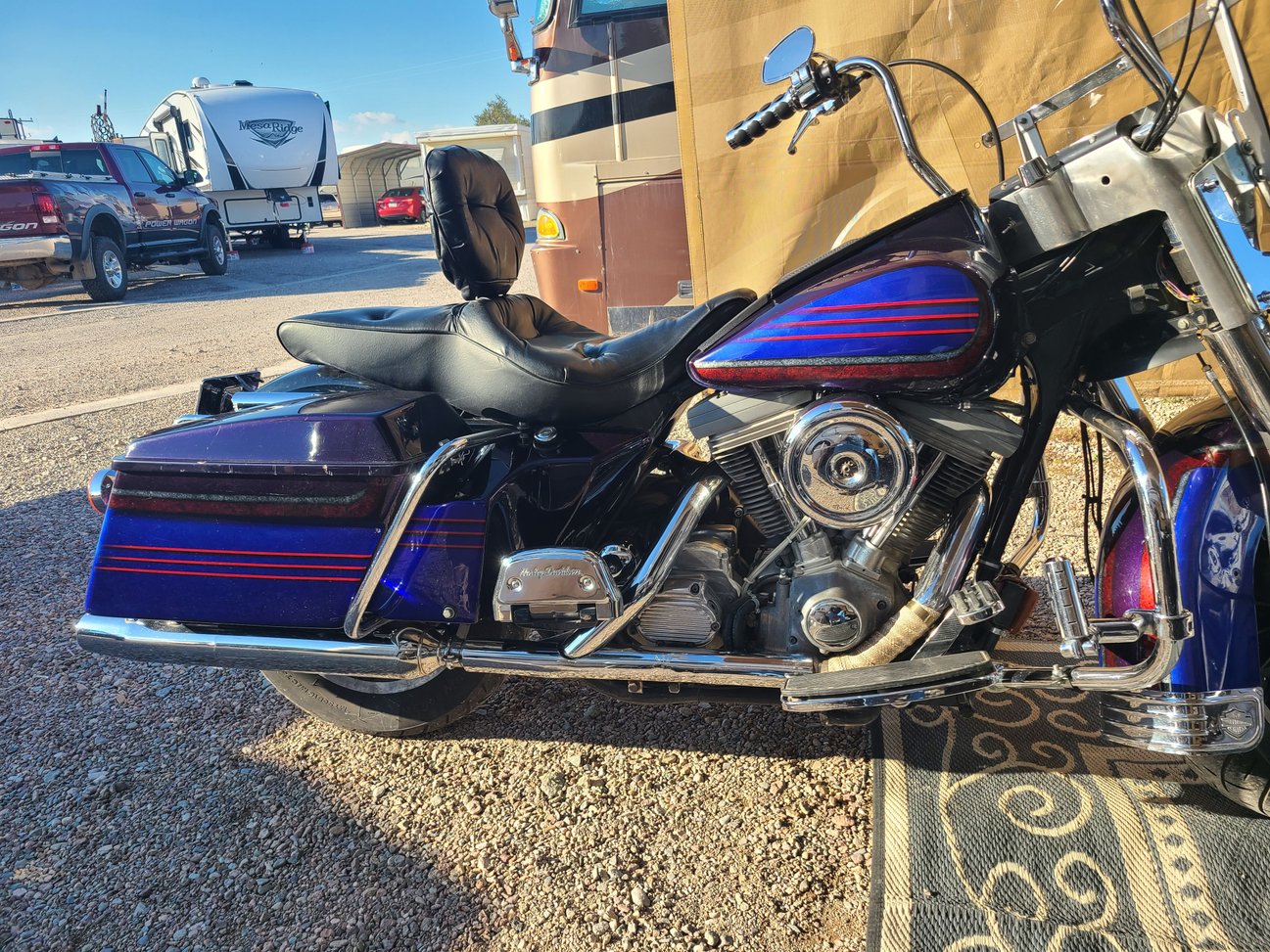

Hey Brother, sorry but you really need to do something with those rocker covers...
Not calling anyone out, but I did look at my valve covers. They're purdy ugly...as compared to the rest of the engine, and her general look.
So what's the best way to get the coating that the Moco put on these off? Most of the coating was mostly off of the other aluminum parts. But the coating that was left was a PITA to get off.

I assume your rocker box covers are aluminum. MoCo clear coated them to keep them shiny, you see how well that worked. I like a wet Scotchbrite pad and lots of man power. When you get it all one color again and smooth, the clear coat is gone. Then switch to Mother's Aluminum Polish. Going to take some time, keep going until your finger go numb, then go for about another hour or so. PITA but when done you will have shiny aluminum. Good luck.

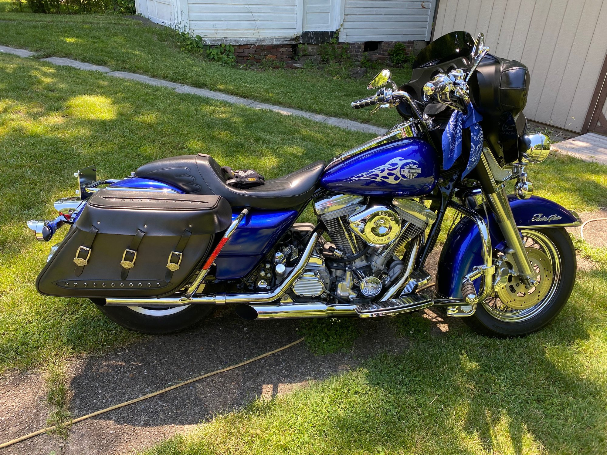

Mine looked about the same as yours. I wet sanded and polished them with Wenol

Great info!! Never thought about aircraft stripper. I guess I'll have to start working on them. I do have 400, 800, 1000, and 1500 wet/dry with me. Gunna have to pull the tank to change the cover bolts gaskets, they weep. Maybe I'll strip them then.
Wish I was in Idaho with my stuff, I used my grinder as a buffer on the trans covers, primary cover, and all the aluminum on the front end. Did the cam chest cover when I changed the pipes.
Looks good!!

Methlyene Chloride will remove the clearcoat. "Bombs Away" will polish'em up real well.

Those don't look chrome, if you strip them you'll just have raw aluminum.
They were suppose to look like that to match the raw aluminum case and heads.
Then a maintenance issue. Just get replacement covers.
2 rocker and 1 nosecone. then you can do whatever you want to the old ones without much downtime.
