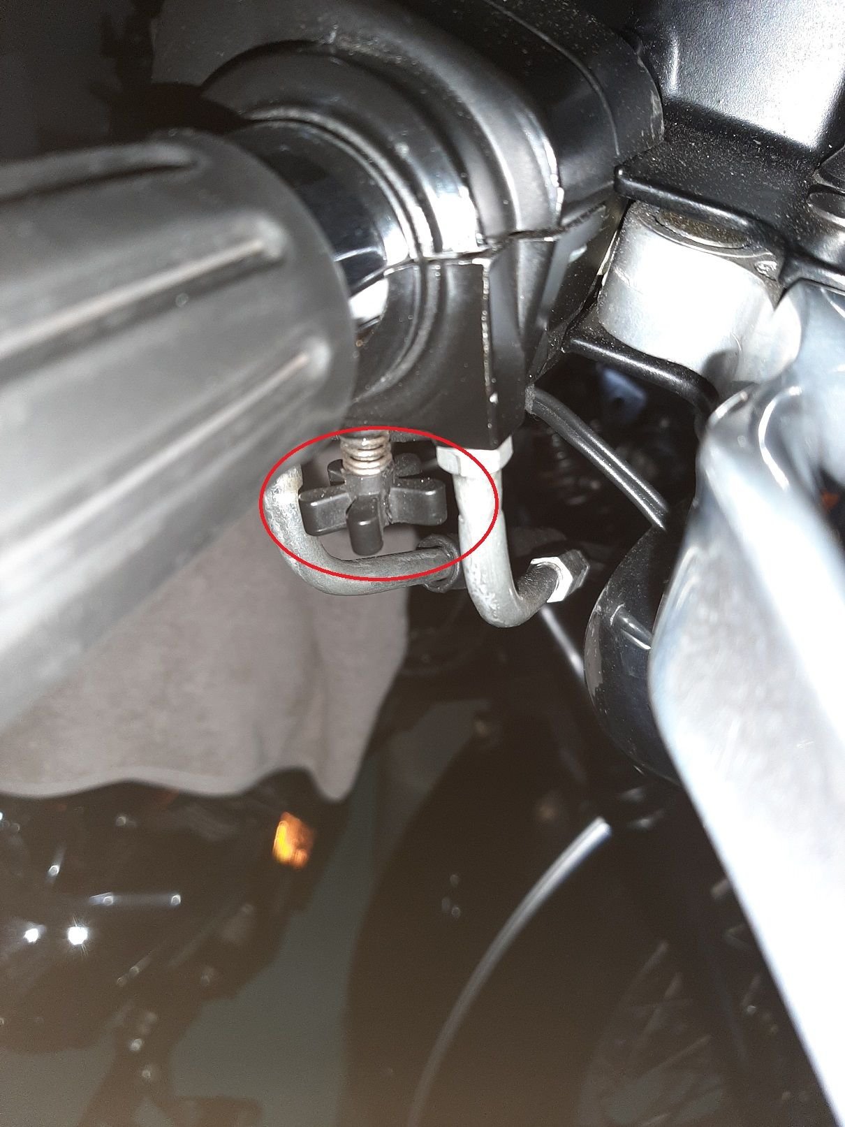

Hi~
While I've ridden evoes more than 10 years except for shovelhead , I find myself not knowing motorcycle structures.
This is one of them.
What is this for which is inside red circle?.
Thanks for answer in advance.

That’s a throttle friction screw.
Used for engine warm up or cruise, tighten just enough to hold the throttle position. You can force throttle closed while going down the road if need be, but usually loosened with your thumb
If someone’s been into the controls that’s not familiar with it, plenty times the friction pad inside is knocked out of position and it won’t work right.

You snug it up to lock up thr throttle for a primitive form of cruise control.

Poor man's cruise control.

Haven't touched it in 10 years, so just leave it alone. It doesn't hold cruise well, and thumbing it to slow down can be hazardous. Ask me how I know? LOL...

Back up system when the Magnetti & Marelli fast idle stepper motor fails or loses it's idle, those Italians thought of everything on the first EFI
They were also used on shovels back in the day.
