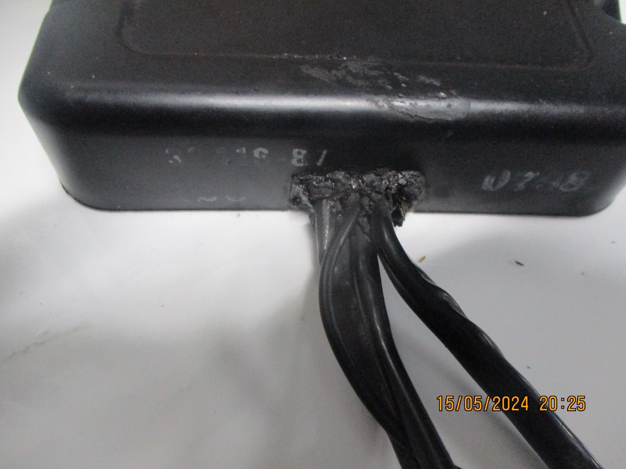

G'day Fellas.
Got the module off the bottom of the oil tank. What a bugga of a place to put it. Yep it's fried.
Cheers
