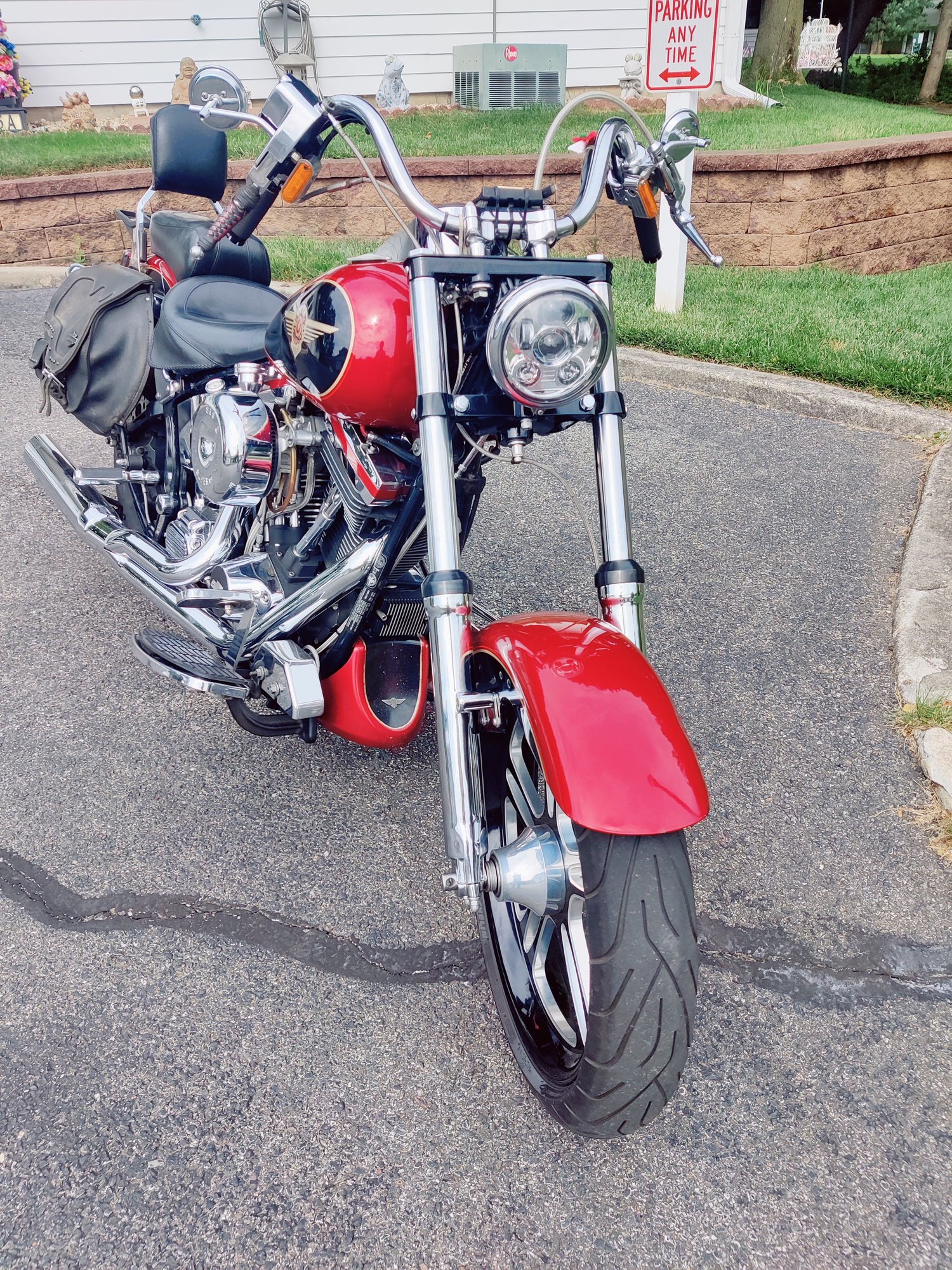

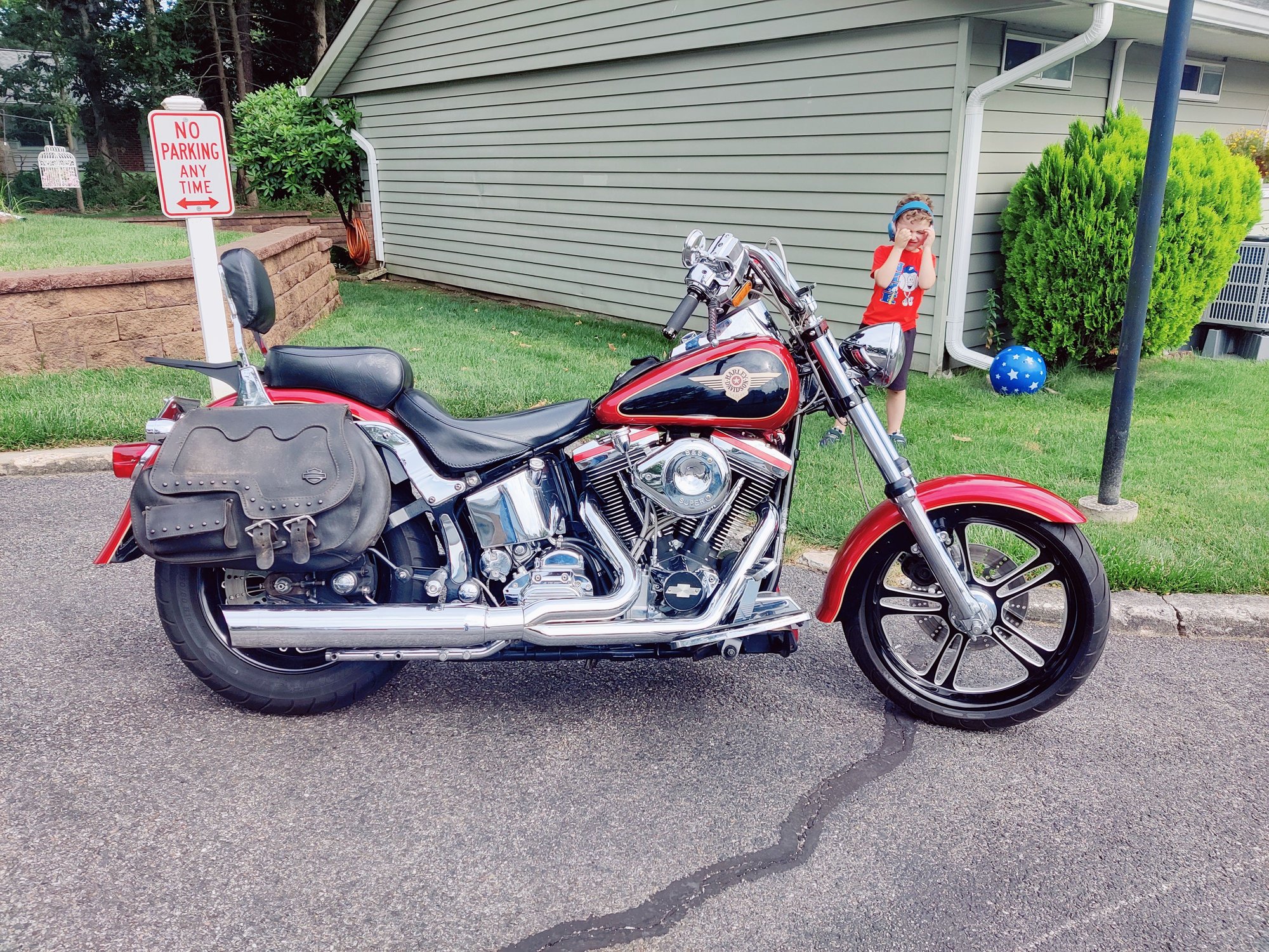

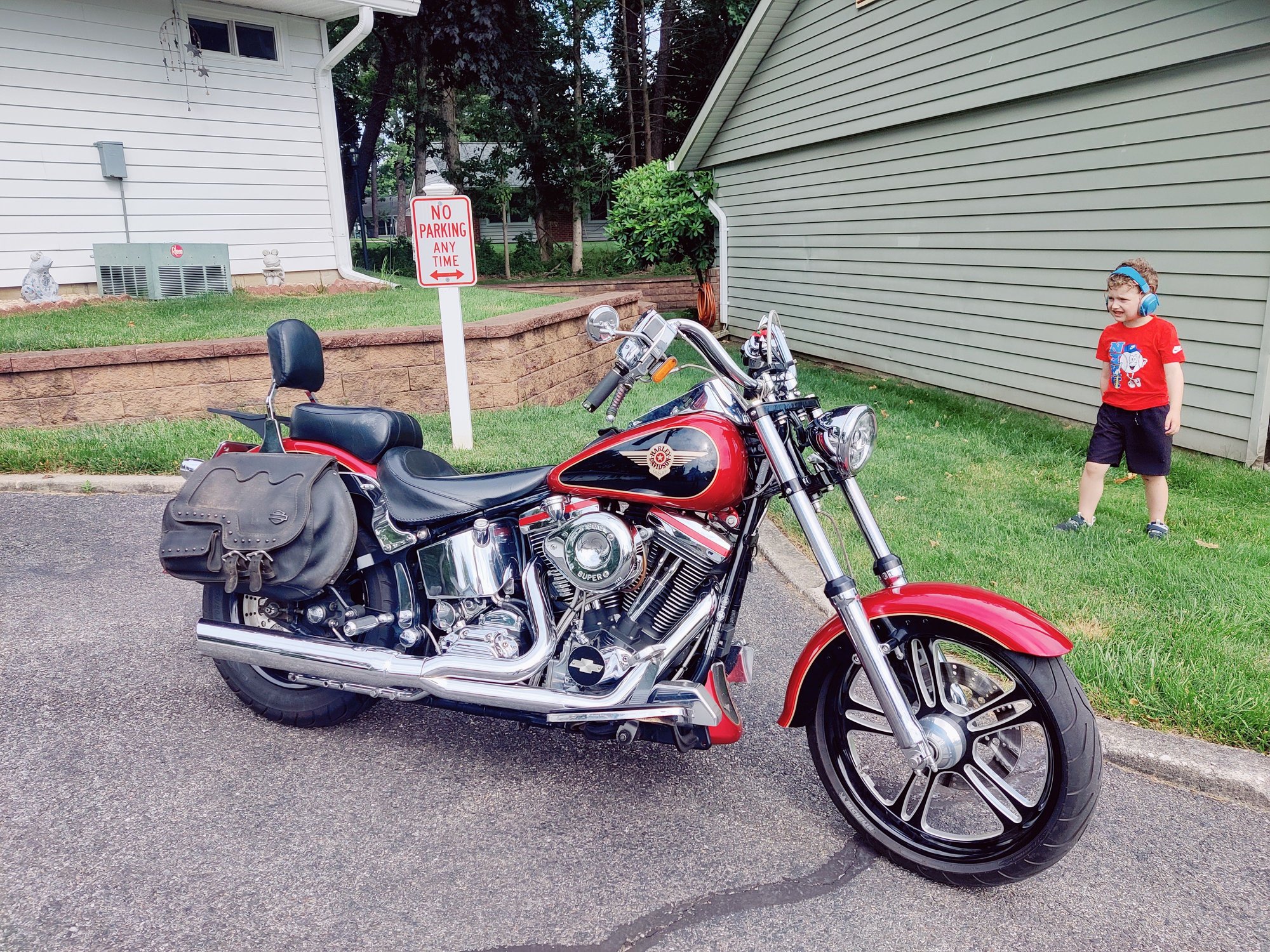

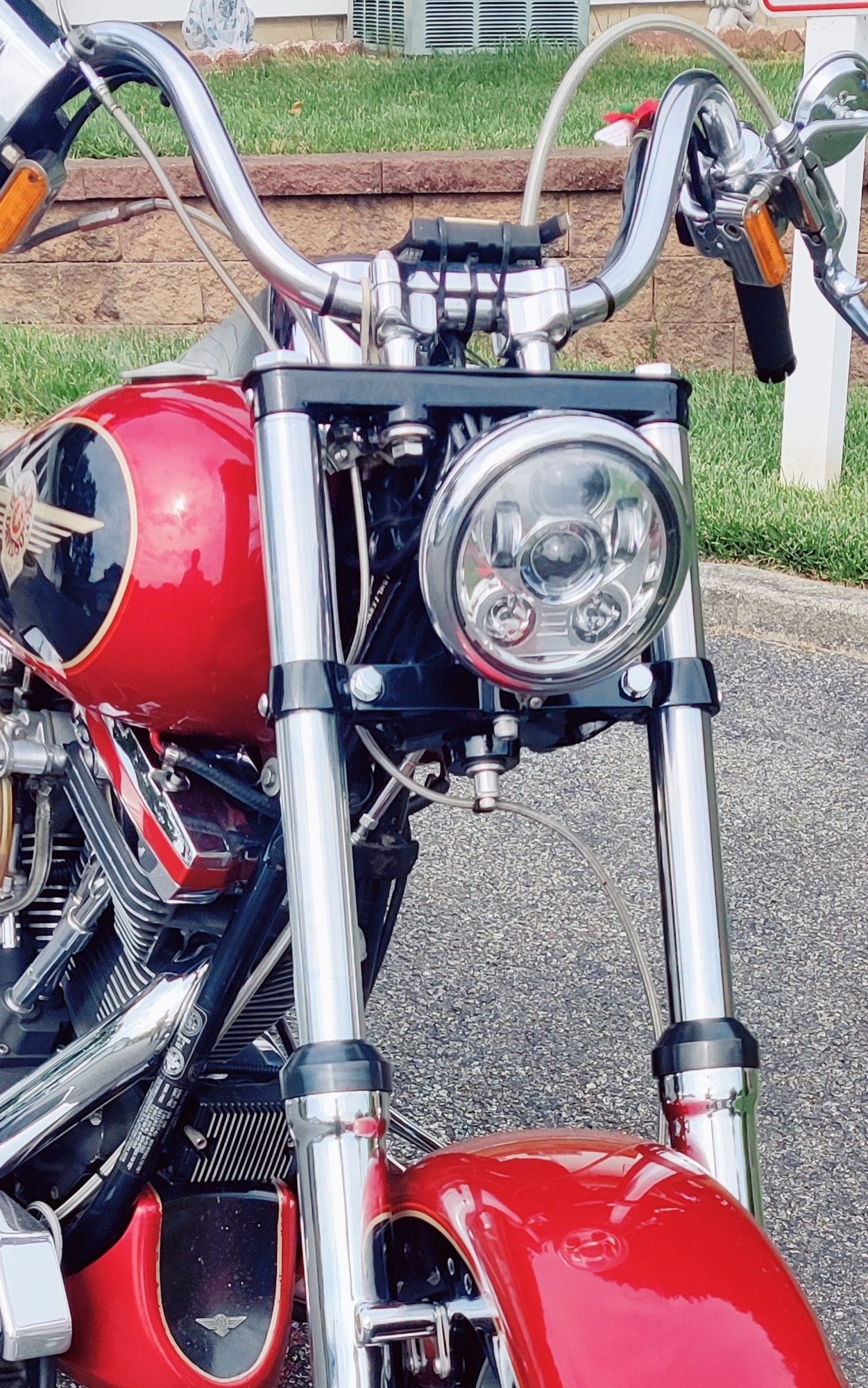

Ok, so I got the front end back together and just to update every one, it's not the stock Fatboy setup.. I have OEM wide glide fork tubes that are 2" over the stock Fatboy.. As all that have been following, well you know about the Progressive cartridge update. They are stated for 2000 up FXST and FXDWG, however they fit the older FXST's and FXGWG's, 84-99.. I used 1 spacer and assembled everything without issue..
The reason I did all this was because of the severe wobble at 100 mph.. The trail was only 4.7" and as I learned, that is no where near enough for this chassis (softail).. Keep in mind though that the Softail Deuce triple trees are what decreased my trail dramatically because of the 1.05" larger offset in the triple trees..
I though a decreased trail would increase the handing as is with the Dyna's and FXR's.. Well that didn't turn out to be the case and is what lead to my severe wobble.. But I didn't want to go back to the stock front end with all the covers behind the 7" headlight as I felt it was part of the issues with wind deflection on to my head and straining my neck at speed on long rides..
I took a little of time to get the rim centered properly to the rotor because the FXDWG front end is a 1/2" wider than the FLSTF but it all came together with out issue..
A note to make now is that my trail is now 6.43", which is great stability at speed but did make the front end a little heavy at low speed (a little and am not concerned about it).. Exactly what increased trail is supposed to do..
So now that it's all back together and I took it out on the road to check all speeds and twisties and for the first time since I've own the bike in 20 years now, I've never felt such a solid ride..
The bike is planted so well to the road that it's hard to imagine a Fatboy could feel like this.. I've never ever felt this kind of stability before.. Also keep in mind that I'm running the 422's on the rear and the suspension is now working in unison like never before..
I can't believe how well it's working and highly recommend the Progressive cartridge drop ins.. I can't say enough about them.. I'm truly impressed..
I really like the way the stock triple trees came out by shaving the lower tree and powder coating.. I gave them some chrome bolts just to highlight the black powder coating a little..
I guess it goes to show that pretty much anything can be altered if you want to take the time..
Now I have to wait till Monday because rain is immediate future... Dang..
Yeah I know it's probably a long post but it's all needed to be said for those that want to upgrade their suspension..

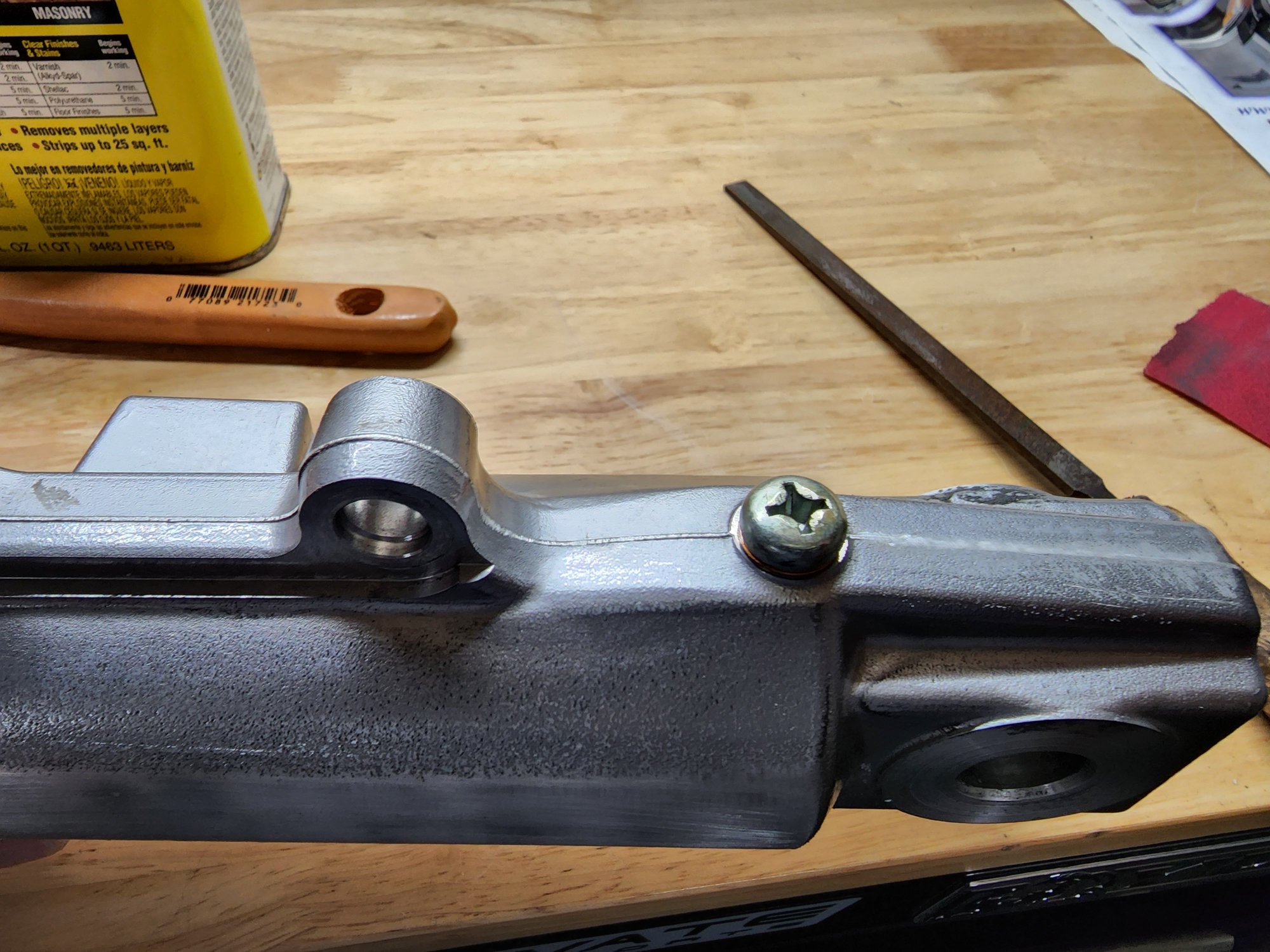

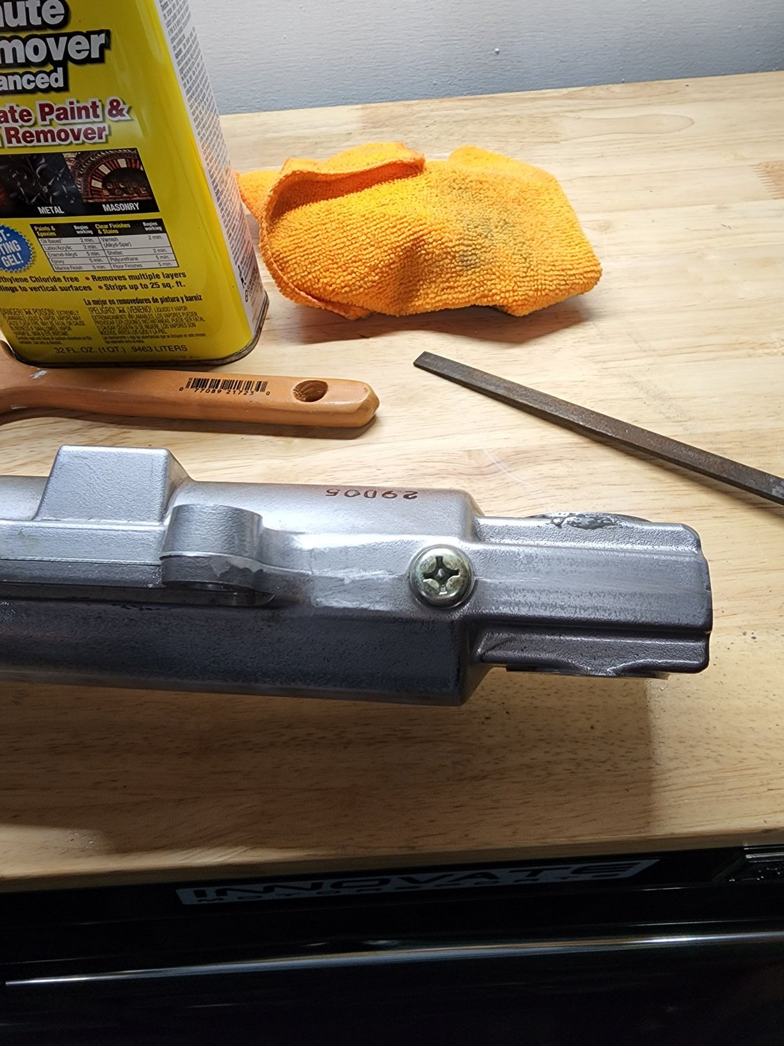

Making some progress. removed casting seams and got the left to 90%. I'll finish it right before it gets mounted.

A file does a nice job to form it then sand paper and steel will to finish it.. Are you powder coating then it just polishing??

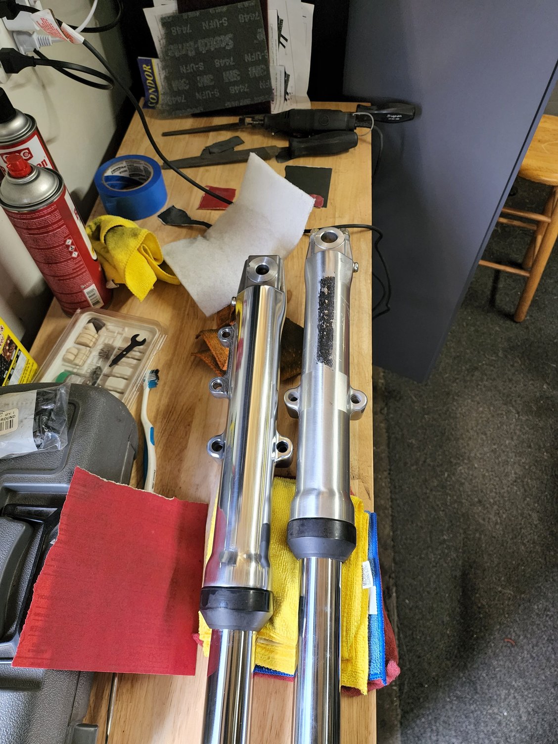

Polished to be polished, not a fan of chrome.
Yep, Three files, three types of 3m scotch pads, 220 and 600 paper, then buffing wheel tripoli then fine rouge. I'll give them a final buff then mount them, after the wheel is mounted I'll do a final with simichrome paste by hand.
