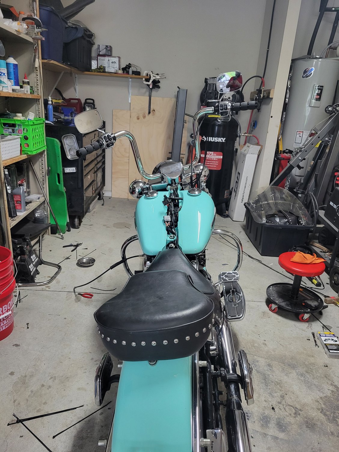

So I think I have all the cables found now, stock bar height it 8" and I went to 12's so I found all cables +4" or as close to i as I could find. Will measure when i get home again to see if there is much difference in the width of the bars as well and add whatever I need to add to length if needed.
Then when I pull the tank next week and take measurements I can look back and see how close I am and adjust as needed. Got to get something to drain my transmission fluid in, didn't even think about having to pull clutch cover when I changed it out the other day.
Figure I would keep all the part numbers I found here for an easy way to look back at them. Found these all on Dennis Kirk
Clutch: 0652-1409 = 66 -11/16" - Stock = 62.8"
Brake: LA-8100B08B = 49.5" - Stock = Dont know its hard an soft line
Throttle: 06-0268 = 35.5" - Stock = 29.5"
Idle: 06-06269 = 35.5" - Stock = 29.5"
Wiring extensions: probably order the Namz 6" with ends or 12" and I just solder them on so I have plenty of slack
Clutch Cover gasket: 266144

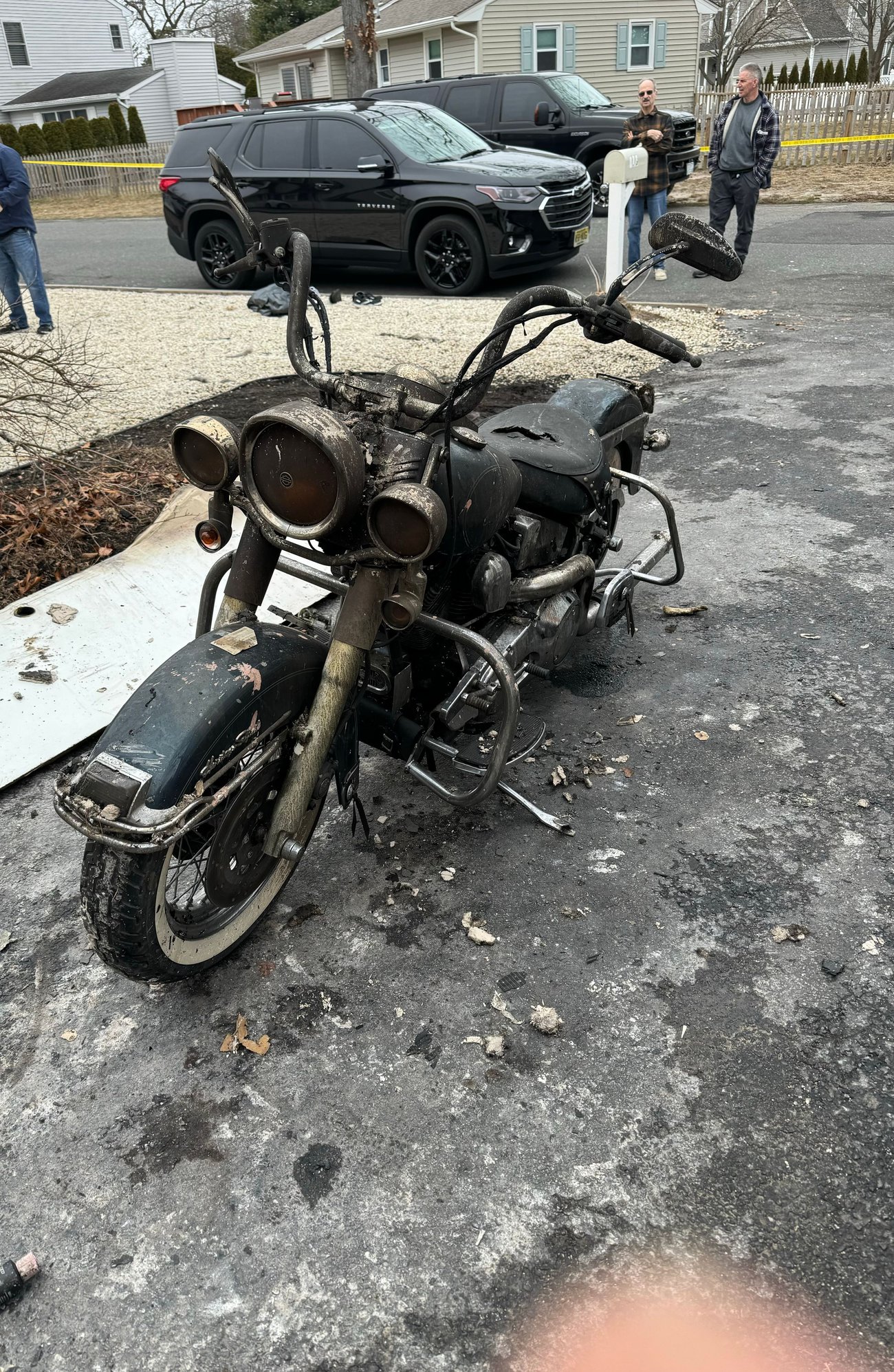

Good luck with it, beautiful bike. I bought mine on January 8th 29,000 miles for $4500 I started putting my add ons right away but unfortunately on February 10th my house burned down and it beat the bike bad, wasn’t even registered in my name yet. Going to rebuild.

Man that is sucks, that bike looked sweet.

I almost got my bars all the way put on yesterday. Everything but bleeding the brakes and installing clutch cable. Going to bleed brakes after work today and do the clutch cable after work tomorrow.
