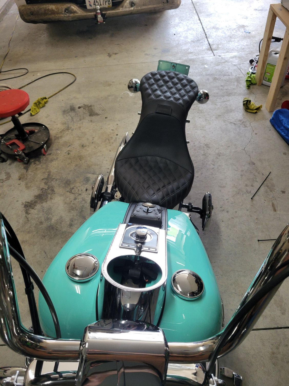

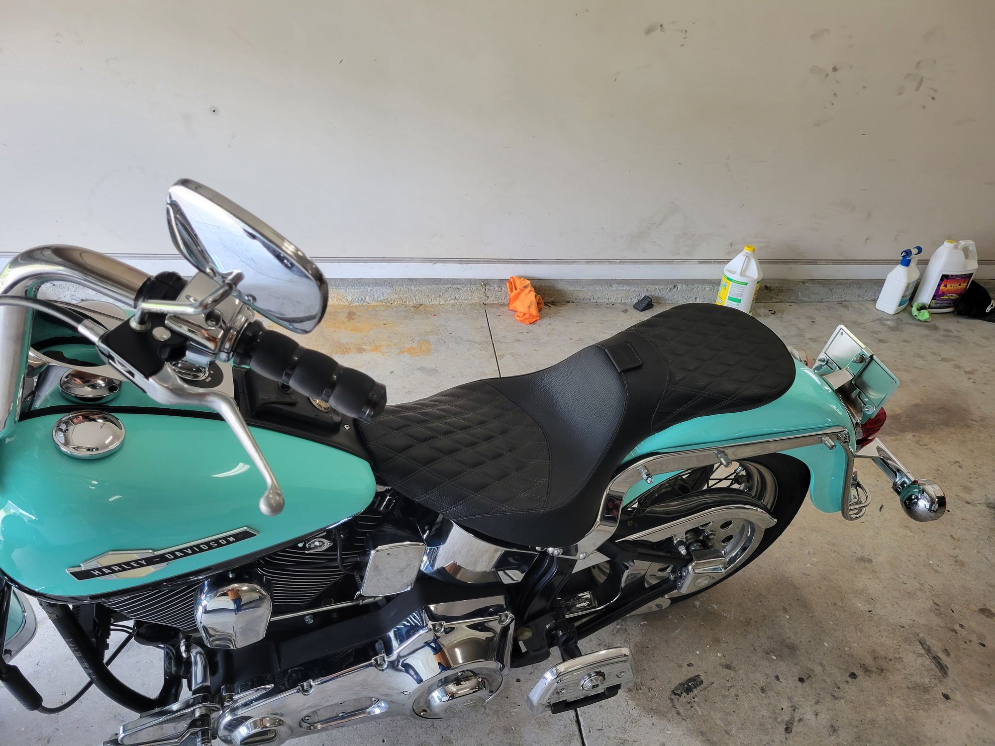

Got my C&C seat in today, forgot how stiff they are out of the box.
Hopefully it will be broken in by the time my speedo gets back and I go off on some much longer rides.
Been keeping around town and the back roads guesstimating my speed.
Seats looks really good, just need the backrest now, added the insert to the seat so I can add it on.

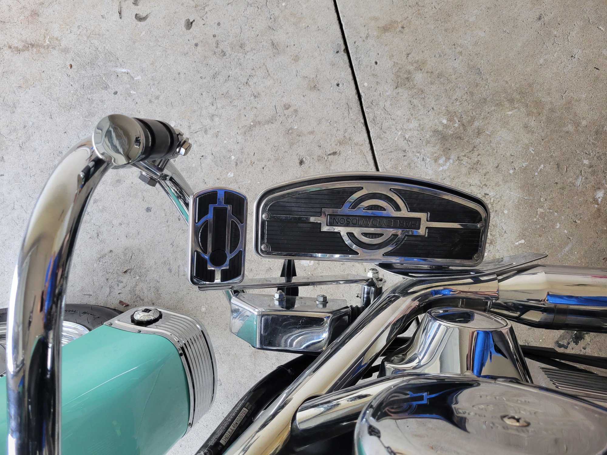

Was leaking all the tan goop off cam sensor, so ordered the dynatek 2ki.
Installed it today, wasnt too bad but did take a few tried to get timing right. With correct mark in window it would not fire and dynatek bolt holes wouldnt line up with threaded holes. Guessing I was on the down stroke.
Turned tire over a few times and then out finger over front plug hole. When i got air pressure pushing my and line in hole I got dynatek lined up.
After that and getting light to just turn off I tightened it down a d set dip switches. Fired right up, set it for curve 2 since I am completely stock.

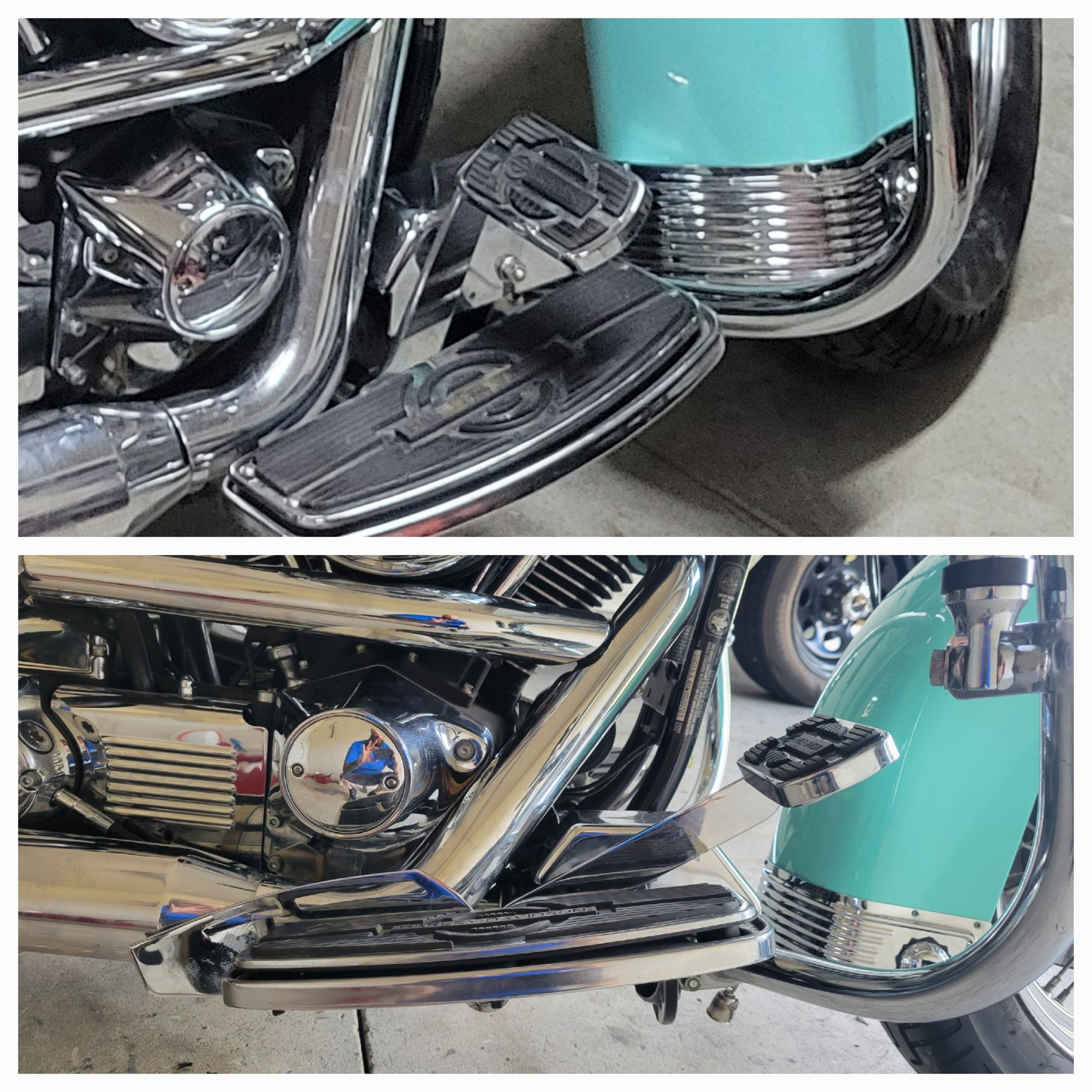

Also got my longer and lower brake pedal on yesterday. It is in an amazing position compared to stock. Looks just like where my 18' RG brake pedal sat.
Waiting on an update from vtwingoodies for my board extensions, been a week with no update so I emailed. So I waiting on a response, if I dont hear anything by tomorrow I will have to file a paypal claim would be 10 days since ordering.
Brake pedal is vtwin mfg #23-0241
