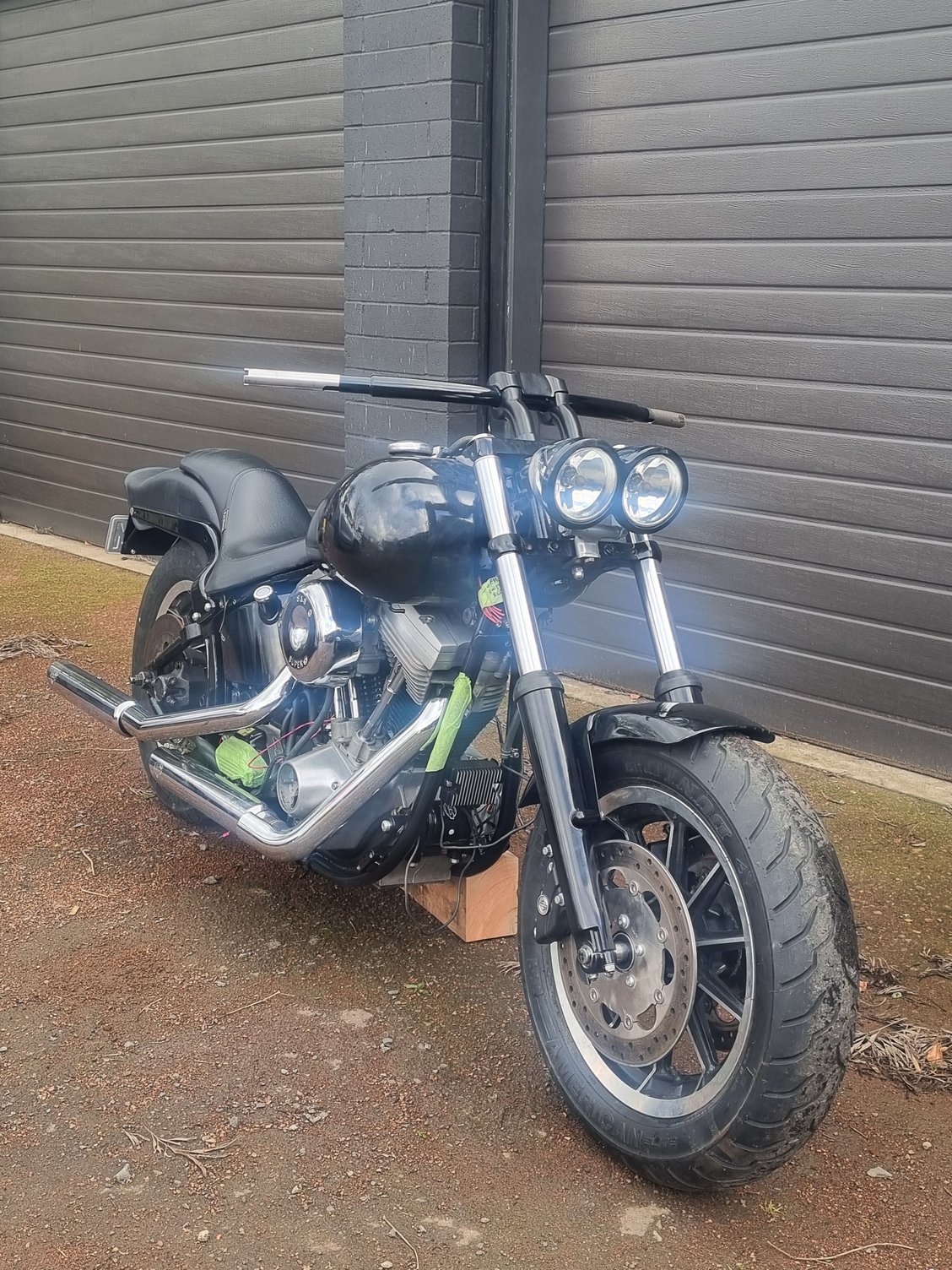

Some progress, 2021 master and clutch perch mounted on breakout 11/4" bars. 2014 Fatbob headlight

Somewhere in America, somebody is outraged at what you have done here...excellent!!! Looks great!
