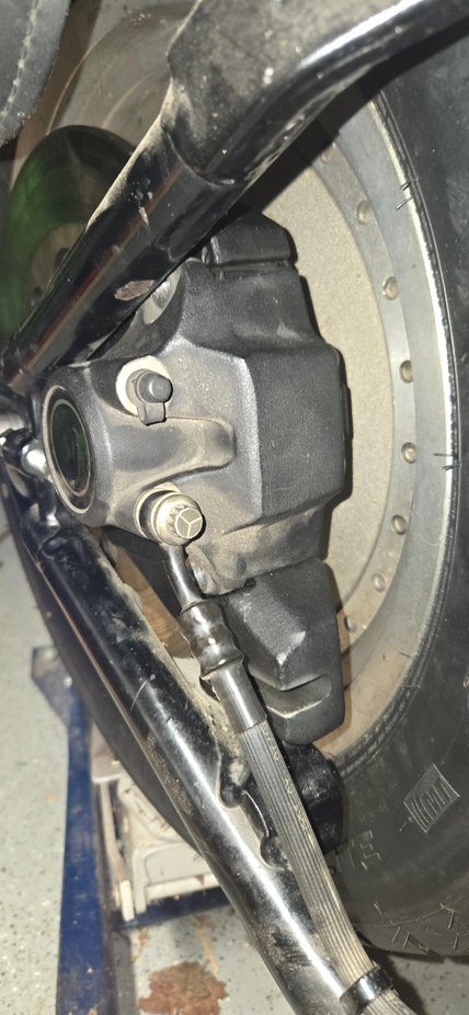

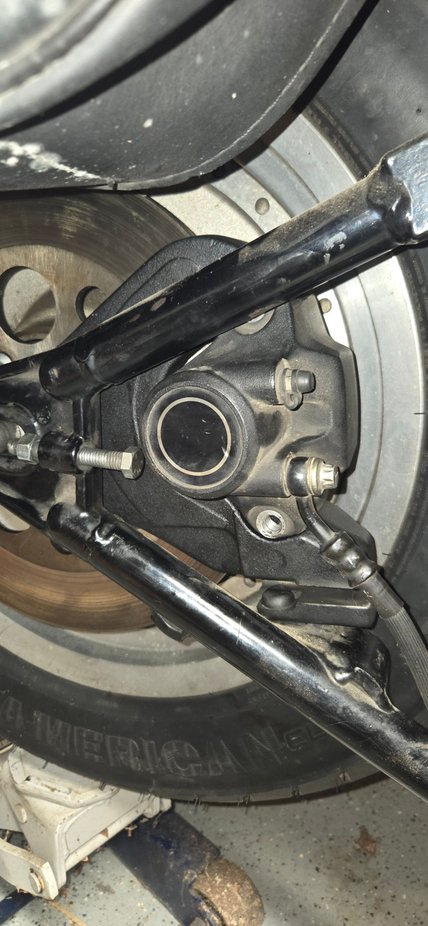

So... I'm looking for a snap of someone elses Gen1 softail rear brake setup for reference, or you can tell me i'm a dumbass and have the mount in backwards or something. I don't care. I just want it back on the road.

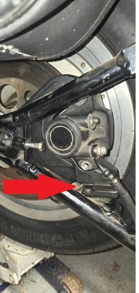

Ref the red arrow.
That slot must be over the mating area on the swingarm lower tube, the caliper must be rotated down farther.
You will need to remove the axle and wheel, put the caliper into position, then reinstall the wheel etc.
And next time you need help, try not to be a dick.

Thanks Dan. I'll give it a shot in the morning. I appreciate it.
