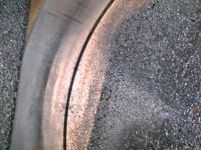

The 95 Dyna was advertised as a parts bike, and that's all it was. I was hoping to use the motor and trans, plus some minor parts like mufflers, to easily fix the Springer. The 95 motor also needs a rebuild, so I passed on buying it. First thing I did was pull the plugs, and they came out oily and caked with carbon. So I looked inside with a camera and this is the good cylinder! The front one was near TDC and the piston top was fully carboned. No idea how many miles, it's a digital odometer, and from the looks of it the LEDs are toast, a common problem. I didn't even bother to try and turn it over, thanked the guy and rode home. It was a nice day for a ride.
So my plan is to continue teardown, removing the entire drive train. A local shop owner that I have become friendly with says the trans probably just needs to be disassembled and cleaned up. Maybe change the main bearing while I am there. I'll see if I can get the jugs off the studs, and then assess the lower end damage. If need be, he can get me a good black and chrome motor from a shop for about the same as the Dyna would have cost.

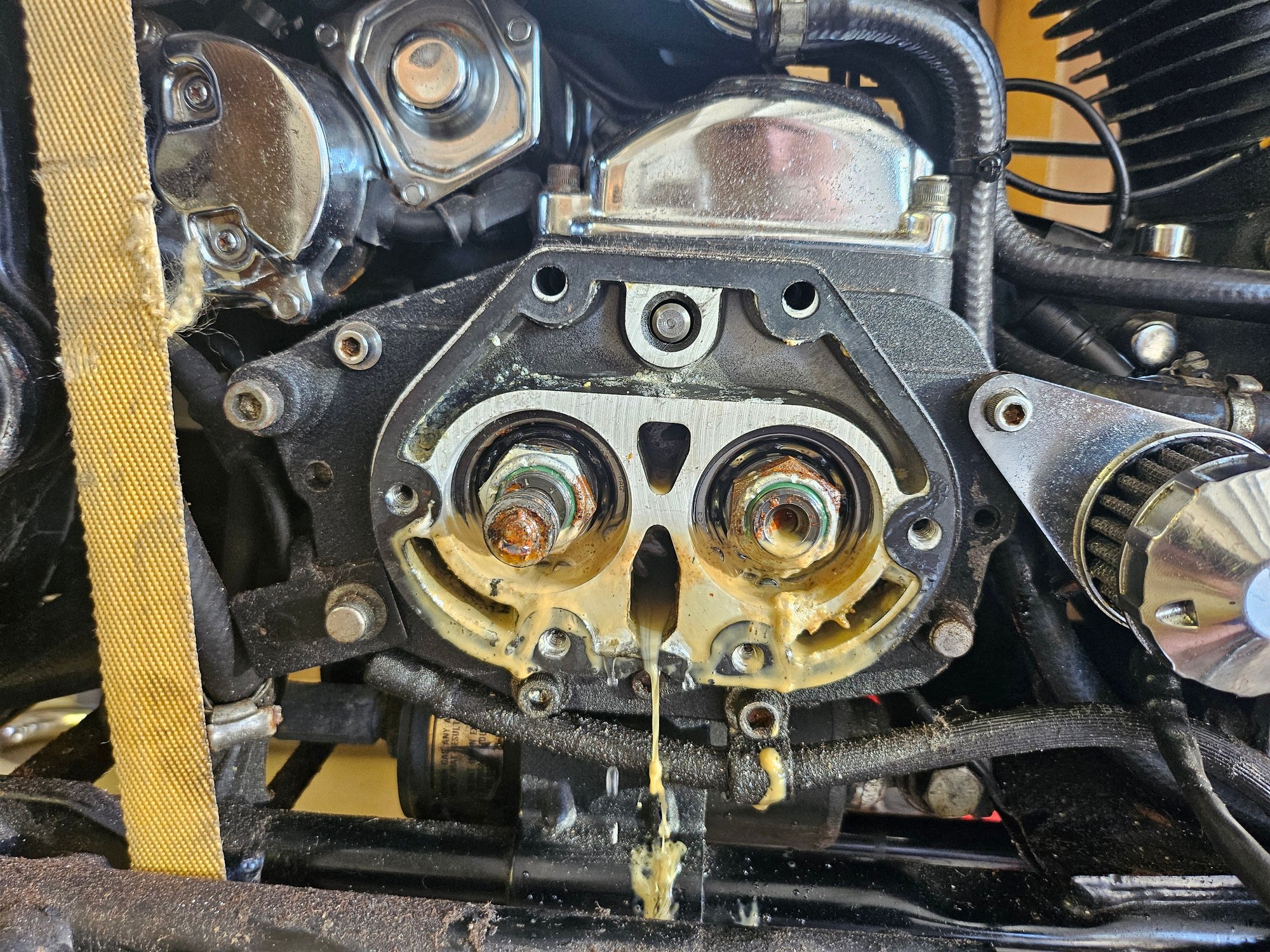

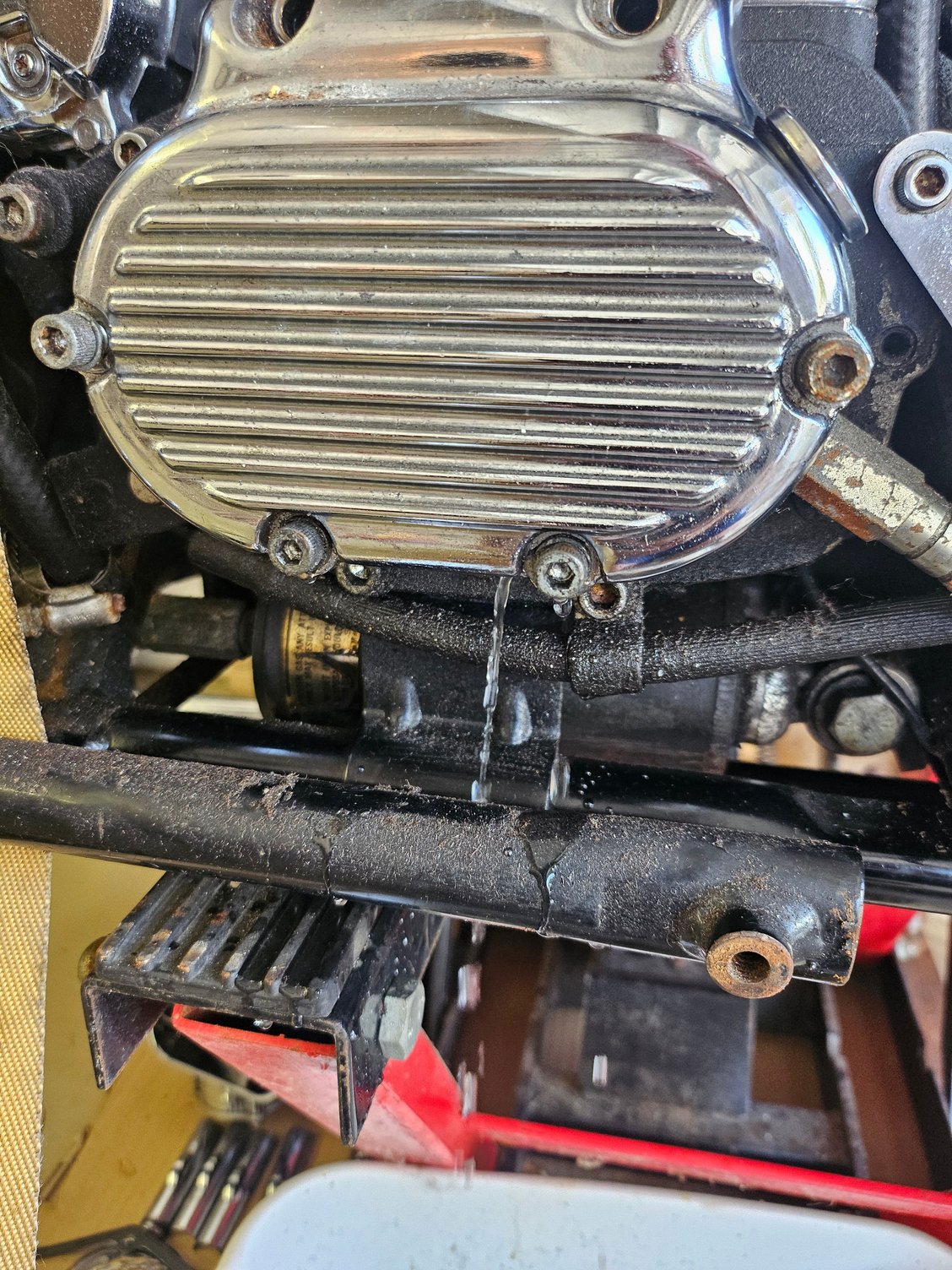

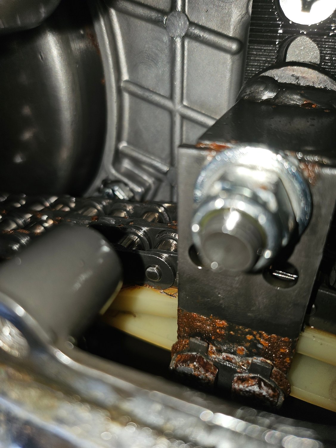

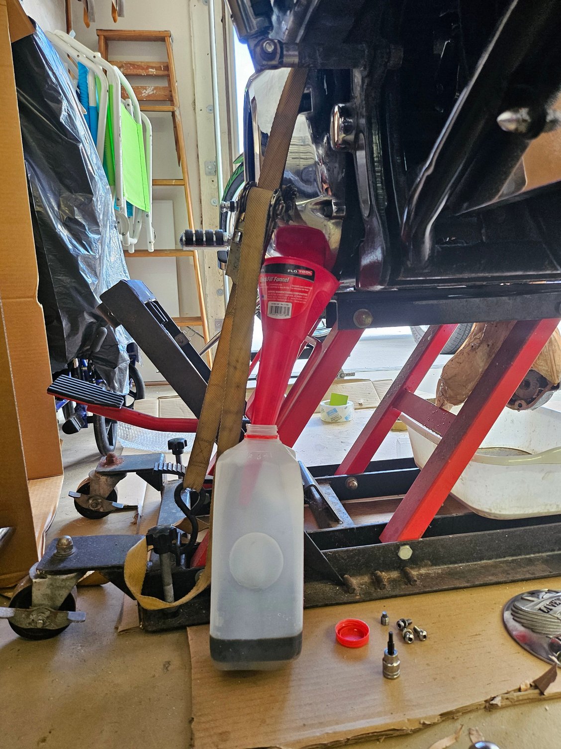

The well keeps giving water. The transmission was almost completely water, with just a bit of oil floating on top.
The primary was better, but still not a lot of oil in there.
I will let it drain for a day or so, then pull the outer cover and start disassembly.
I've resigned myself to this being a major teardown and rebuild that I won't finish this season. On a positive note, I will have touched every part of the bike, so I will know what I am riding.
