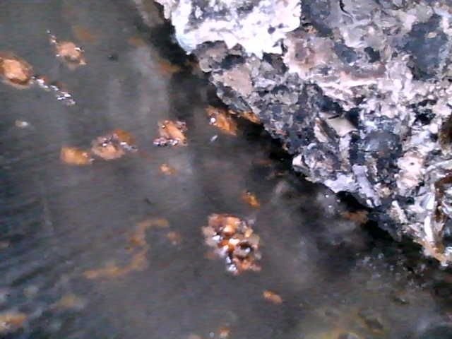

Well I rolled the dice, and they came up snake-eyes
Front Piston
Rear Piston
Only the rear intake valve is open, I can spin the other three pushrods.
I haven't removed the cam cover yet, going to remove the heads to relieve pressure on the cam.
If the lower end is filled with oil and water, I'm considering a complete motor, maybe something bigger. If it's clean, a top end job will get me on the road.
More to come!
Front Piston
Rear Piston
More to come!
Yep the motor needs rebuilt. I have my doubts about the tranny too, you’ll need to pull the oil tank and transmission top cover. I would defiantly soak soak soak the inside of the frame with penetrating oil. I’d keep it soaked a good weak and let it run out of every crack nook or opening. It’s worth it though. Great bike.

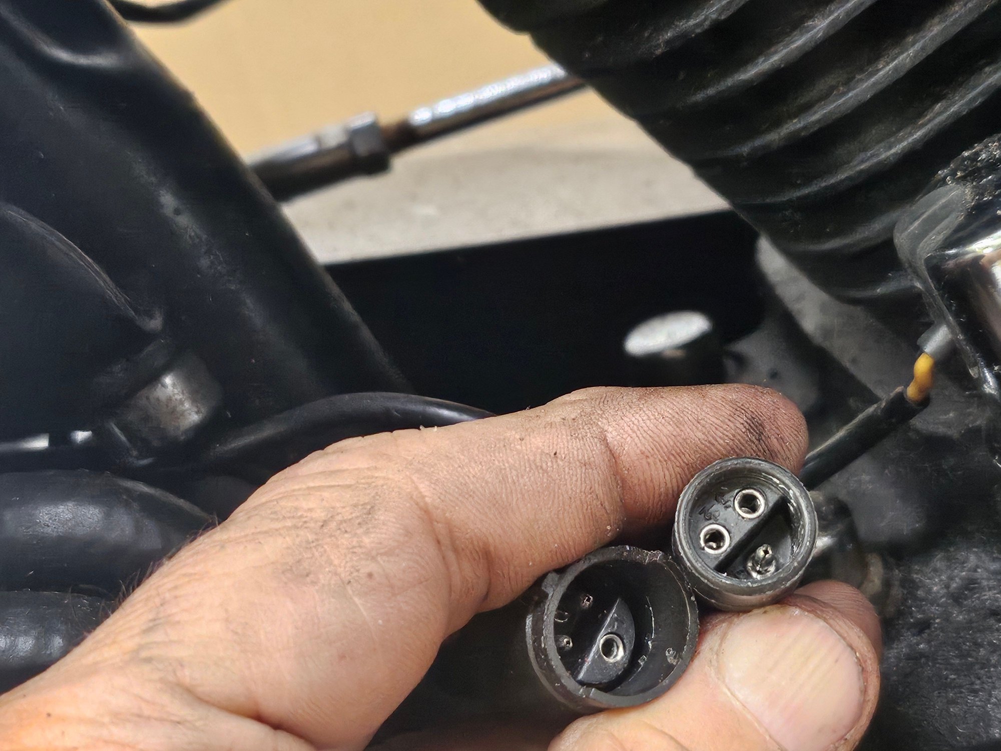

I was encouraged that the ignition trigger connector was clean as a whistle:

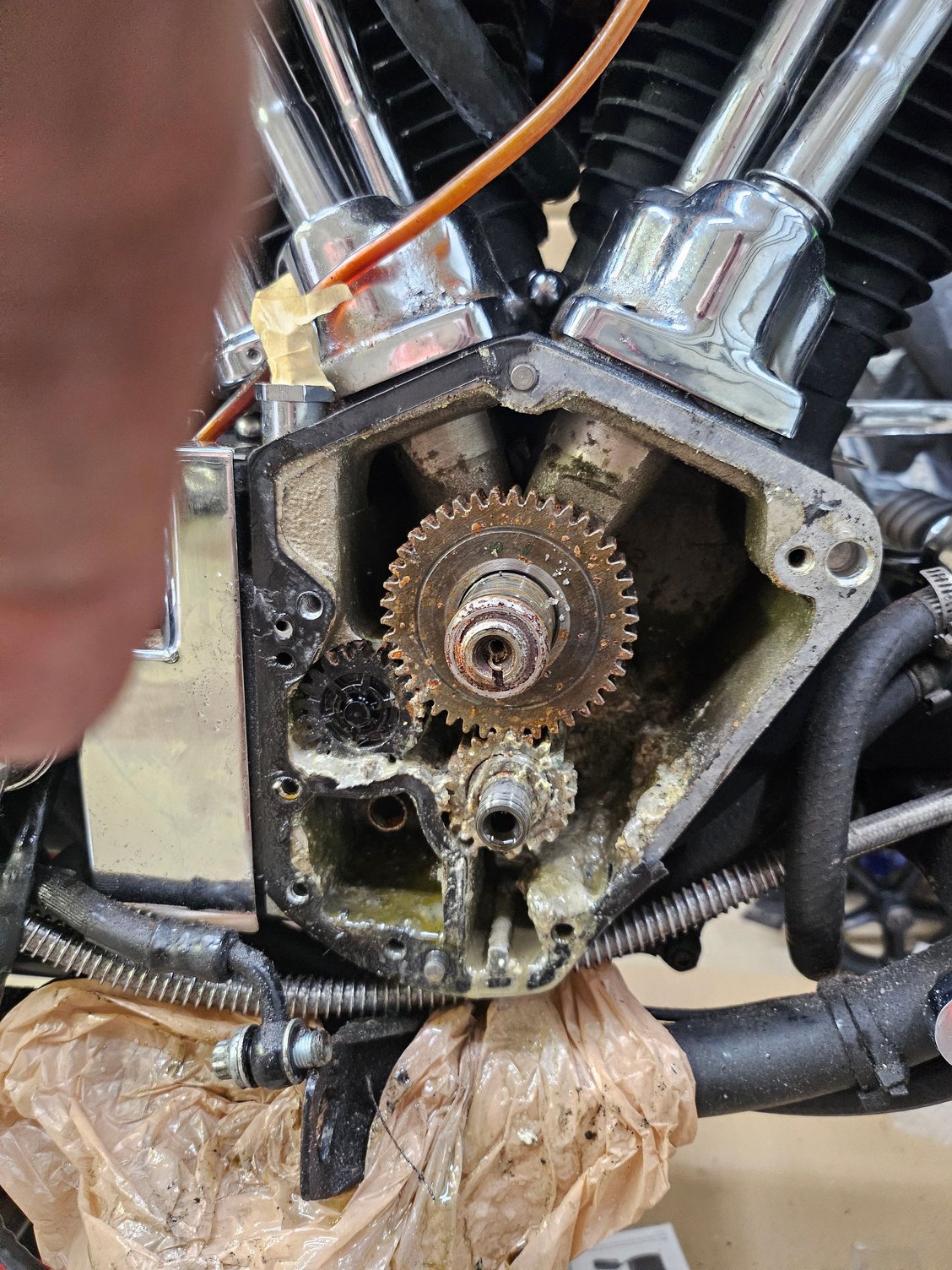

I removed the rear rocker box to relieve pressure, and the pushrods were cruddy where they went into the lifters, so not good. When I loosened the cam cover, this is what came out. I tasted it and it has a salty aftertaste.
Water definitely got into the lower end at least up to the pinion, so I'm thinking the crank bearings are shot. Strike two!

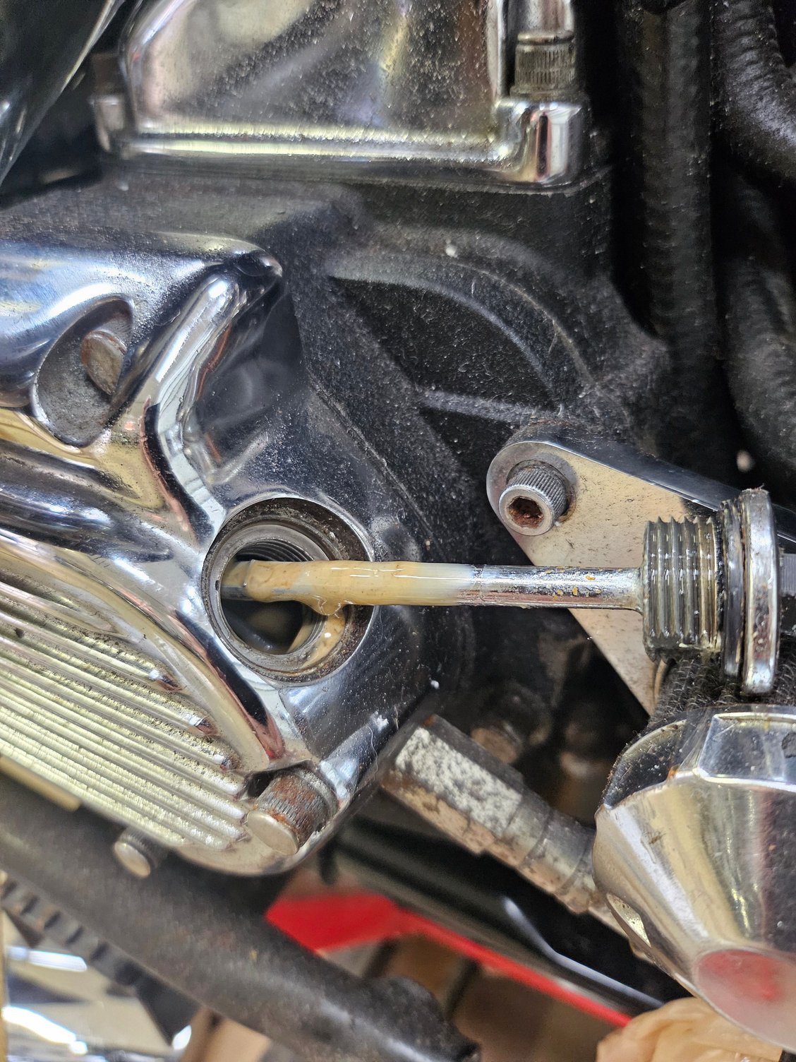

On to the transmission. I didn't even have to drain it. Strike three! I'm out!
A local shop owner advised me not to throw any more money into it. He said I will be chasing problems forever. Since he thinks in shop hours, I'm sure that's good advise if I was going to flip the bike. But since I'm retired, and working on bikes is cheaper than drinking and women, I'm going to keep it.

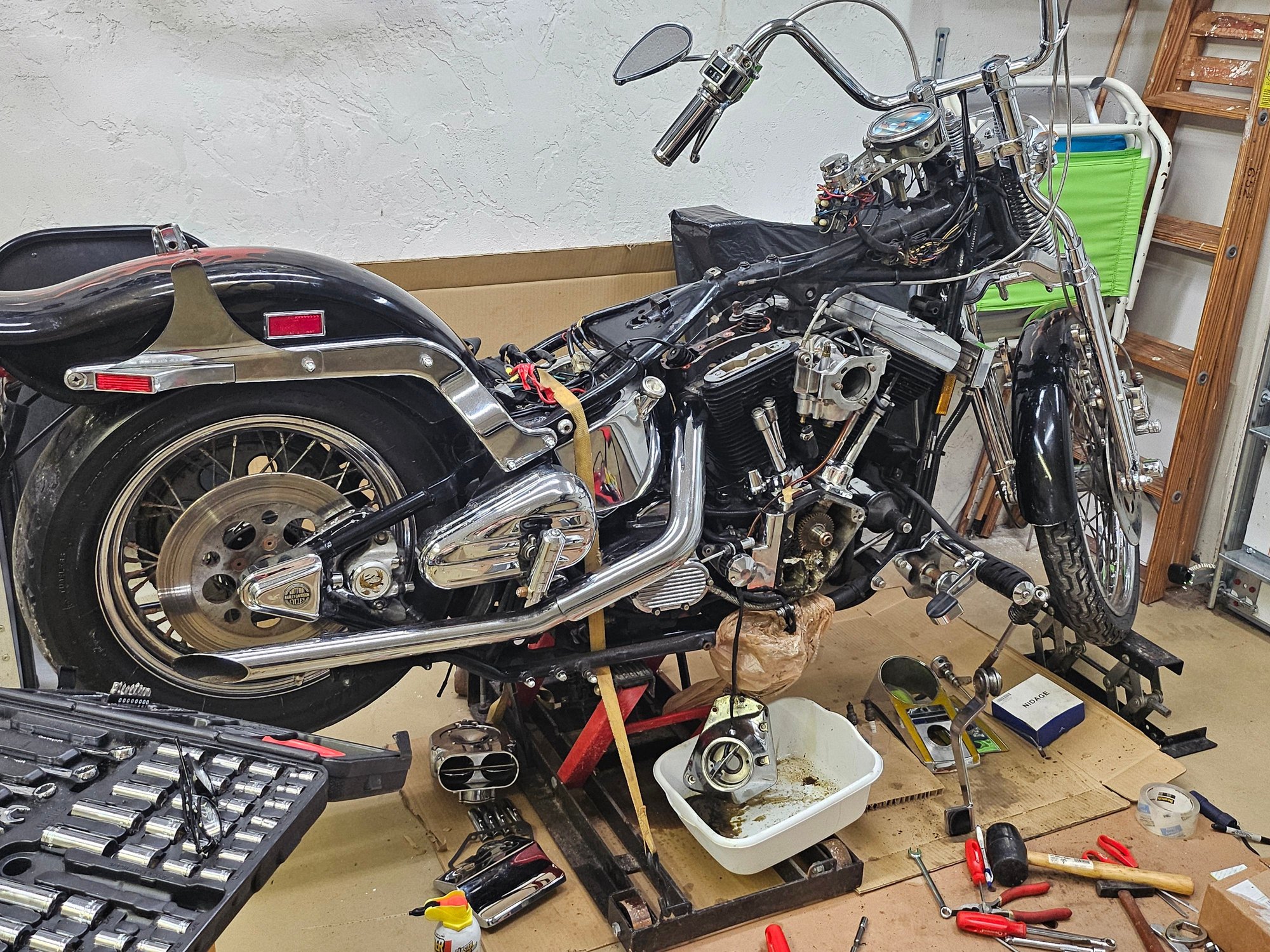

Here's where I am now. It's a cool looking bike, and I am drawn to it.
