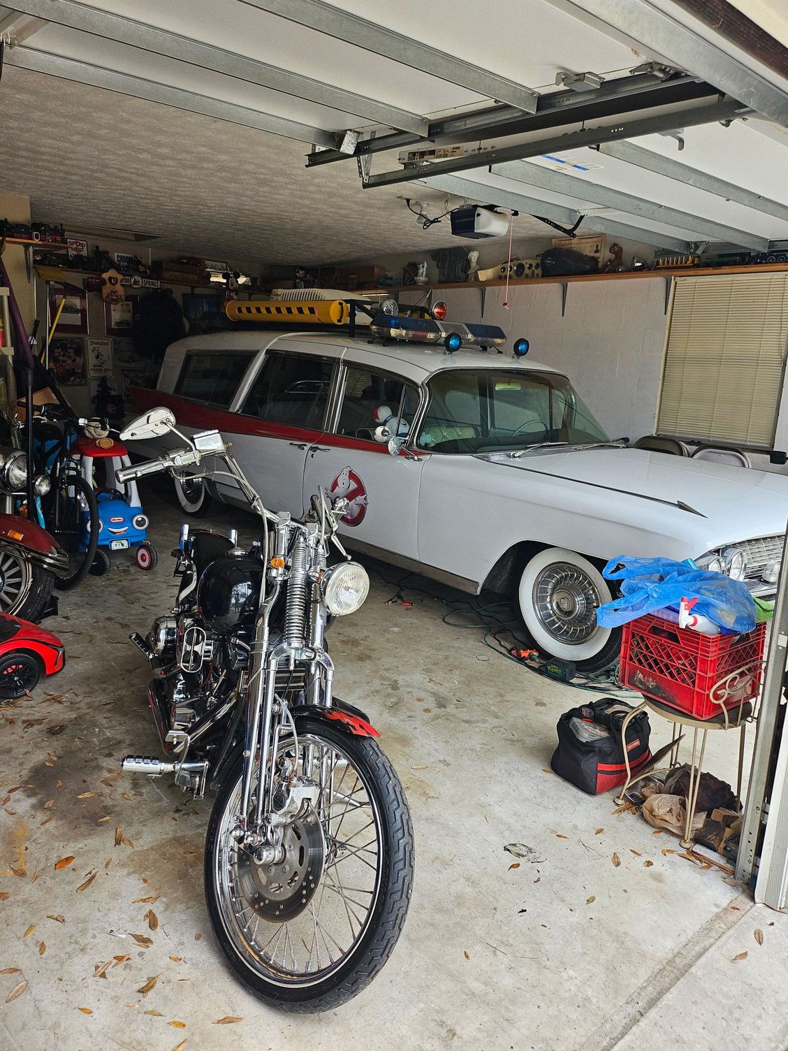

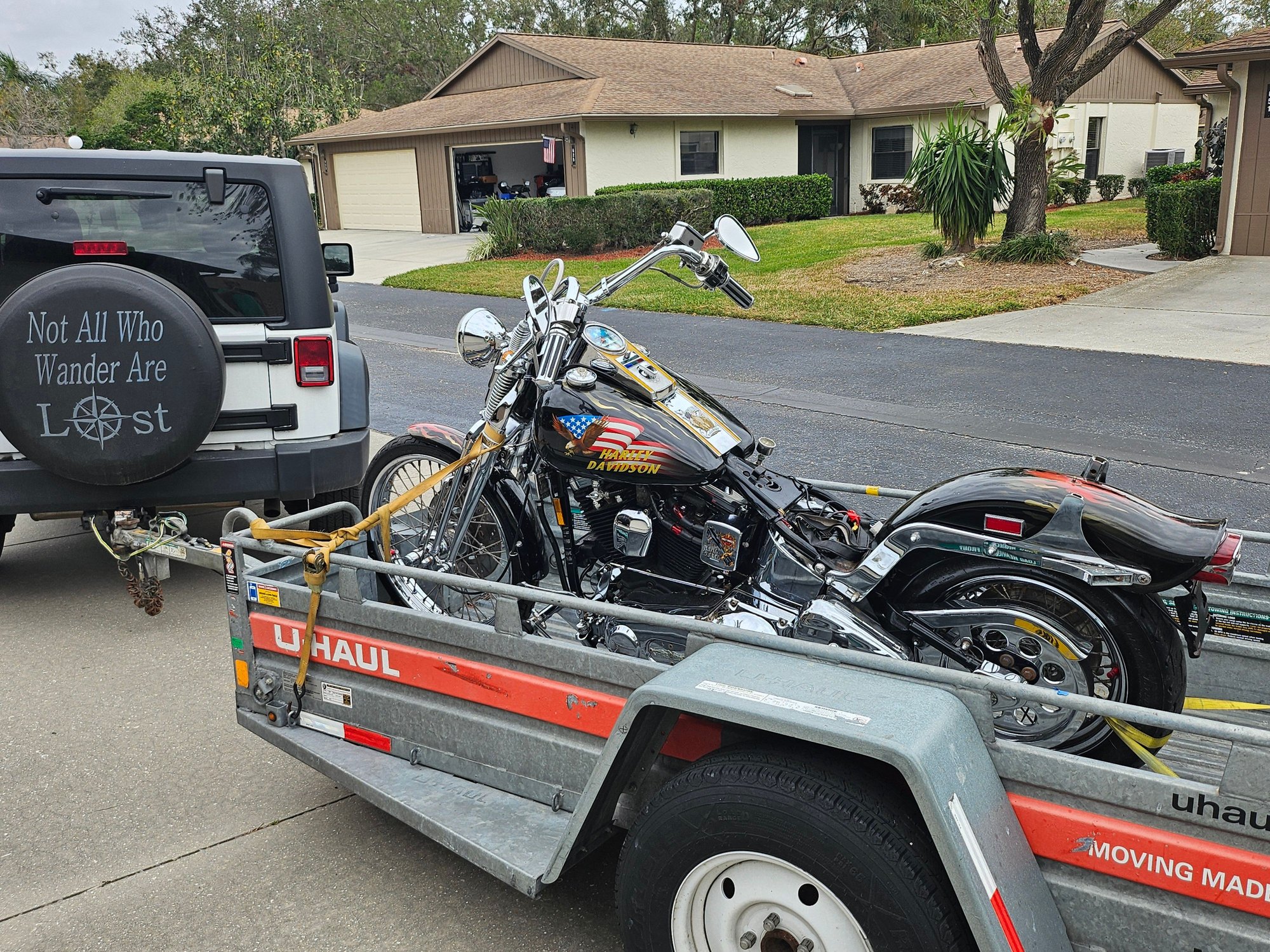

I arrived in Florida last night about 8:30, and picked up the bike today. I will go over it another day, this is enough in one day for a retired guy. LOL
The guy and his wife are pretty cool people. They have a lot of old cars and bikes. My bike is too new for them, lol. The Harley and Triumph behind it are 72-73 vintage. He also has a thing for oddities:
He's on the lookout for a Batmobile, but I didn't get into what version. In my eyes there's only one.

Looking good! It really does look clean. Again.. I’d pull the nose cone and primary cover, if they have no sign, still oil the way it should be, you’re probably in good shape.
