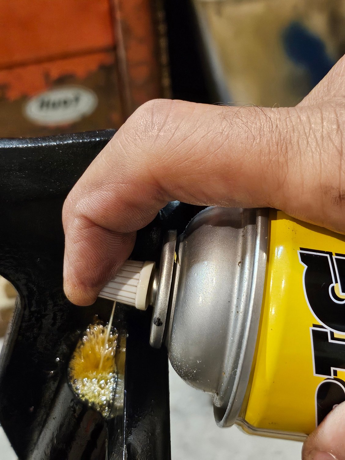

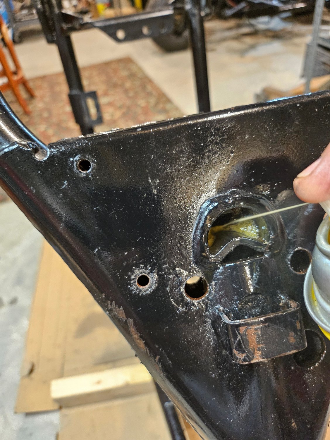

Here's an update finally. I needed to rustproof the frame this summer, so it's ready for assembly when I go back to Florida. Best way to preserve the inside of the frame tubes is fill them with PB Blaster and let soak for a few months. It's been on my to-do list since May, but summer is busy. But three giant cans later, the job is almost done. I'll keep checking to make sure the level stays up.
The lower tubes and down tubes fill from the back with the neck down:

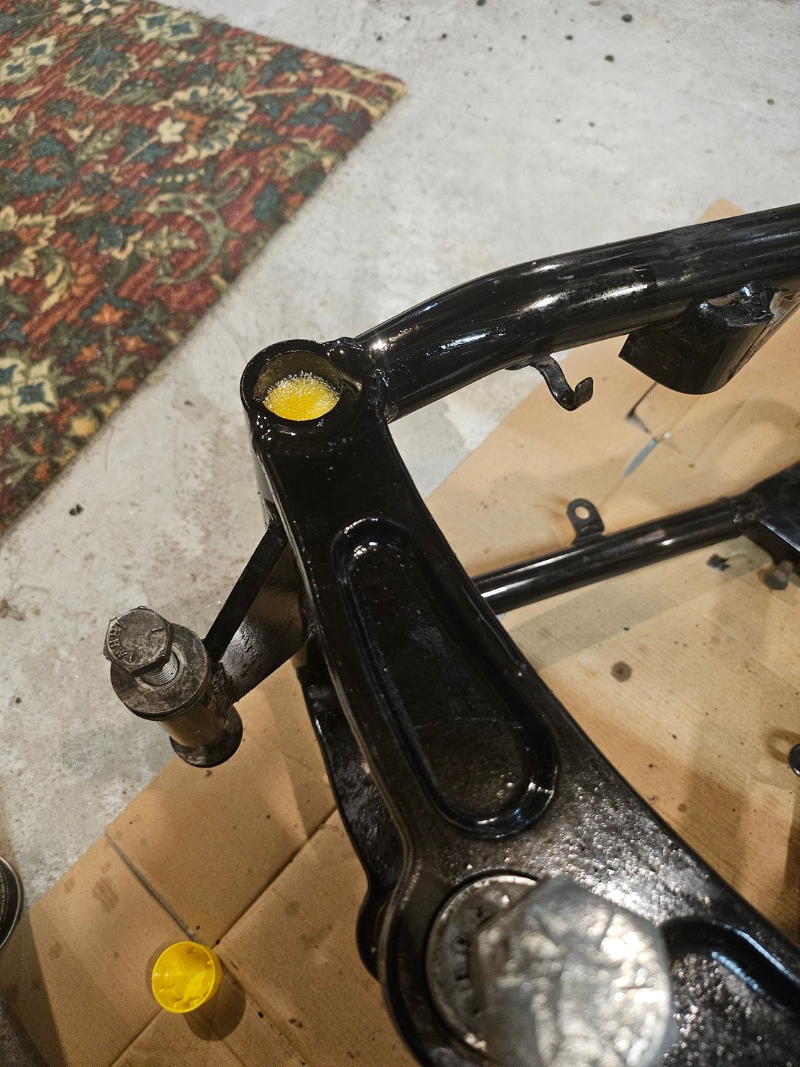

I put a #6 rubber stopper in the bottom of the seat tube. The top tube fills from the little triangle hole next to it. It connects to the speedometer cable tube, but I need to get another #6 stopper to fill this up all the way.

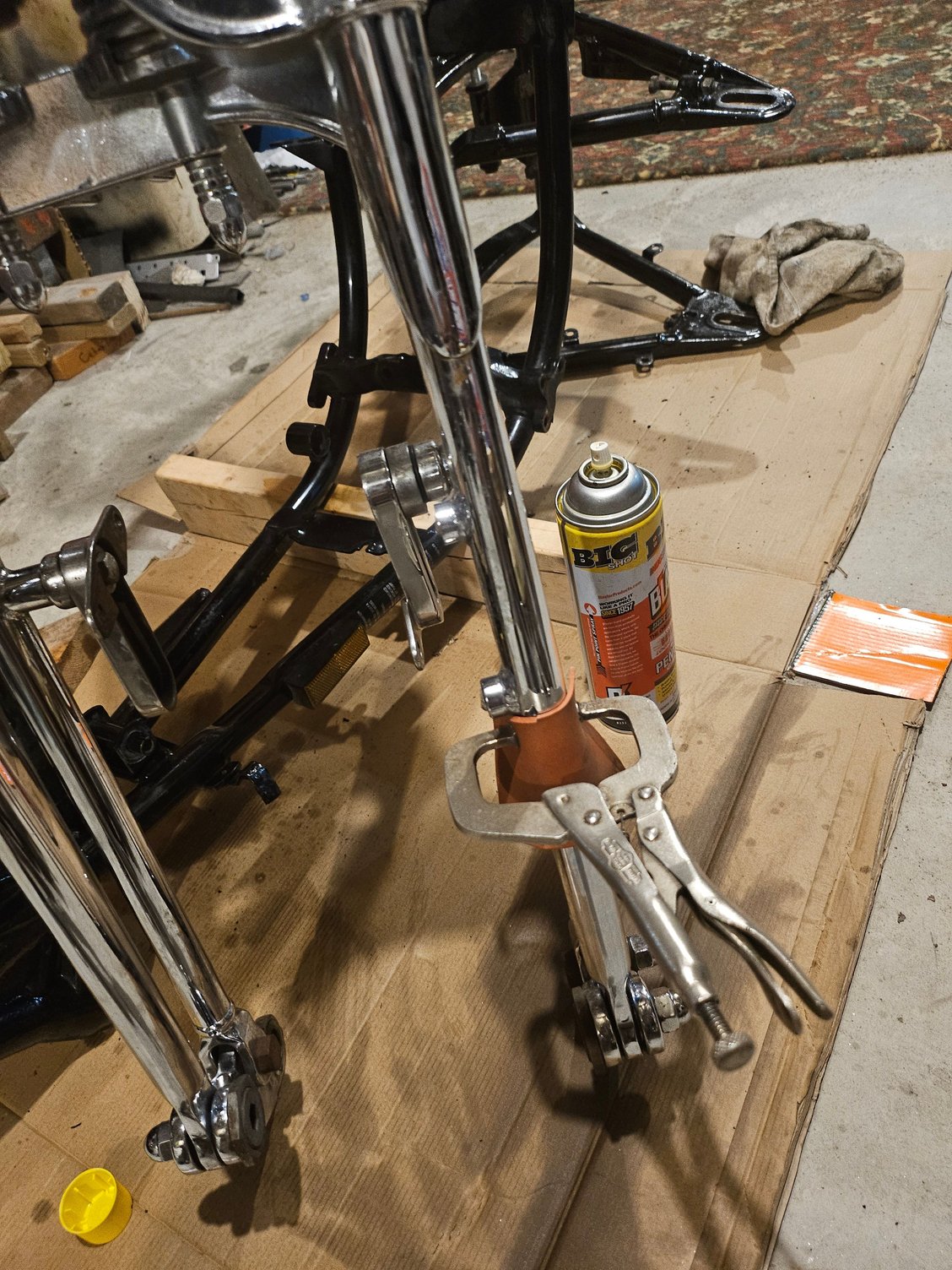

This is the only part of the swingarm that I can see is open to the world, and a #5 stopper fits the other end. If anyone knows if I should work at filling any other parts of the swingarm, I'm happy to learn:
Last but not least the rear springer tubes. I had to seal the holes the idiot drilled to bolt up the brake stay when the stud broke. I don't see any openings in the front tubes, but again I could be wrong.
